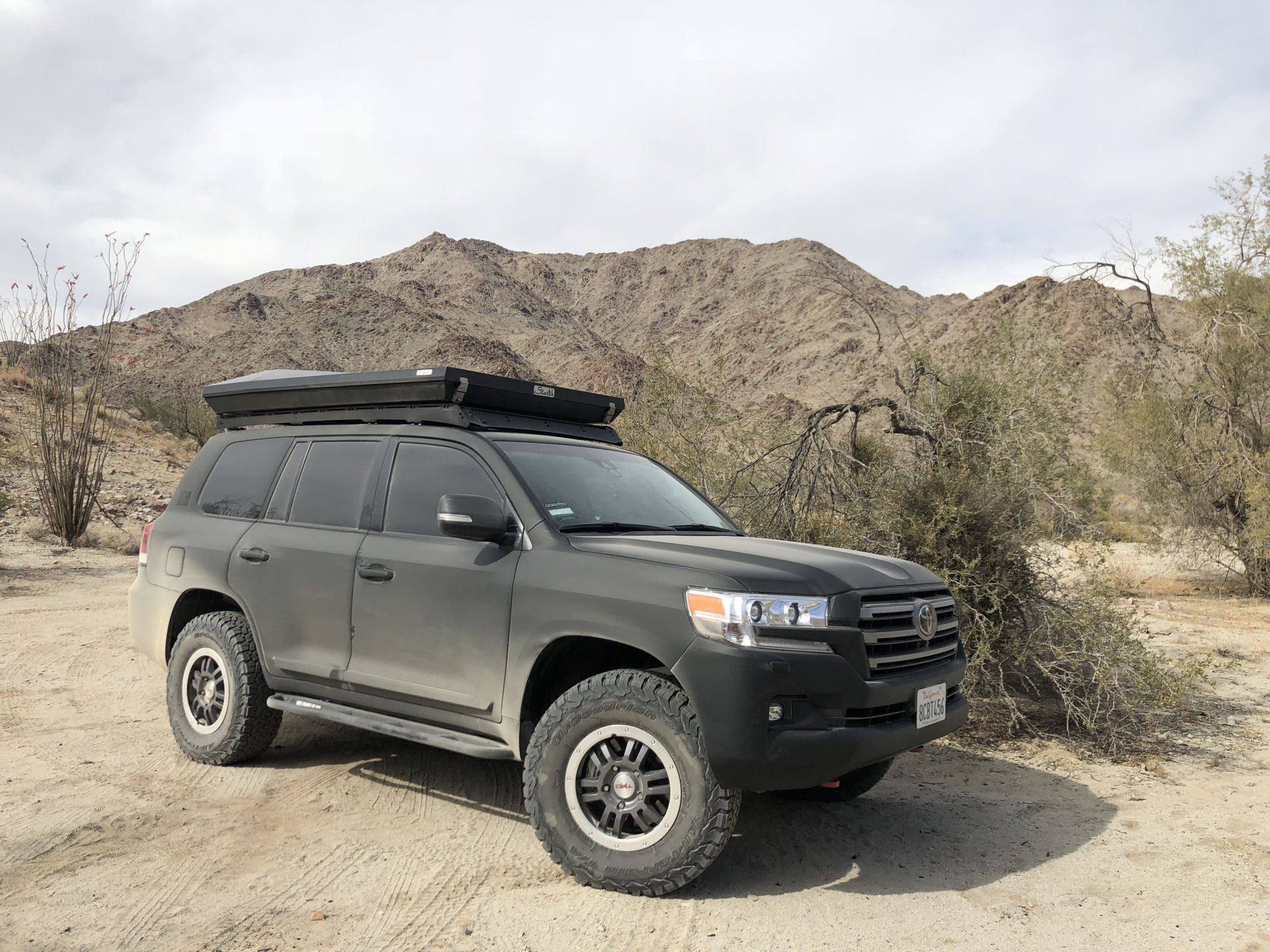

So finally got the LC on dirt. A few preliminary thoughts:
The Icons did great. I’ll need to spend some time messing with the clickers to find a balance of eating up the small stuff but also handling the bigger hits.
The Tundra CV’s spit up grease even when they’re on an LC. It happened to my Tundra once I went long travel and that trend is continuing on the LC. I’ll keep an eye on it.
The LC does great on technical sections even with the ridiculously heavy RTT on top. Although the off camber stuff had me nervous.
I need to figure out what’s best for speed in sand. My rear end was kicking out more than I’m used to on curves at speed. Several times I lost traction and then lost steering. I was only going 40MPH or so. That is troubling. I tried opening the center diff and that seemed to help a little. Some of it probably has to do with the fact that I’m stupid top heavy. But I never felt like I should have lost traction. They were all curves I could have gassed it thru in my Tundra with no issues.

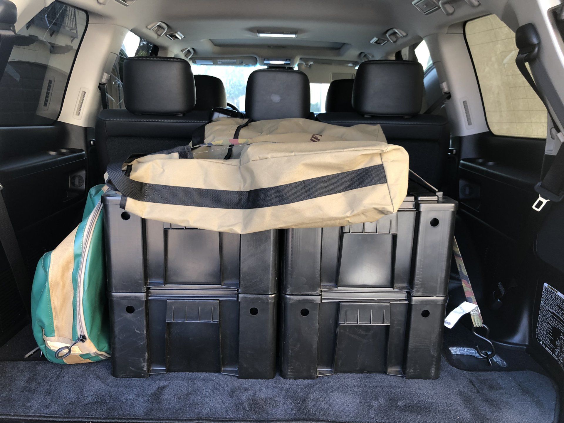

Wheeling with an SUV is gonna make me figure out how to pack my truck with noise in mind. Hearing all your gear jump in your boxes when you take hard hits makes you slow down.
My wrap is not pretty anymore. Hahaha.
