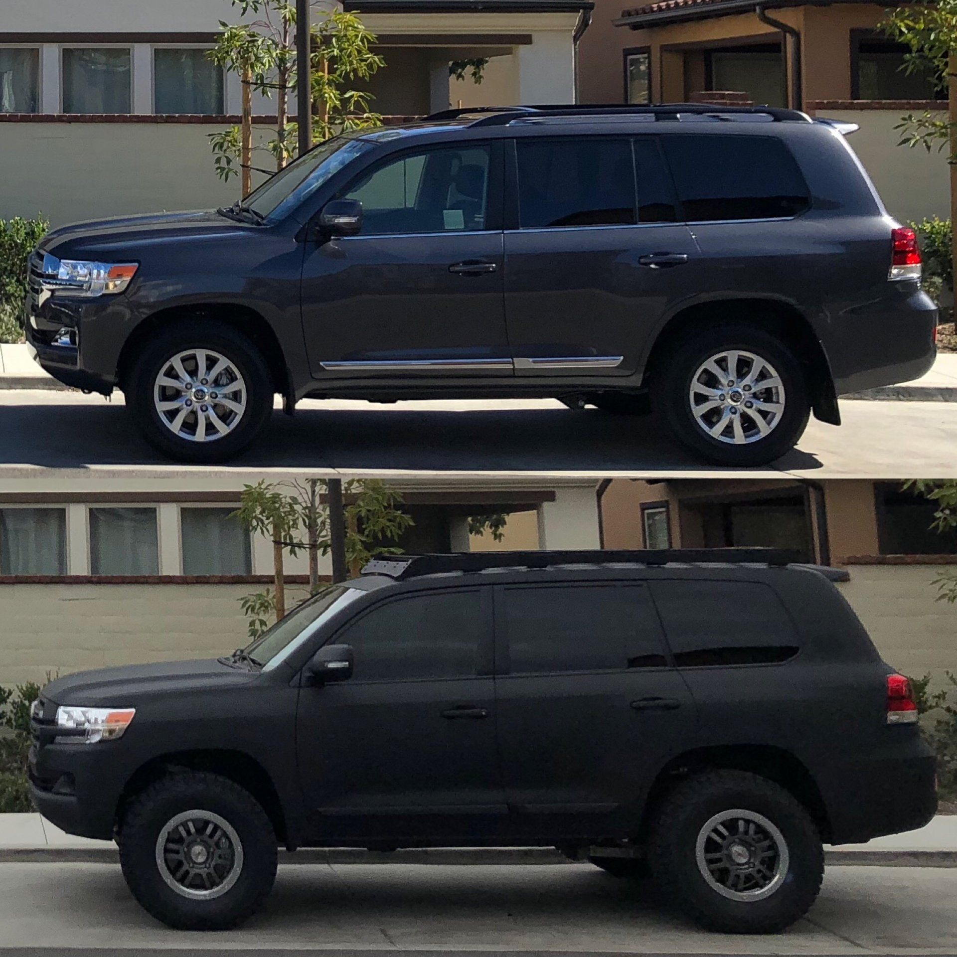

Looking amazing. What are your first impressions of the icons?
Its hard to say until I get them in dirt. My guess is I will want them revalved. I’m basing this on the fact that when I open the clickers all the way soft, the truck is too billobilly. I like them at 3-4 for on road driving. This concerns me that off road, they’ll be too soft. But I’ve never had digressive shocks. I have Kings on my Tundra and I’m used to much stiffer on road feel because I have my compression tuned pretty aggressively on my bypasses. But if they perform well off road, I’ll be sold on digressive Shocks.
Putting them to 1 on road is not great, but putting them on 1 off-road is amazing. 4 is also what I put mine on when on-road, and 1 when I'm off-road. At least on my 100.
I really need to man up and get a set for the 200.
Interesting. So you run them with less compression off road? I’m still learning what this truck will like. i won’t be doing whoops at speed with this thing so I guess the shock tuning will be different. Only one way to find out.
Try it loaded up with gear/gas/passengers. You might find a different animal altogether.
Do you plan on adding bumpers, winch, etc? If so, it will make a massive difference.
Yeah. I’m not gonna really think about changing the valving until this summer. I’m in the queue for a TT front and rear bumper set up and a TrekBoxx drawer system. I have a Stealth RTT coming this week, so that’s more weight. It seems no matter what truck I get, it becomes a fat piggie. Hahaha.
