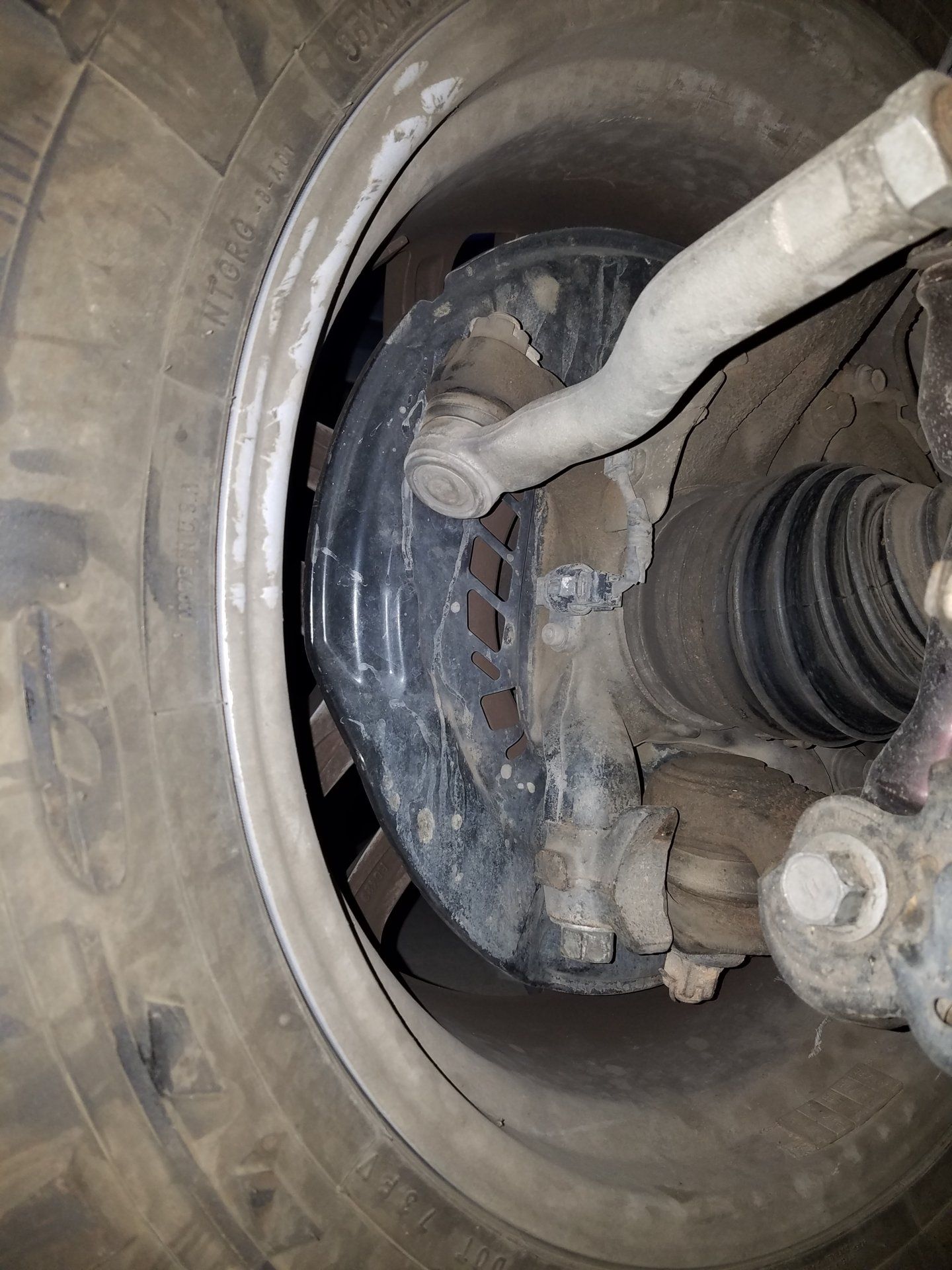

Also, quick question: my tie rod ends are making contact with the inside lip of my RW’s. I’m guessing I need to push my wheels forward more. Just wanted to see if anyone experienced this.

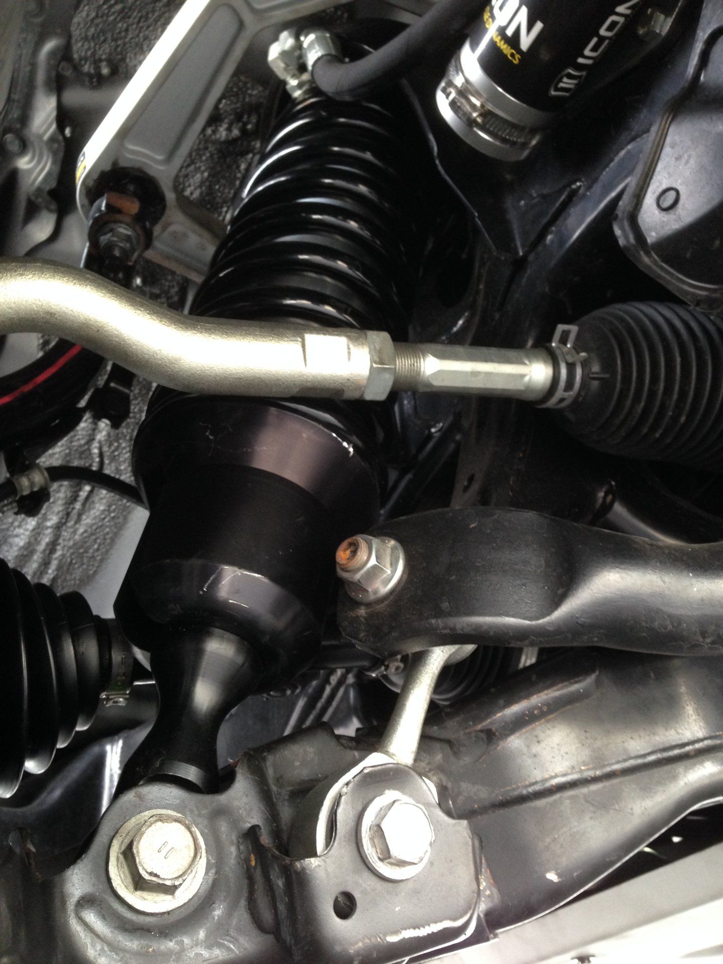

If you get a chance snap a pic of the tie rods. Hard to imagine them making contact. Here's a pic for comparison. Iv got the tundra brakes which I believe are similar in size to the 2016 and up cruiser
The tie rod is within the diameter of the brake backing plate. Curious if yours is different.

It fine going straight but at full turn, it touches the lip of the wheel. So for that same wheel, if you clocked the steering wheel to the left, the tie rod end would contact the wheel.

Look at the tie rod bend in your pic compared to mine. I would guess the tie rods are swapped. The bend needs to go back.
Glad it's an easy fix.
