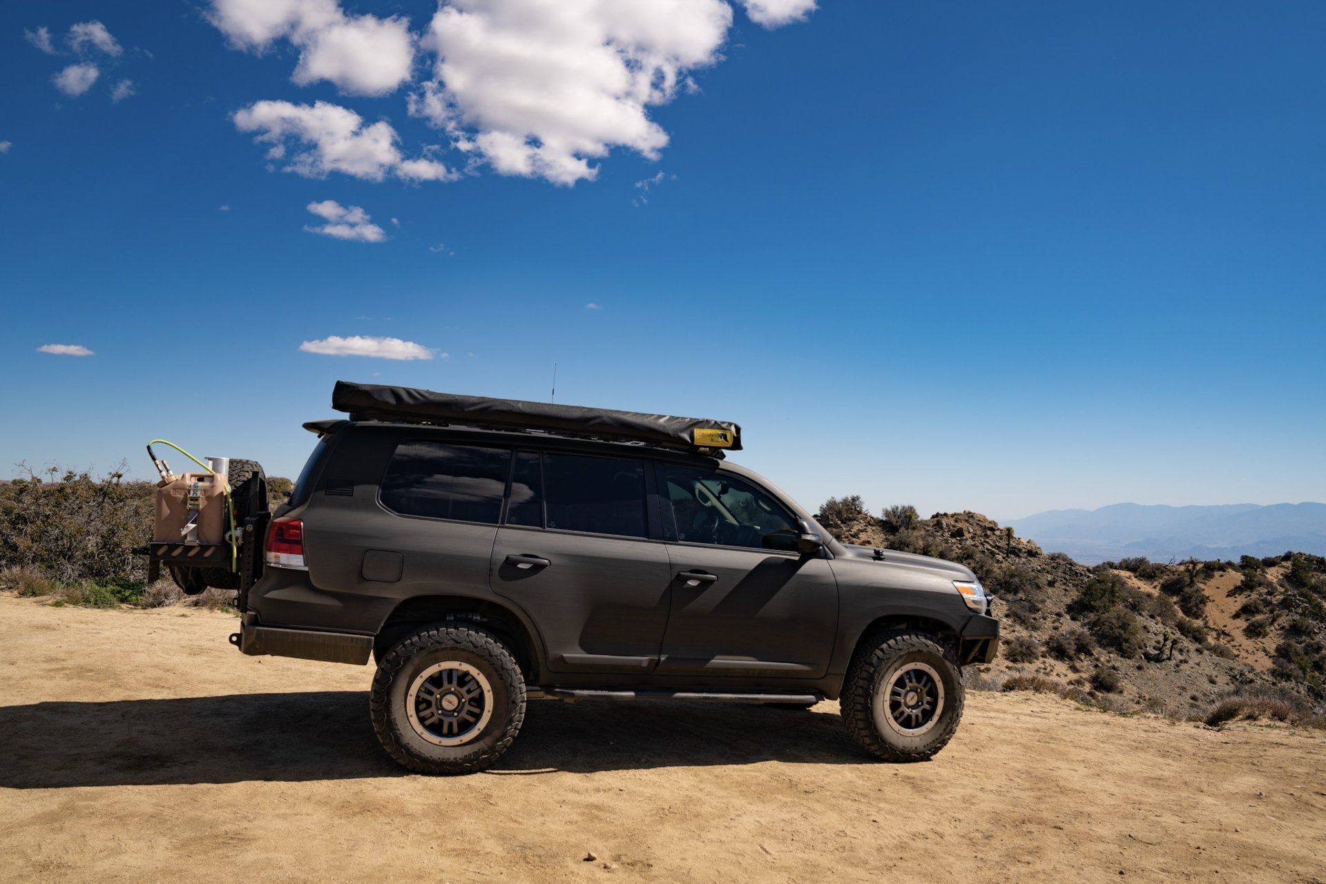

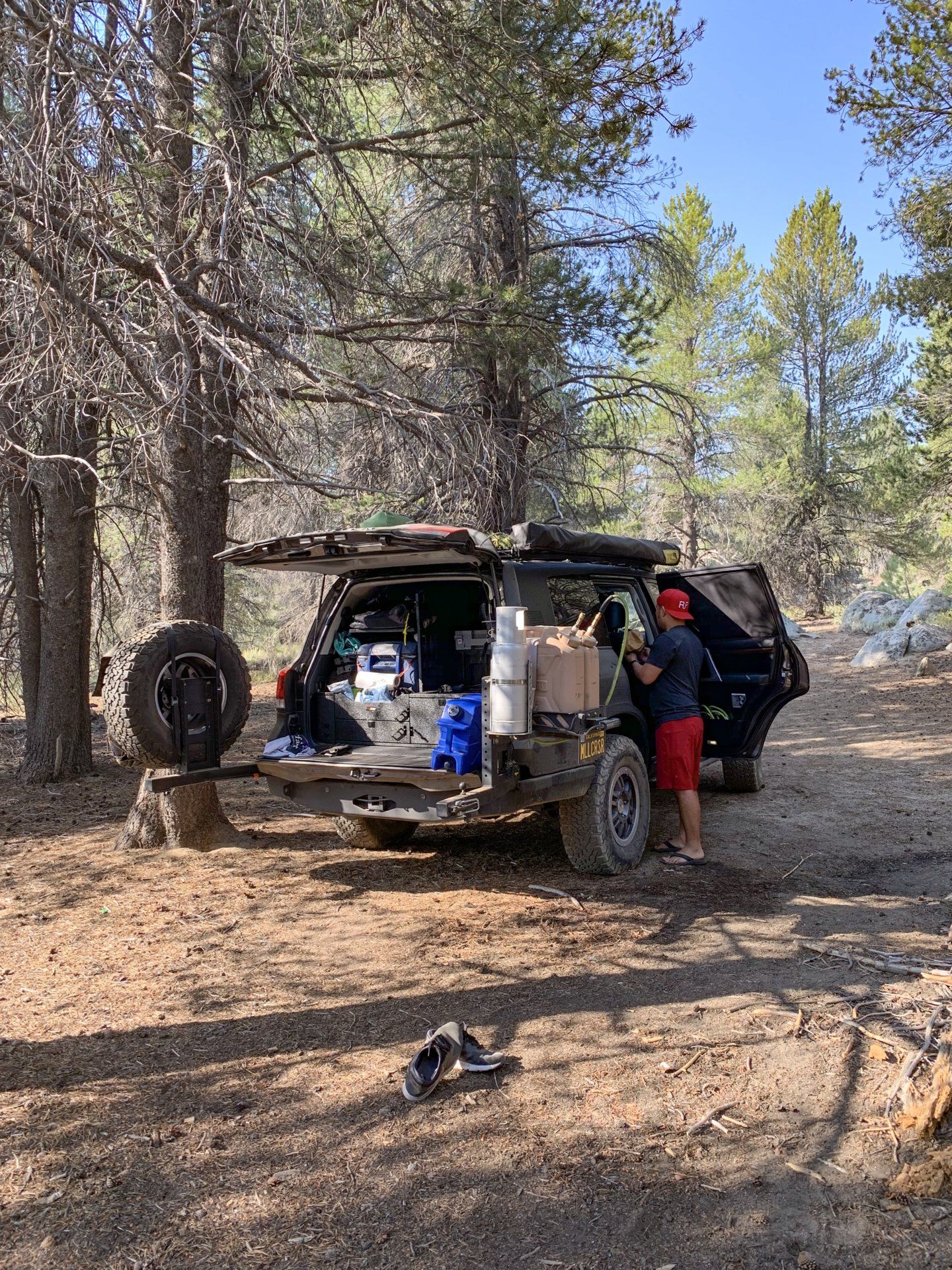

So since my RTT got destroyed, I’ve worked out a few options for sleeping. When I’m with the family, I’ll bring the Oz tent but for solo trips I’ll either bring a bedroll or a hammock depending on season.
Since I shed a good chunk of weight I felt comfortable tossing an awning up there.

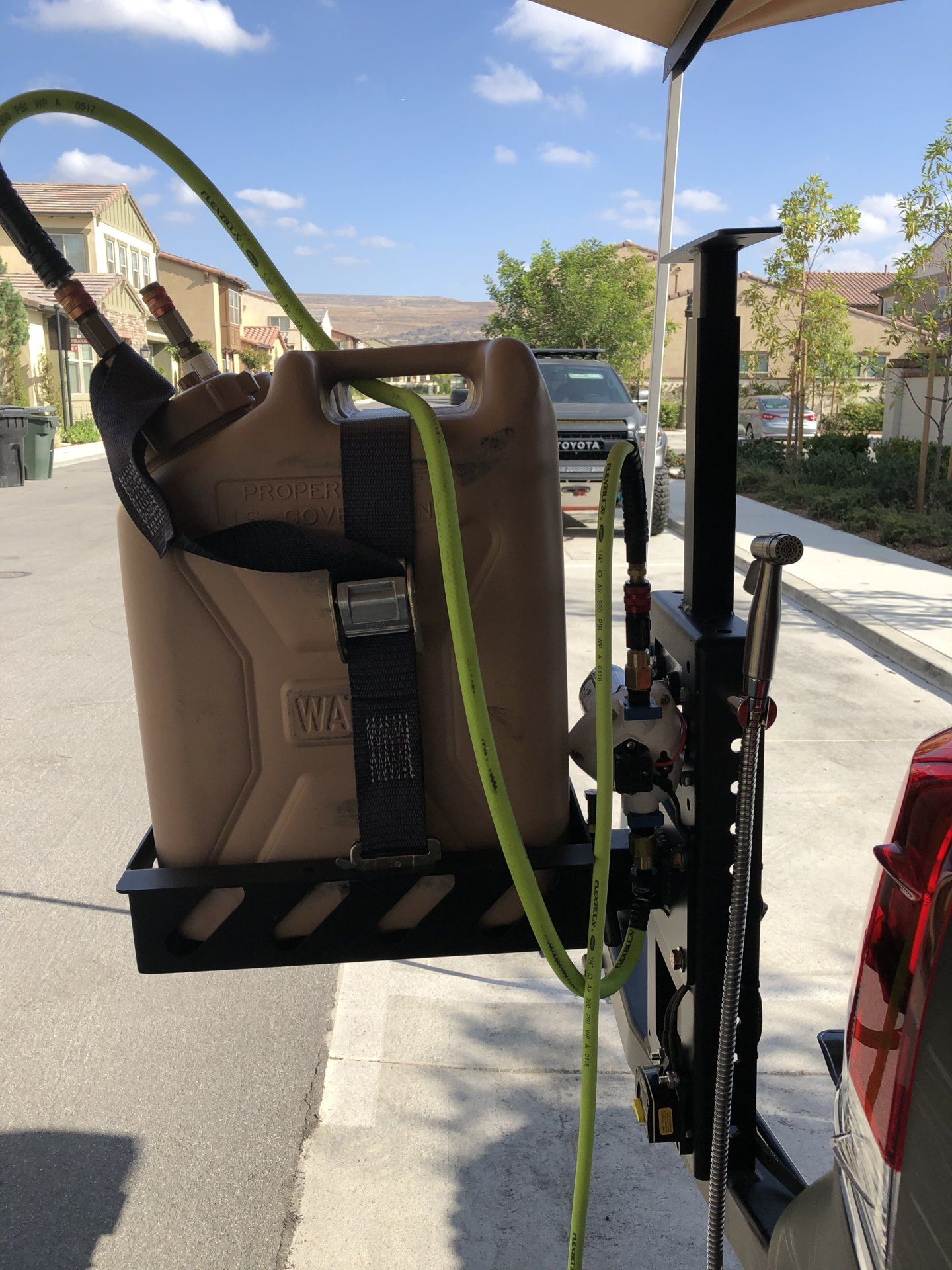

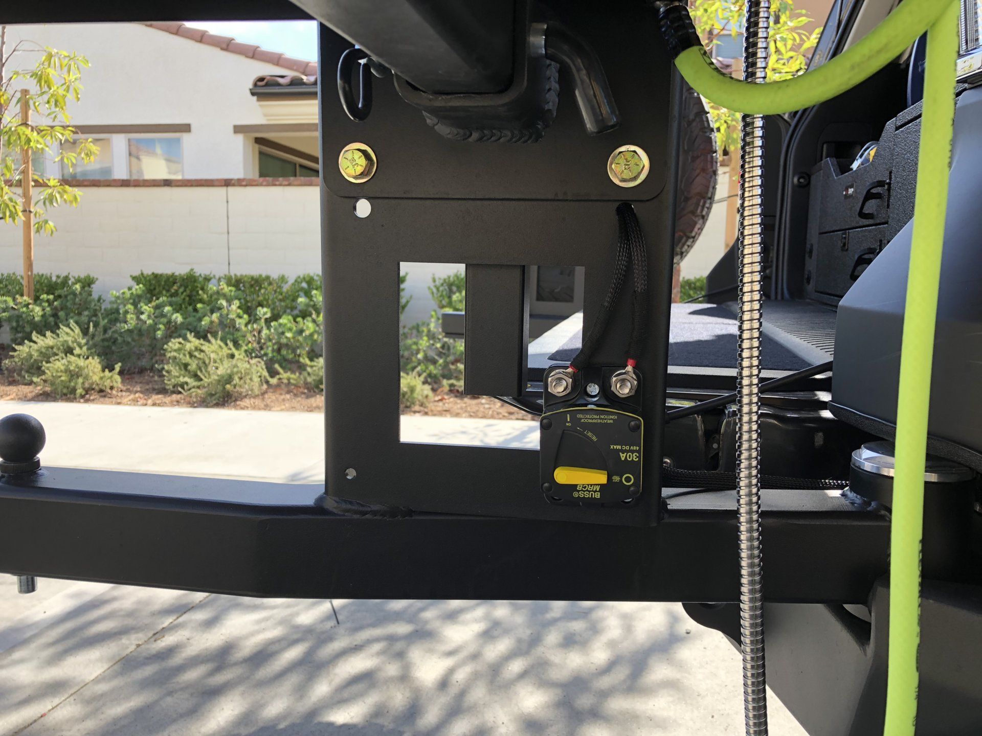

And I finally got around to hard wiring my OBW.
I didn’t pull the eccotemp heater out but it’ll just hang off the swing out arm.

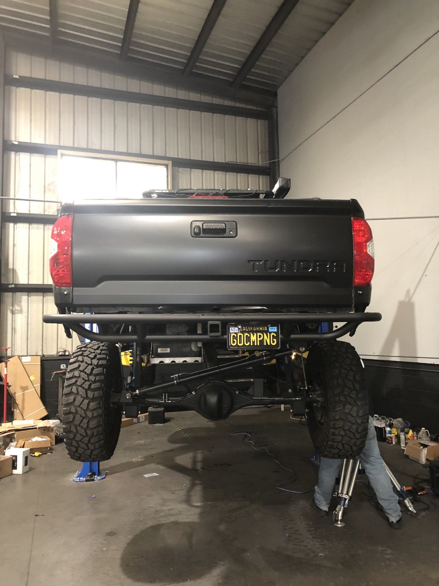

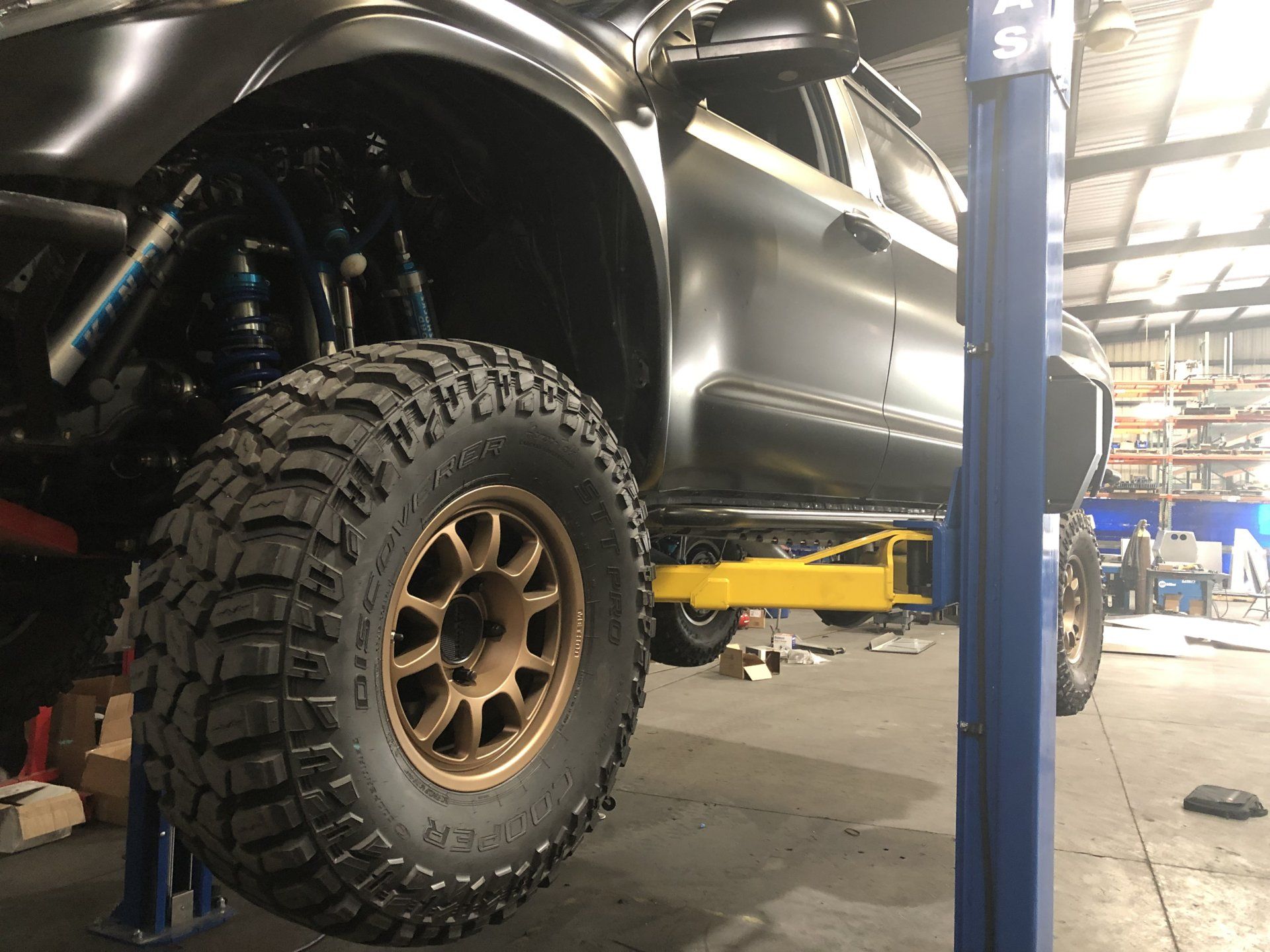

I haven’t tinkered with the LC in a minute. Pretty happy with how it is at this point. Got busy with work travels for a few months but hoping to get the family out soon. But I finally got my Tundra back from LSK. Gonna try to do a day trip to shake down the suspension and make sure it’s cycling properly.
Are those those wheels the 702s or the 313s?
