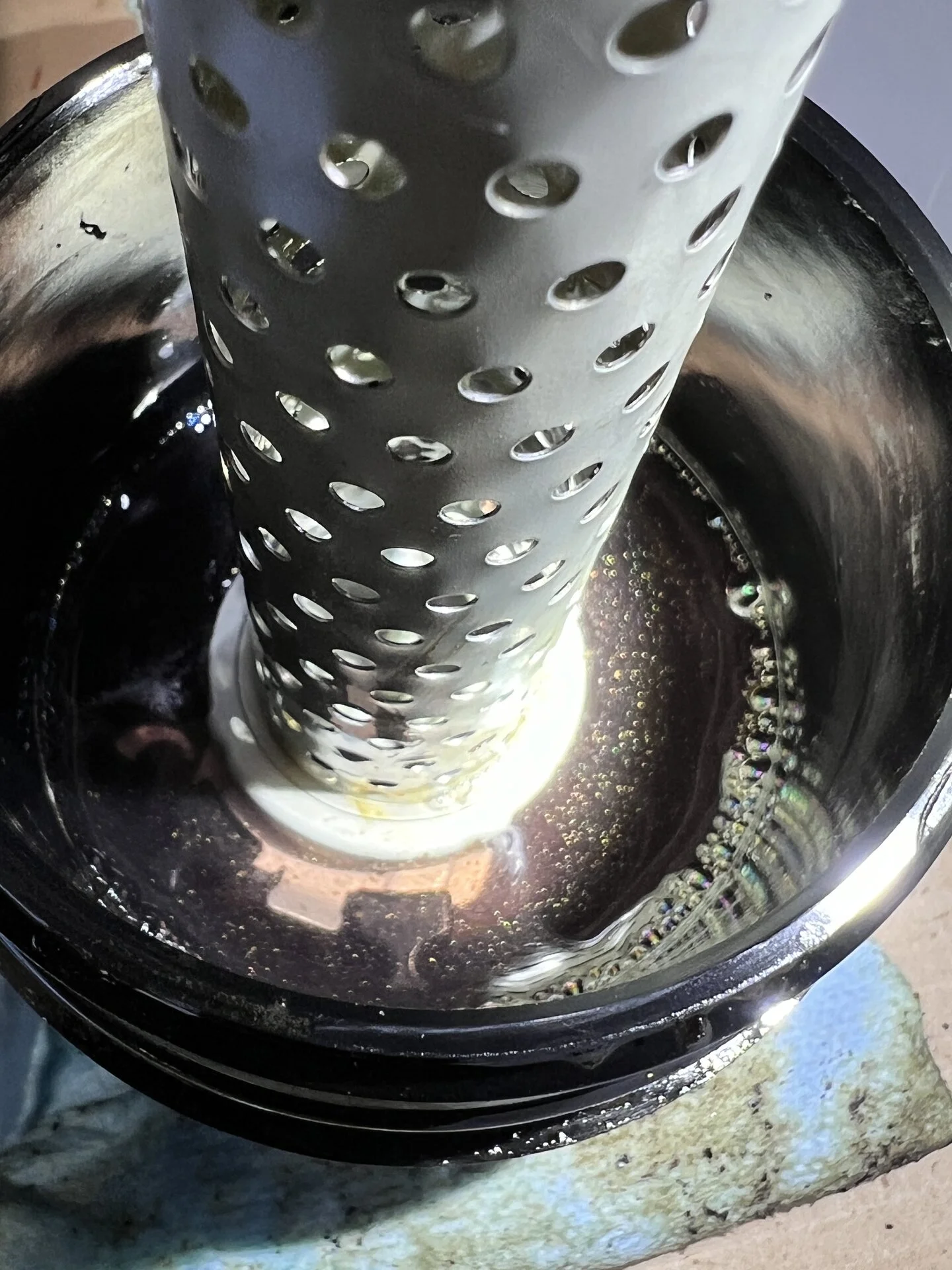

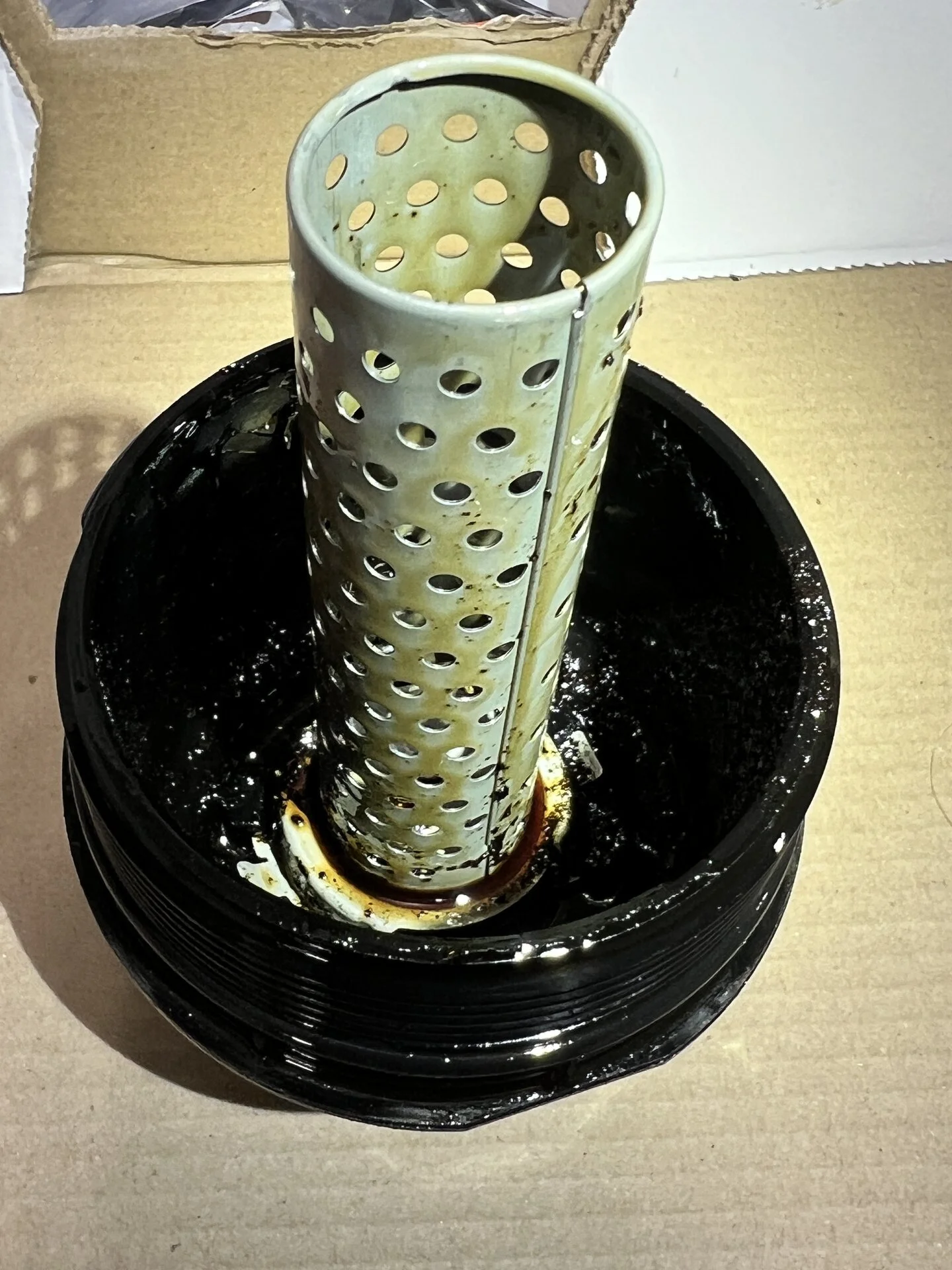

Oil change to 5w30. I spilled so much oil from it coming out with some speed that I’ll be sure and get the JB Rowlett one next time.
I could have got a lower mileage one, but it wouldn’t be any fun.
The wife is happy. I can deal with this.

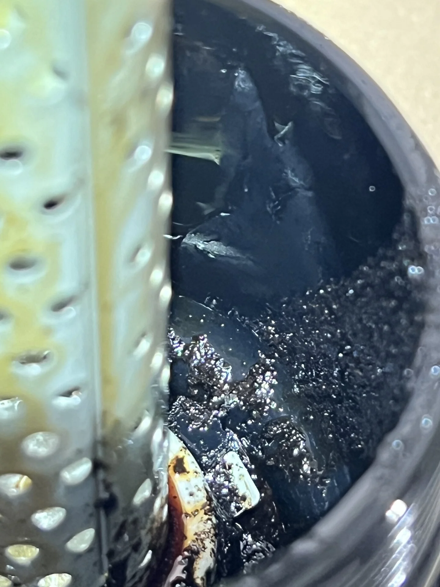

There appears to be a substantial amount of debris in that oil filter housing. Hopefully you got all that gunk out. I bet the dealer just left all that in there over the years to accumulate.
Three rinses with de greaser and it was like new.
I couldn’t let that stuff stay.

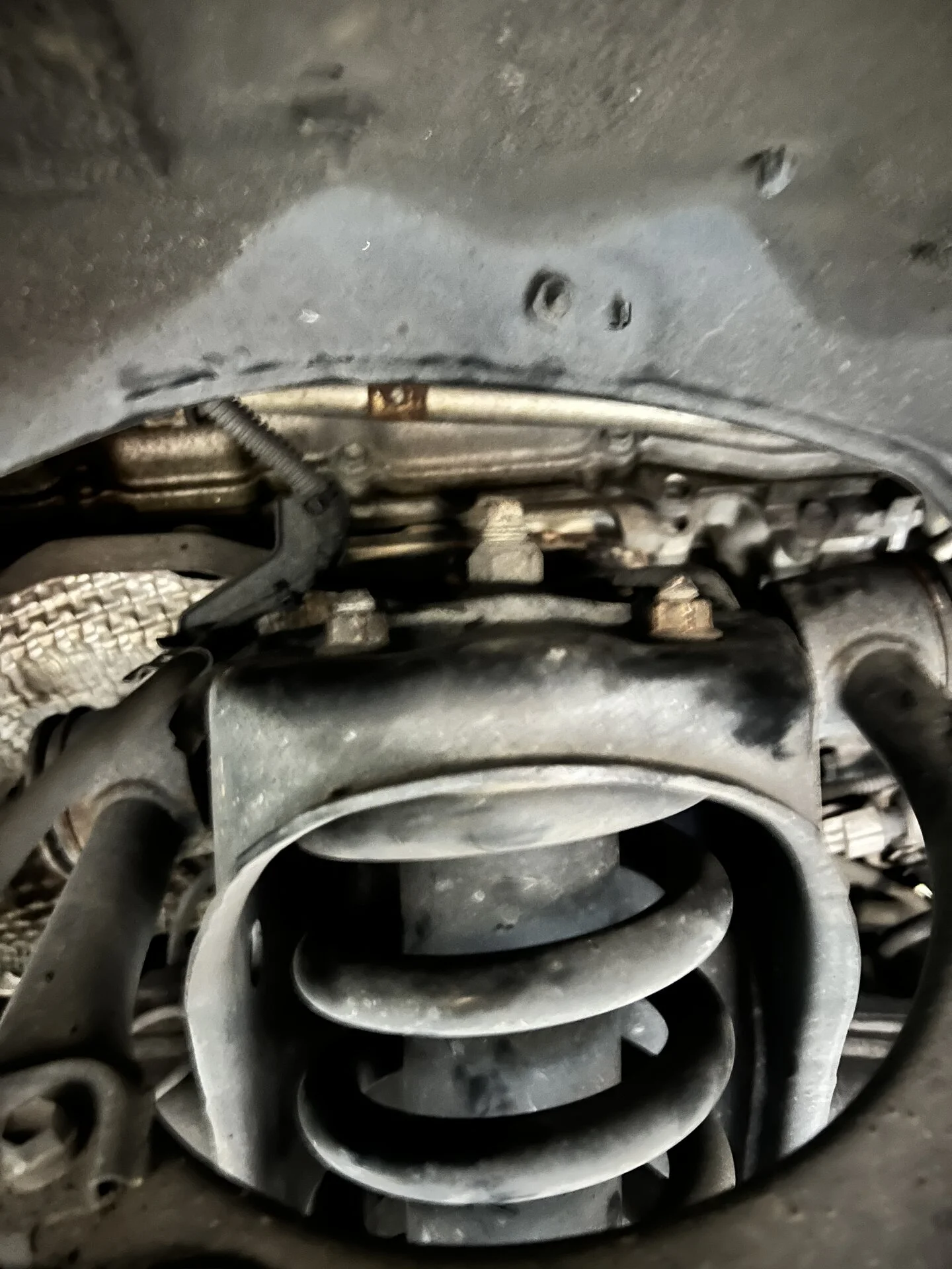

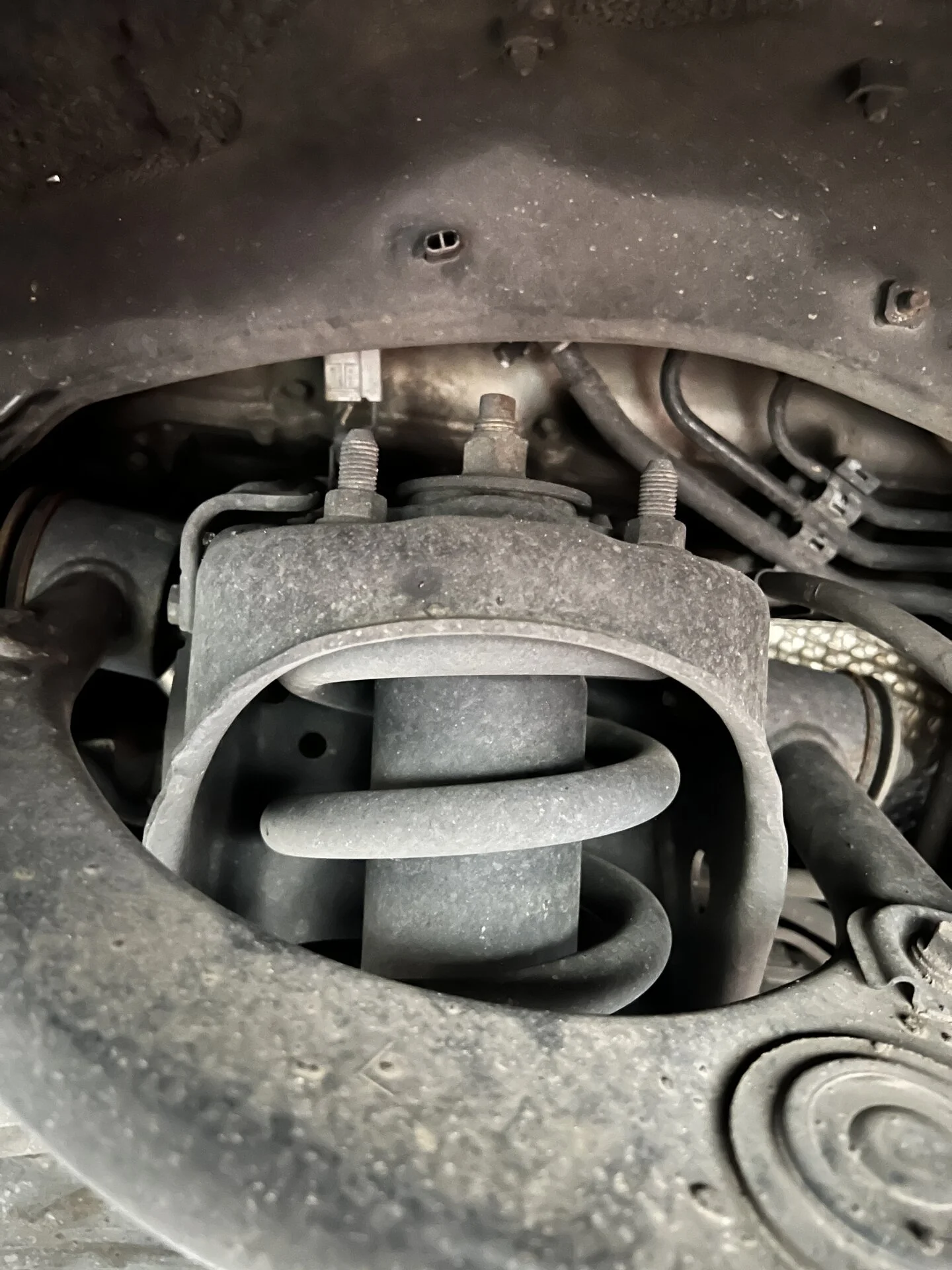

The KDSS screws were rusted. They just beat us up.
That’s all. More later.
Very lucky.
I would strongly suggest spraying it down weekly til you're ready. They use 5mm hex sockets, and in this instance they had never been moved. I should buy a powerball ticket tonight.
We broke off two 5mm hex bits inside the head, both came out with a magnet and did not strip the bolt. A lot of heat and constant pressure on the bolt with slight bumps caused both bolts to come loose. Very nerve racking.

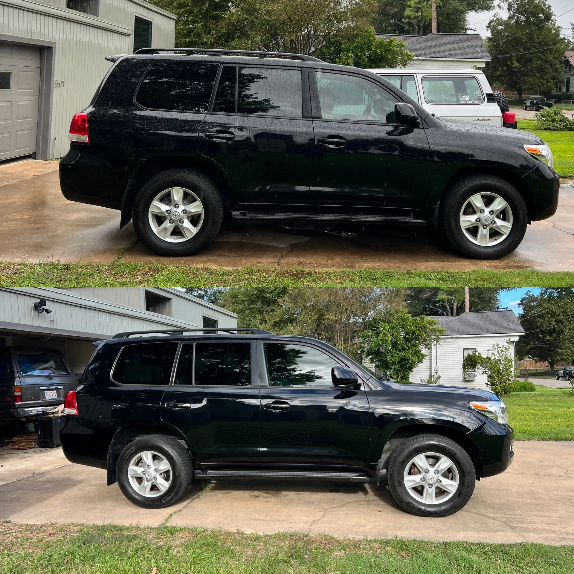

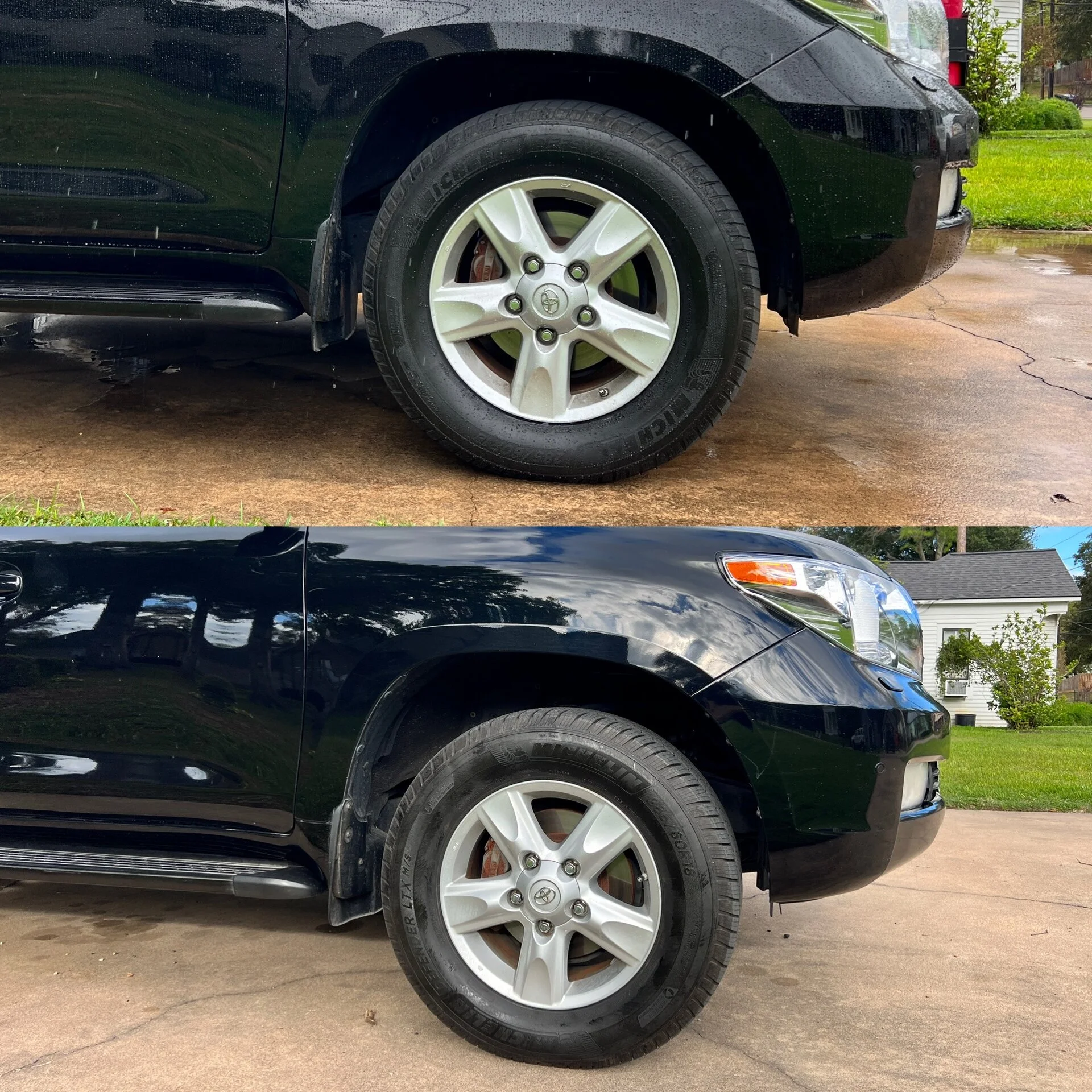

All I wanted was a subtle lift and I got it. I’m happy.
I found out in the process that my pull to the right was caused by an alignment issue from the PO or mechanic in the past stripping out the drivers TRE assembly.
My steering wheel is crooked now, VCS light is on due to the steering angle sensor being turned at its home position and I have LH and RH TRE's plus, inner rack TRE's with a boot kit on the way. Lots of money, but if I want this to align right it has to be done.
My car is really perfect now. I don't need to do anything. But like you I ordered the OEM spacer as well. Blah hopefully I can tackle it without any issues.
