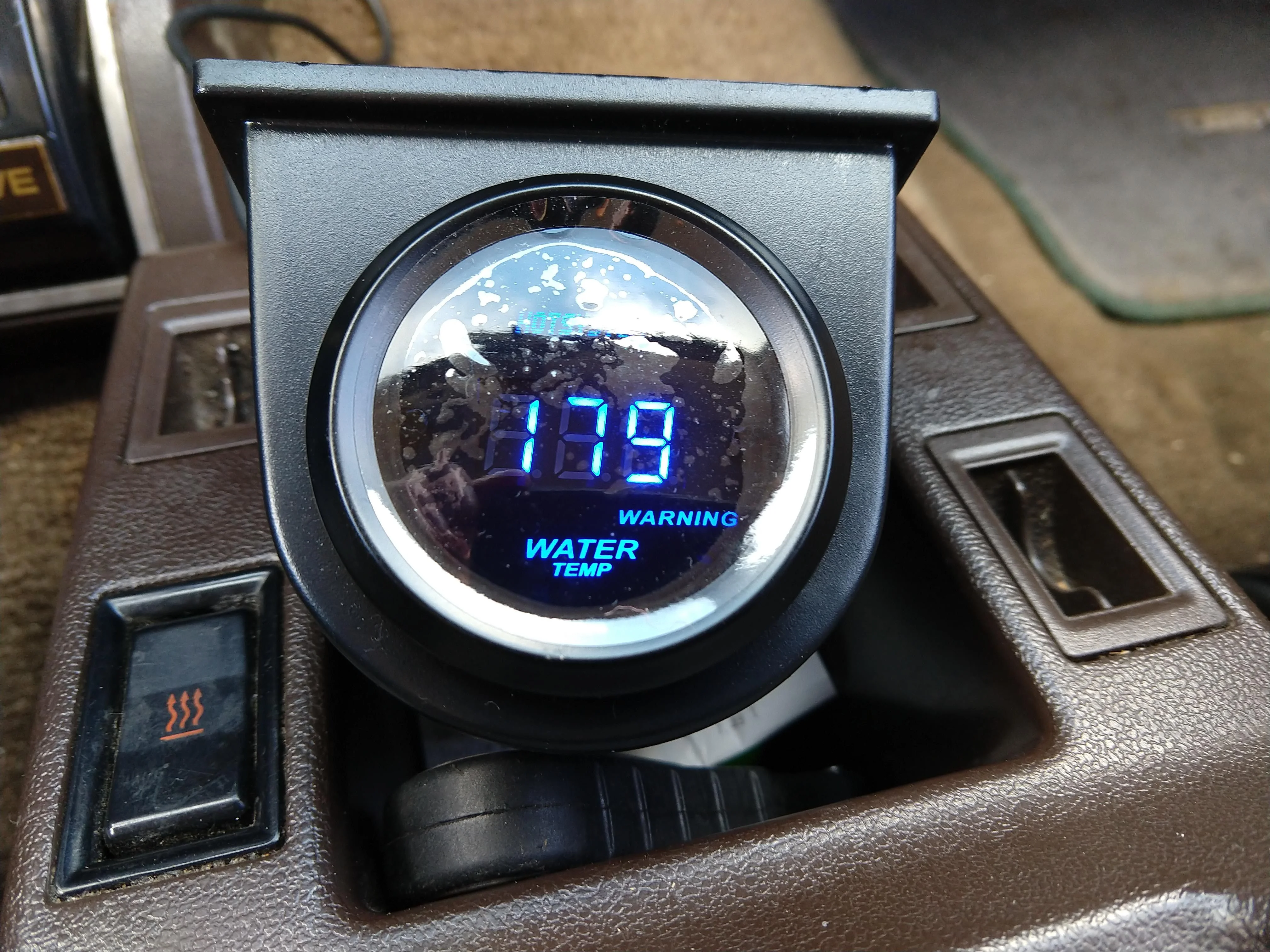

Pulled the trigger on a cheap digital temperature gauge. Early results look promising, but would like to do a 100 miles on the truck before I declare victory.
Main reason for doing this is that I don't really trust the stock OEM water temperature gauge. It seems to work most of the time, but whenever I go up any hills ( even if its only for a minute or two) there is a chance of temperature spiking. Considering that I have replaced nearly everything in the cooling system (including the T-Stat, O-ring, water pump, radiator, hoses, water temperature sensor, fan clutch).
Some folks believe there might be air bubbles in the system. This could totally be true. I don't know.
Anyway, with this extra gauge I feel more confident about what my real coolant temperature is, so that my "overheating" is hopefully just a thing of the past!

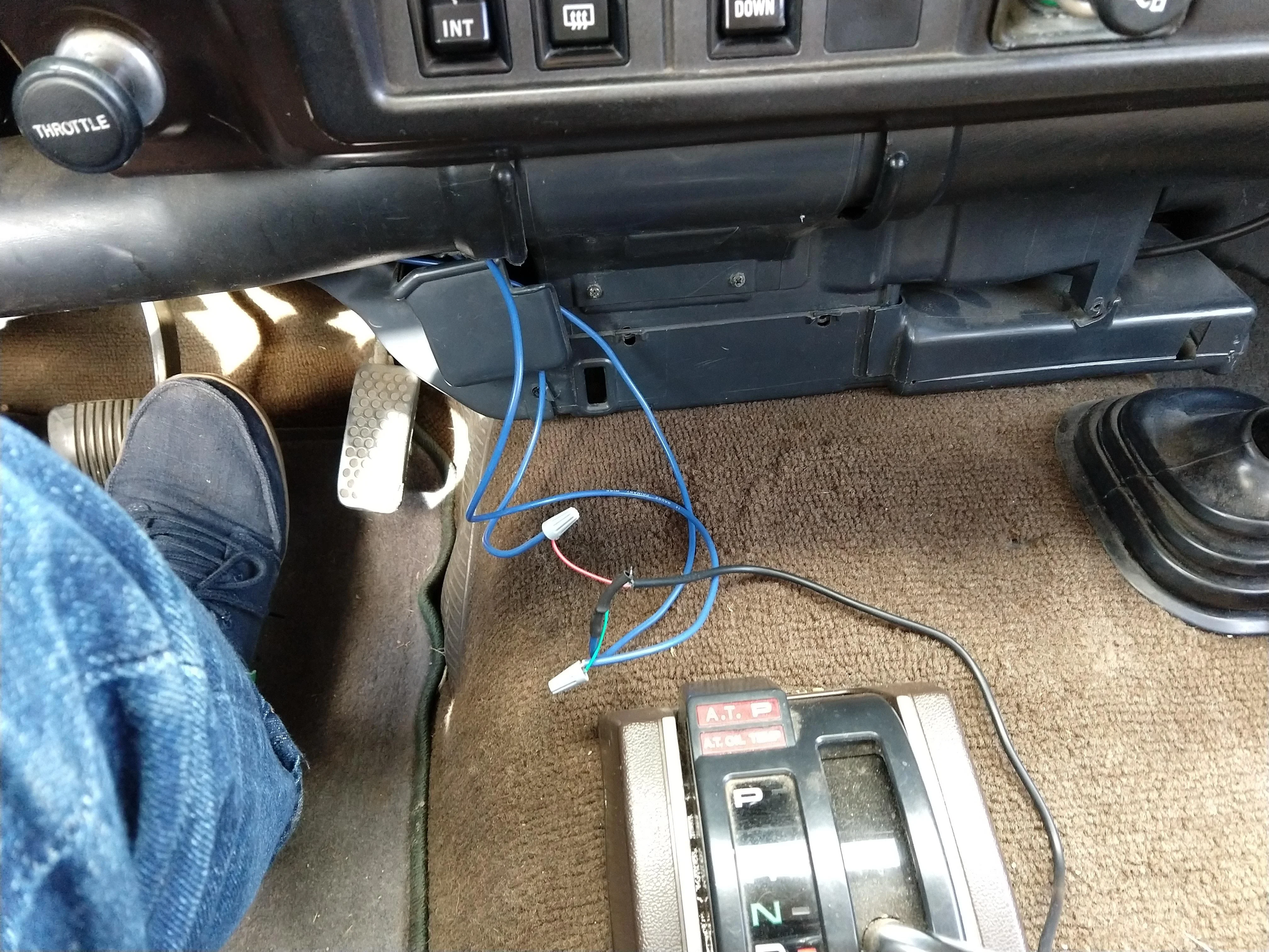

Parts:
Hotsystem 2" Digital Water Temperature Gauge - $20
Dewhel 38mm Joint Pipe Gauge Adapter - $10
Esupport 2" ABS Gauge Pod - $7
Add a fuse - $8
Materials:
14 or 16 gauge wire for ground, positive and negative
heat shrinking stuff
soldering
teflon tape
Tools"
wire stripper and crimper
soldering iron
knife/scissors
Circuit Tester - $7
Steps:
  1. Most people will say drain your coolant. I was too lazy, so I cut into my upper radiator hose and let some coolant fall into some towels. I had to cut out about 3/4" section in order to place the joint pipe adapter.
  2. You can put a little teflon tape around the temperature sensor before threading it into the adapter. Screw it into the adapter. Place the adapter (with two clamps) into the upper radiator hose. I angled my to the side so that the coolant will always be running over the sensor. If you place it at the inlet hose you are getting the coolant before it hits your radiator. So this is good approximation of the engine temperature. Some people will chose to add the sensor to the engine block or tap the thermostat housing. That's your choice.
  3. After adding the Adapter to the hose, I started wiring everything up.
  4. I added a ground to the adapter and grounded it onto the chassis.
  5. I added a long line from the sensor past the firewall ( I used the firewall hole that the oil sending unit goes through).
  6. Interior Work: Start by finding your switched fuse. I chose the "7.5 amp Gauge" fuse since you do not need a constant for the temperature gauge. I checked it with the circuit tester by grounding the tester to the door latch and turning on the ignition into "ON" - I didn't actually crank the truck on.
  7. Add a fuse is pretty simple, just add the existing 7.5amp fuse and crimp in a line to the "add a fuse" and connect the length of line to the water temperature gauge's harness.
  8. Next route the temperature gauge line that you brought in from the firewall ( and is connected to the gauge in the engine bay) and attach it to the digital gauge housing.
  9. Lastly, ground the digital gauge, There should be existing grounds that you can unscrew and screw into under the fuse box area.
  10. Turn on the ignition to see if your gauge turns on. Drive it around the block
  11. After you have checked that everything is in order, you can go back to your connection points at the harness and solder them together and heat shrink the connections.
  12. You will want to mount the pod somewhere. I am going to mount it into the plastic for the heater ducts.
  13. Next, marvel at your work and clean up.
Great write up! My OEM temp gauge is always in the same range as what you showed in your pictured. Always makes me wonder if its anywhere close to accurate lol
