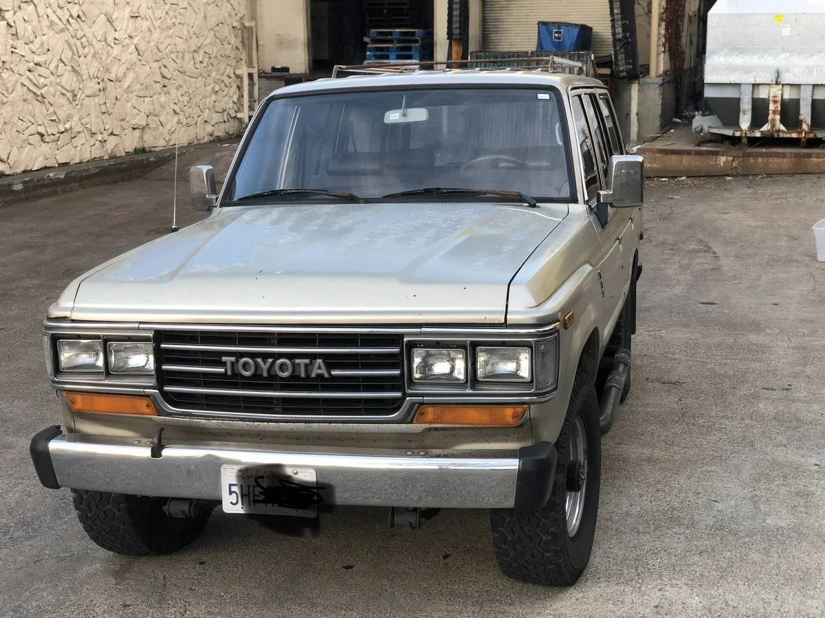

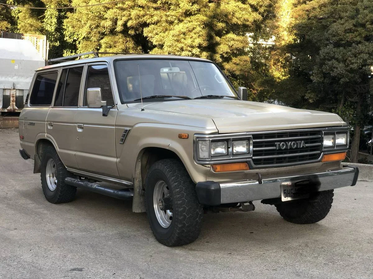

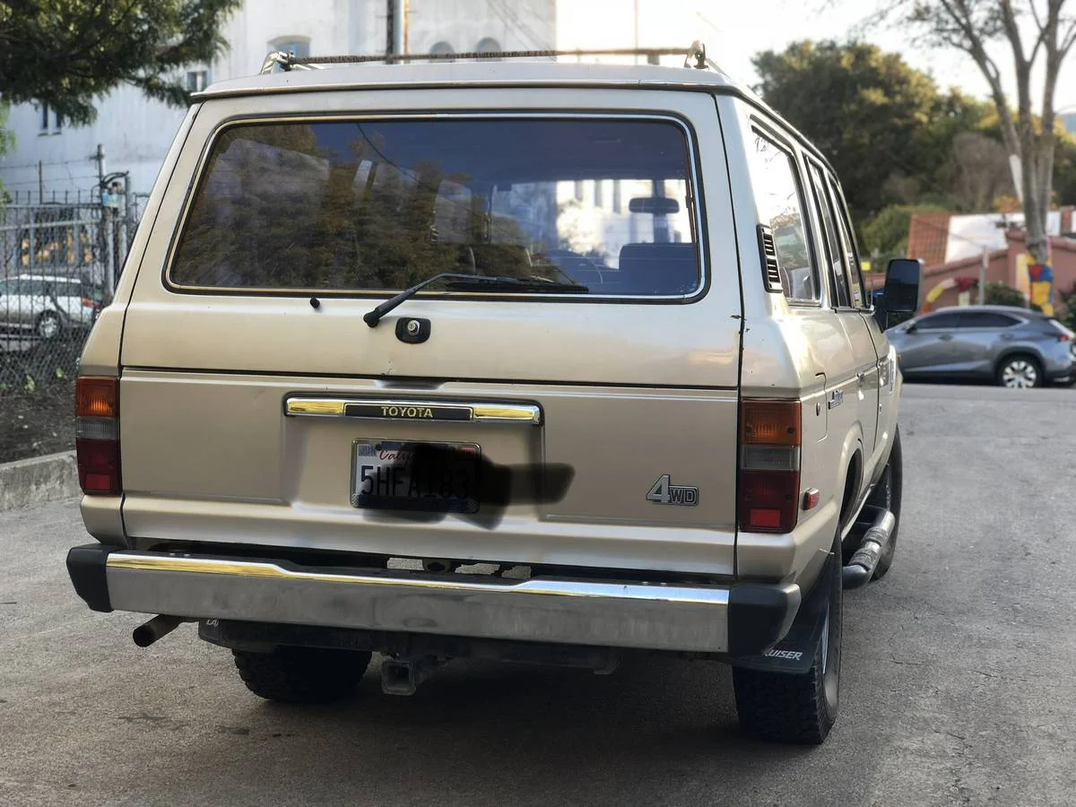

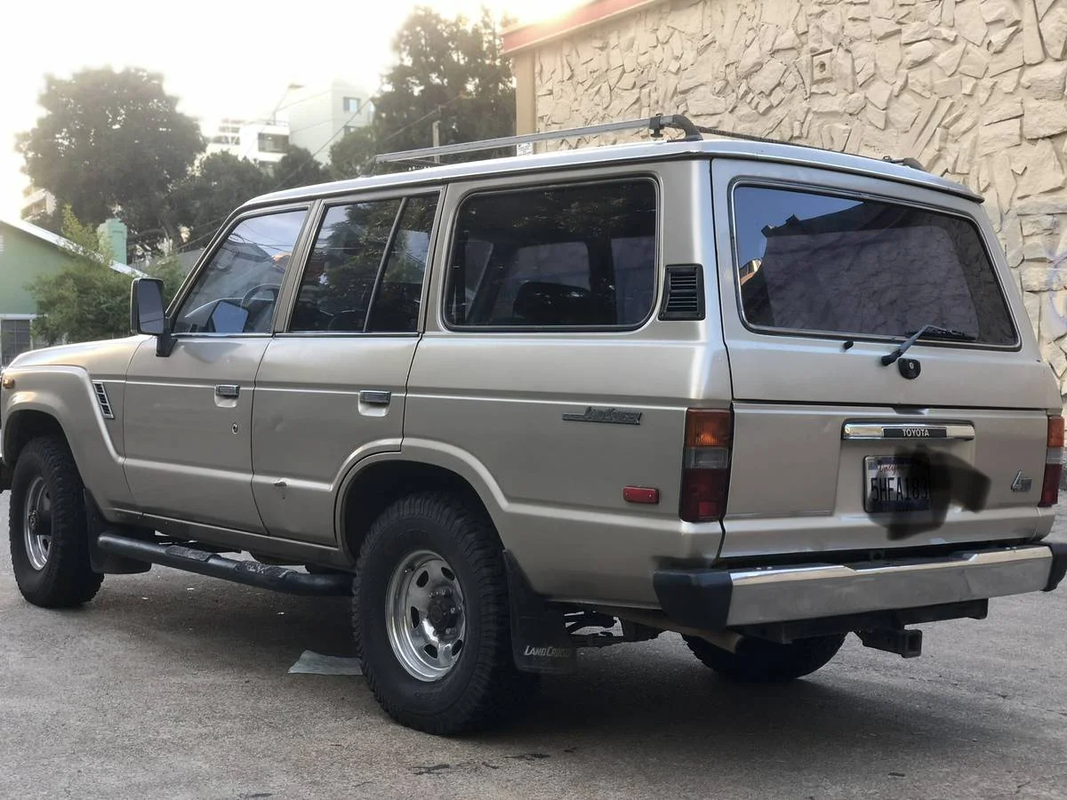

This is what I bought and what it looked like on day #1.

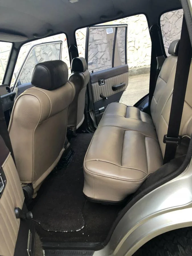

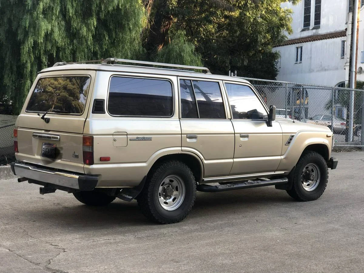

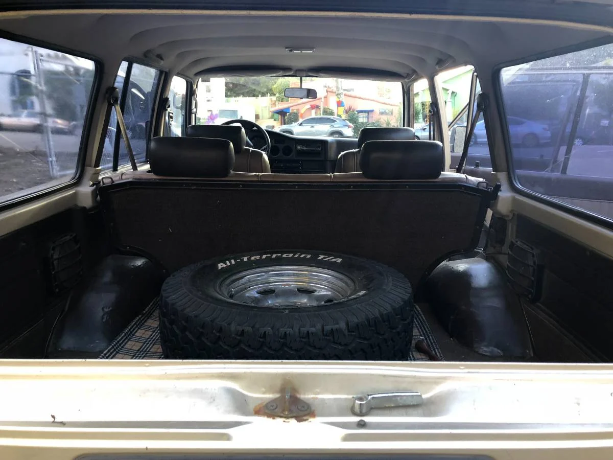

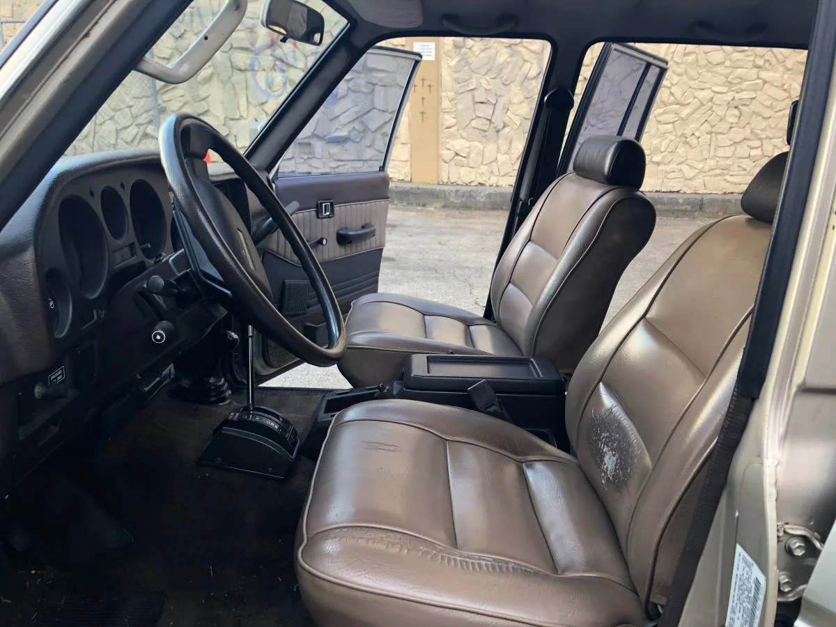

Attached are a few more of the initial shots that I downloaded from the original craigslist post.

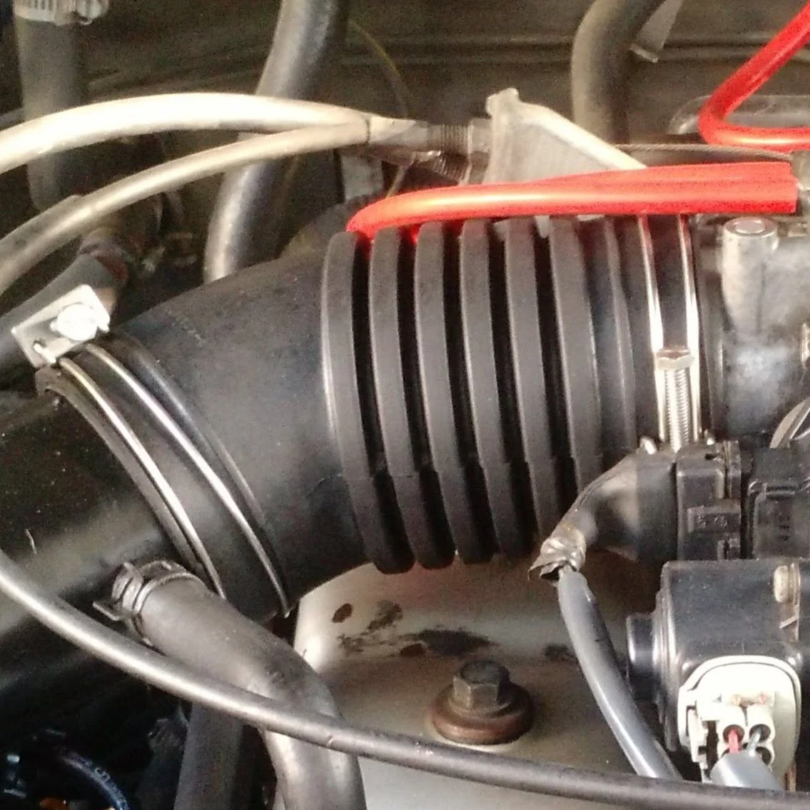

Sawdust was passing the emissions test just fine, when the vehicle tester was like "Hey you know, that tape around the air breather is an automatic failure."
Damn. Come on man. The truck already passed the test where the emissions are checked, but it did not pass the vehicle inspection.
The test guy was nice though and he said it would only be another $20 to get the truck re-tested. Only $20 is one thing, but then finding another air breather hose is a different story.
This is when I jumped into the world of spare parts, new parts, OEM, aftermarket and the price of the truck started to escalate quickly.
But I had to do this to pass SMOG, so it really was not a choice.
After sourcing a new breather hose from City Racer LLC ( which I though was in California, because their website says Palo Alto - but really the part was shipped from the midwest), I also replaced the upper radiator hose. In the purchase I bought new hose clamps, because why the hell not.
After what seemed like forever, the new OEM breather hose came with shiny new clamps and I went (and PASSED) the smog after paying $20 more dollars.

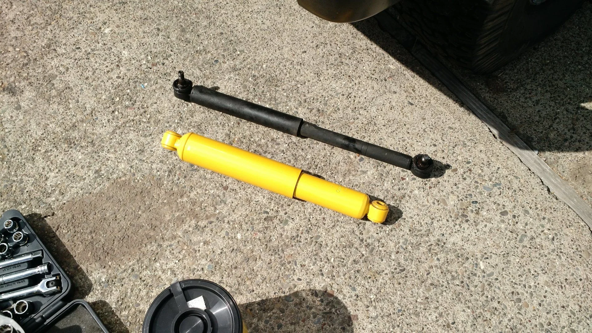

In March, I decided that an easy upgrade would be to install a new Steering Dampener.
One thing I did not anticipate was how hard the old dampener was wrenched onto the tie rods.
I decided to go with the OME. A side by side comparison gives a good indication of the difference in bulk between the stock and aftermarket OME.

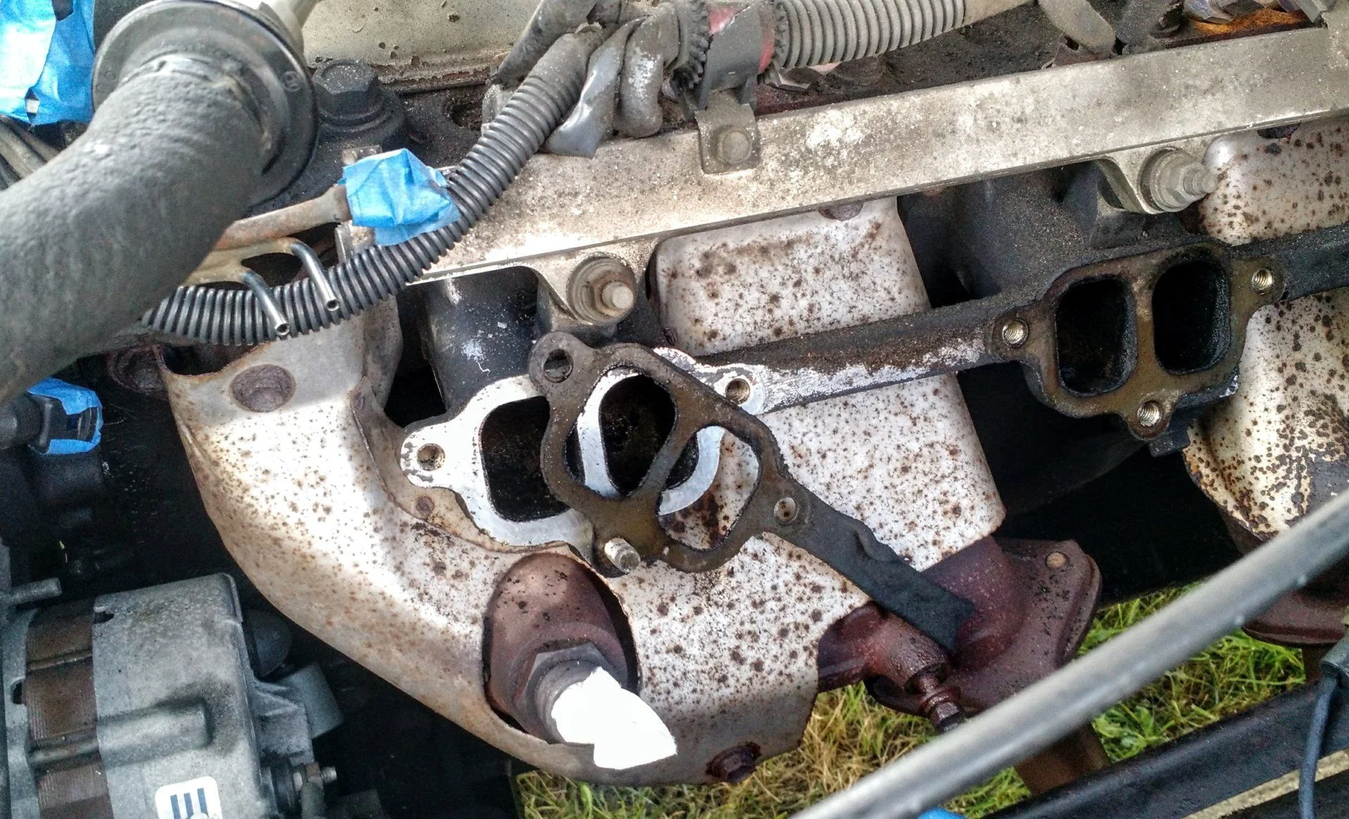

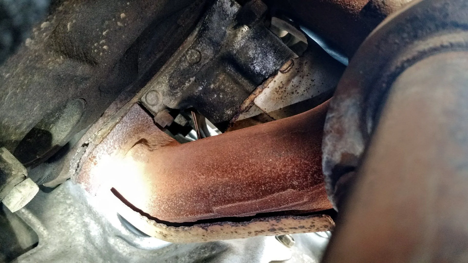

Here's a picture of the deteriorated exhaust manifold gasket.

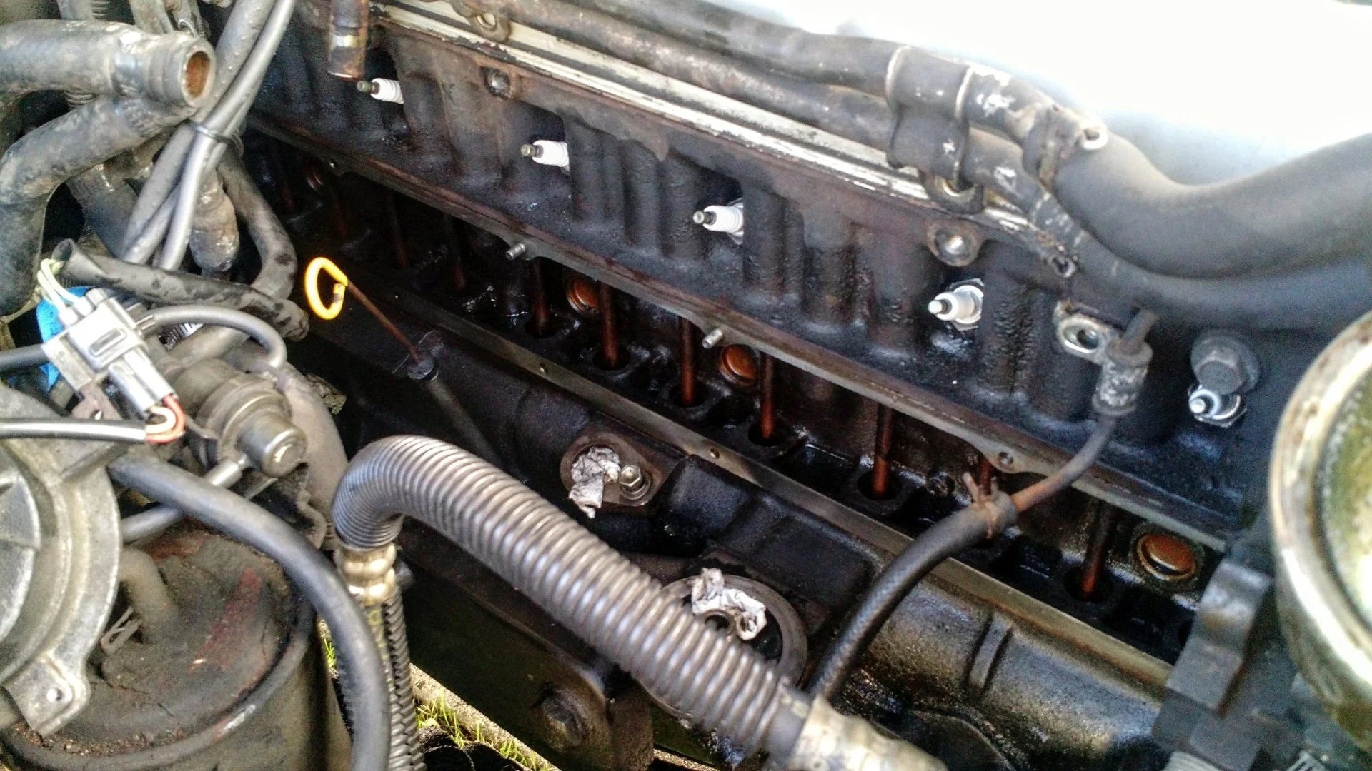

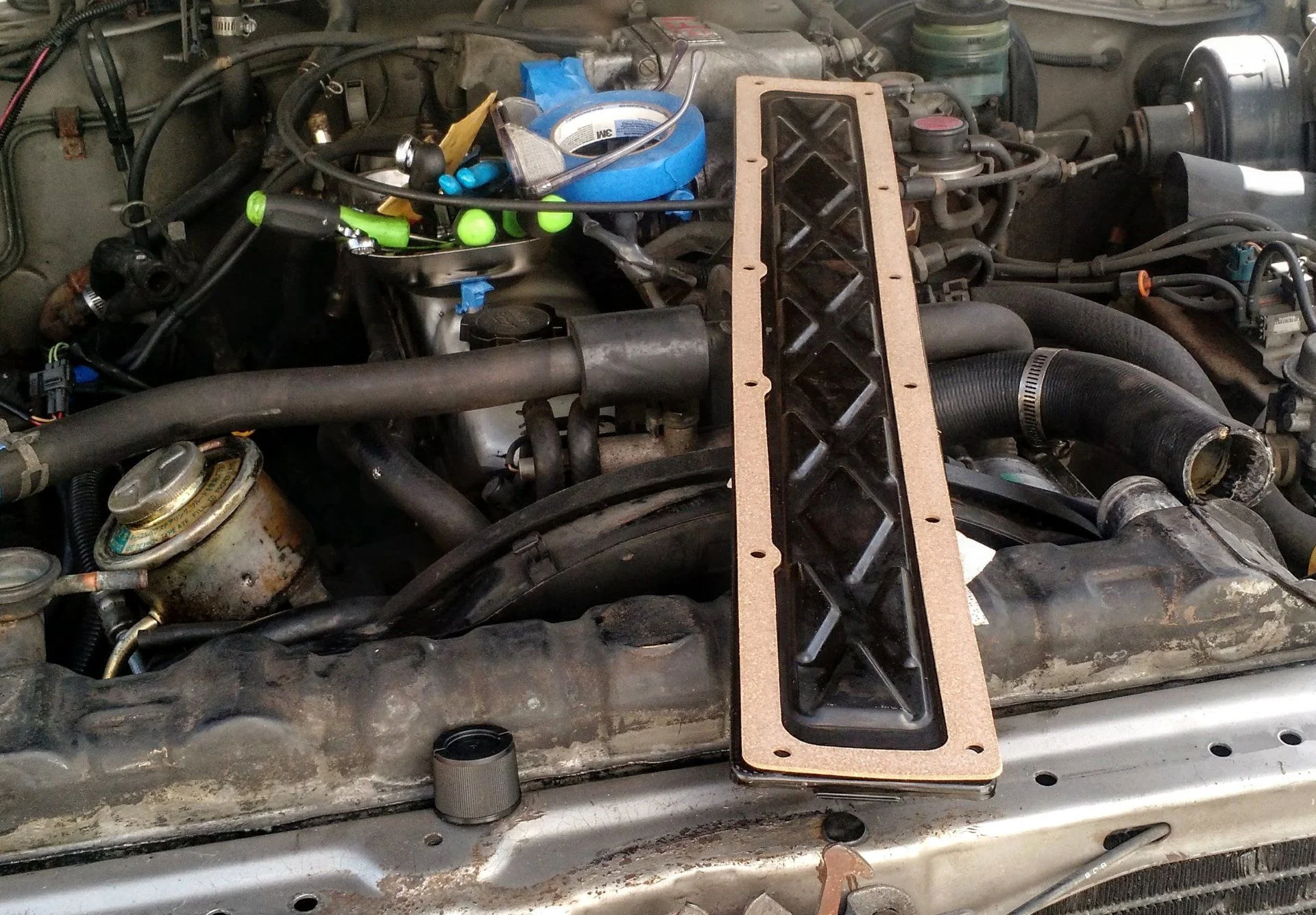

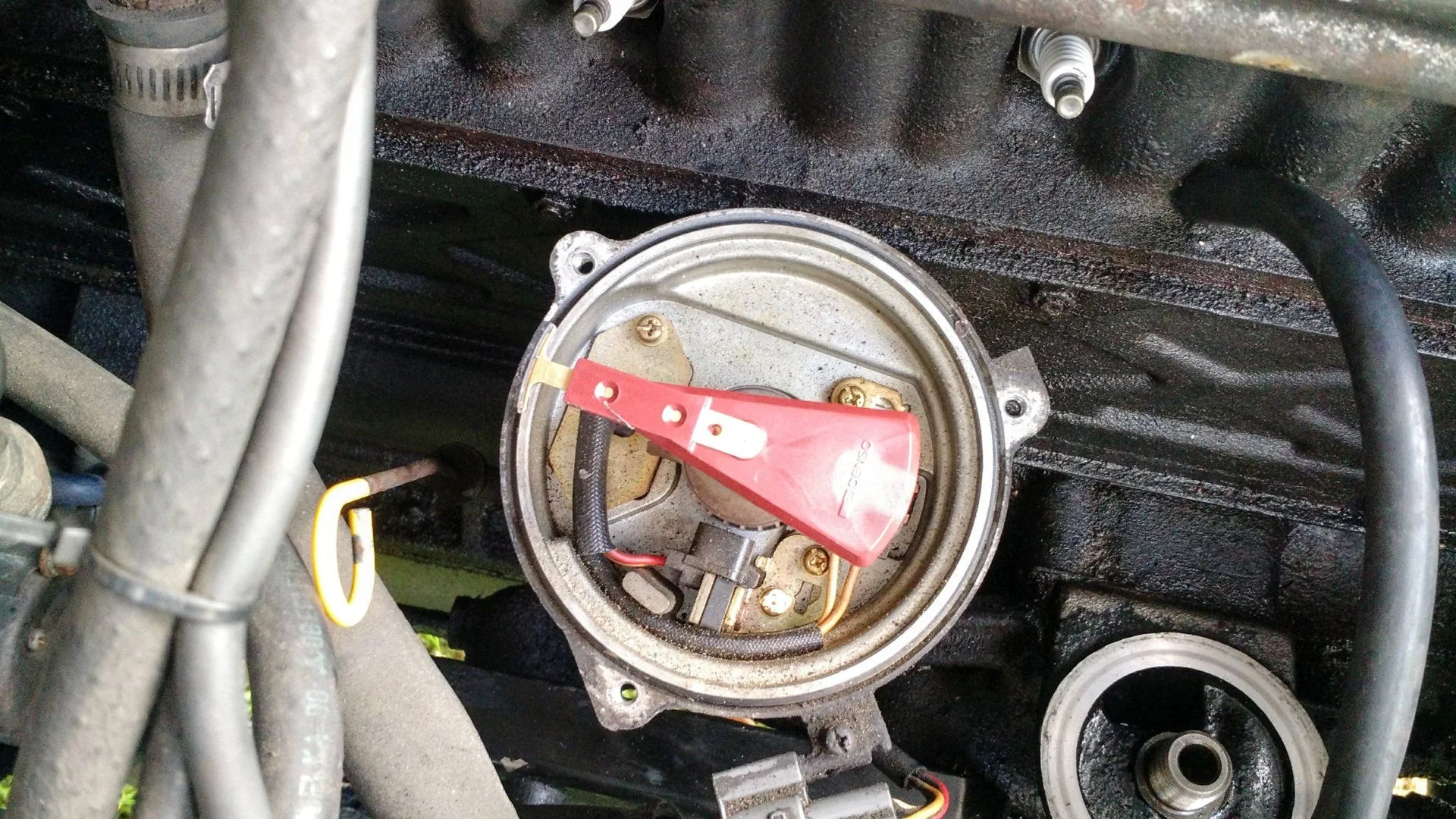

I think the point of no-return was when I took out the distributor. I needed to do this to fix the side cover gasket. Damn its dirty! I took this picture of the distributor, since every post in MUD said you need to re-align the rotor perfectly and to mark its position so that you can put it back in at the right position.
Cleaning the side cover and all the old gasket was a good feeling. It also started to make my mind think about all the different things that needed to be cleaned up while I had the truck out of commission. I saw rust and I did not like it. This gave me a renewed sense of purpose to tackle things that were not sexy, but necessary if I wanted this truck to keep lasting another 20-30 years.

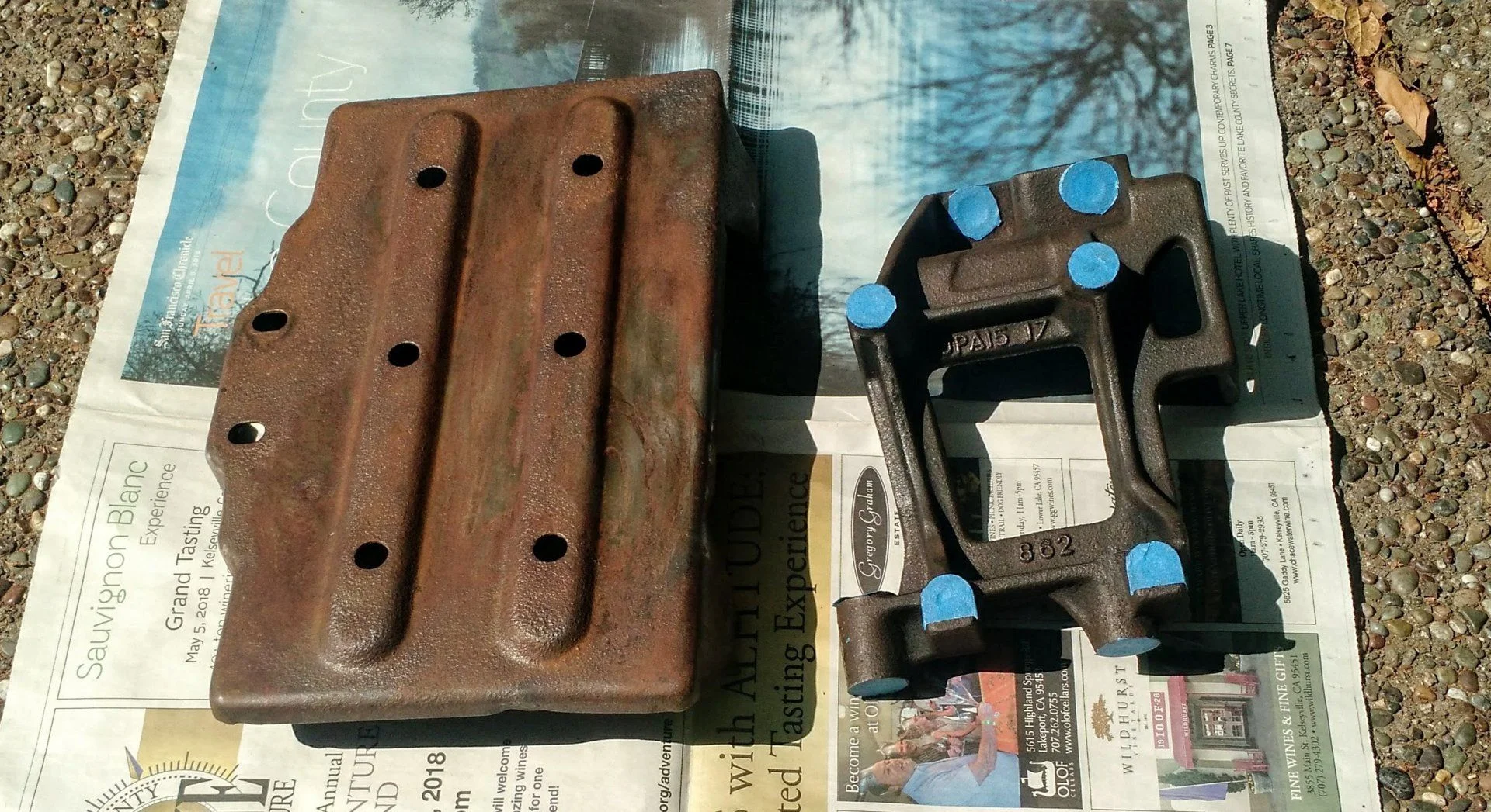

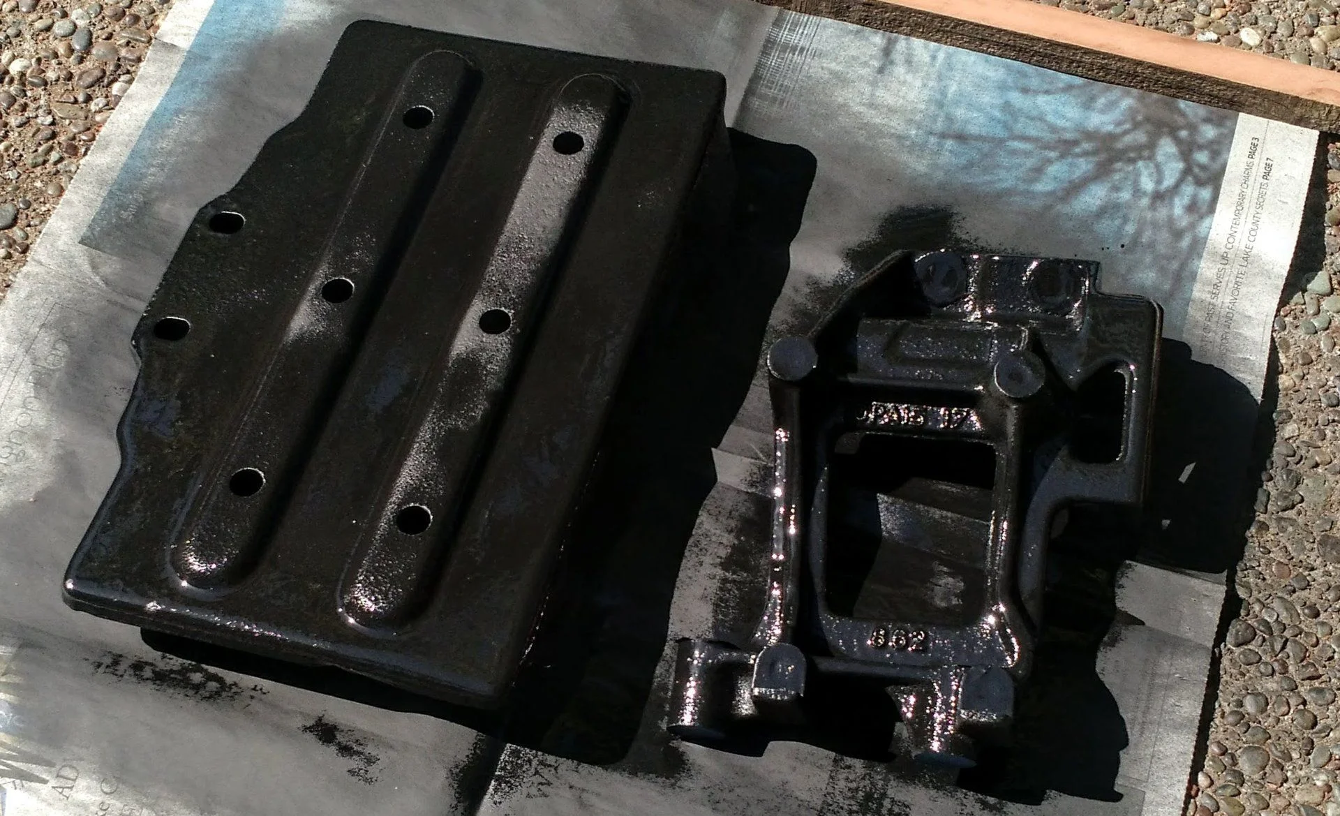

The more rust I found the more that cleaning it up and rattlecan spraying it with Rustoleum became that much more important.
The first items to get the treatment were the Battery Holder and the AC Compressor bracket.
I knew that changing the Exhaust Manifold Gasket would require lots of disassembly. So again, I took lots of pictures.

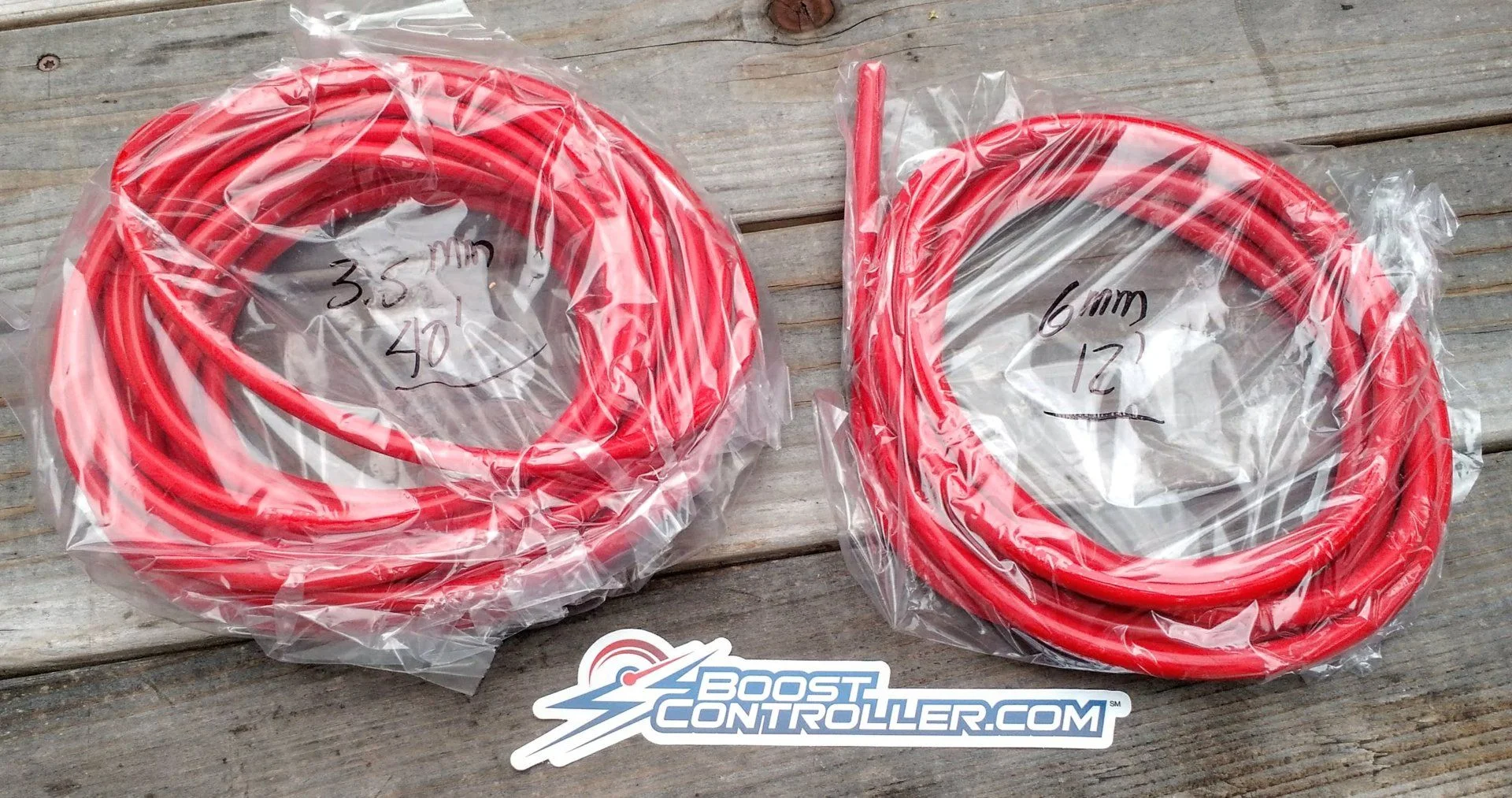

The hoses I choose to use were from Boost Controller I bought two spools as seen in these two lengths and sizes.
40 feet - 3.5 MM
12 feet - 6 MM
These lengths were perfect for me to replace all the hoses. I am glad I went with this length, since it left me with extra. I am still occassionally finding vacuum hoses that were not swapped out during this part of my restoration effort.

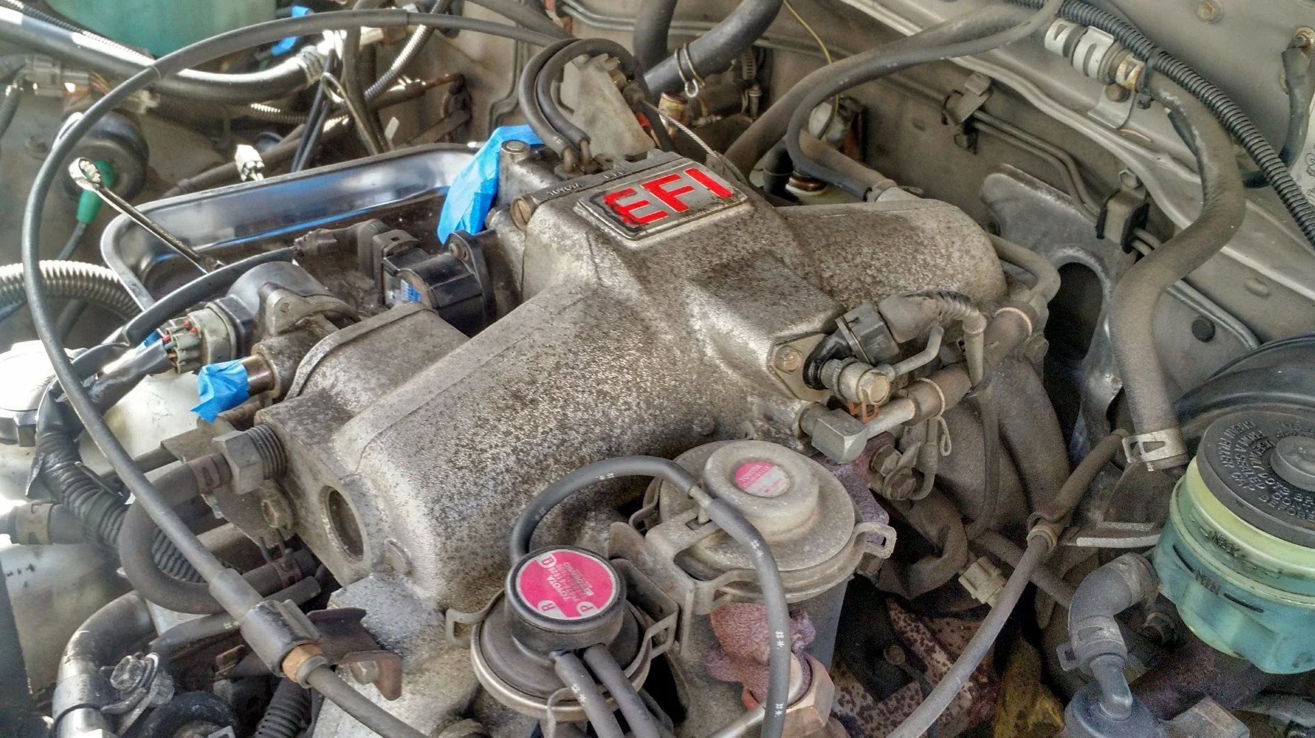

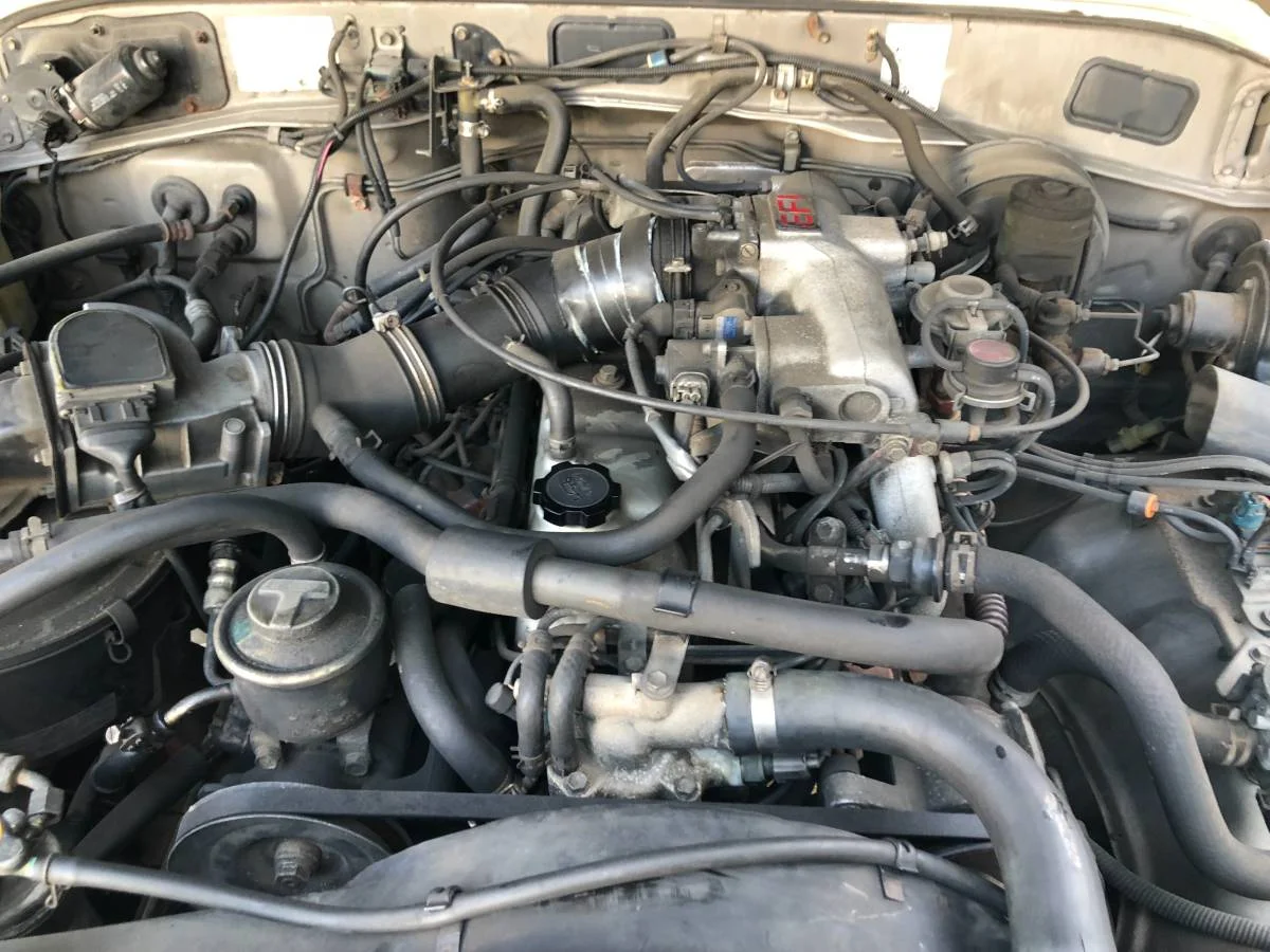

When I started to rip apart the passenger side of the engine, i realized that I would be replacing even more parts and gaskets. Like the Intake Manifold gasket ( which was torn in half). I also decided that I wanted to clean up the heat shields and paint the exhaust manifolds.
While I was in there, it seemed like a good time to have the Fuel Injectors cleaned and rebuilt. Cause why not?

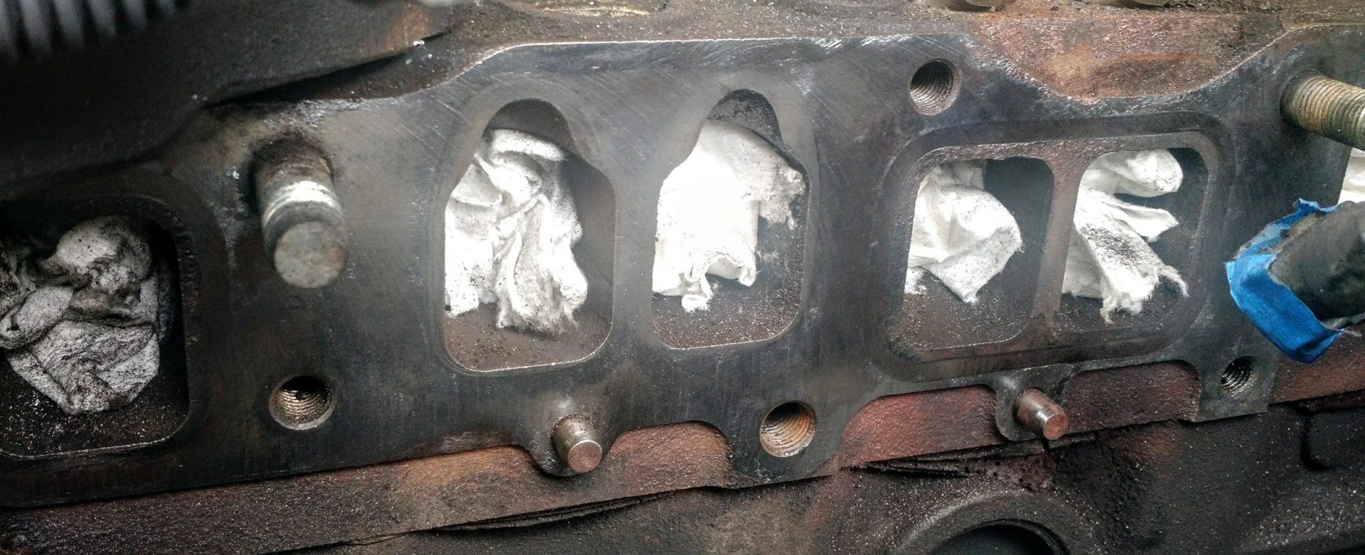

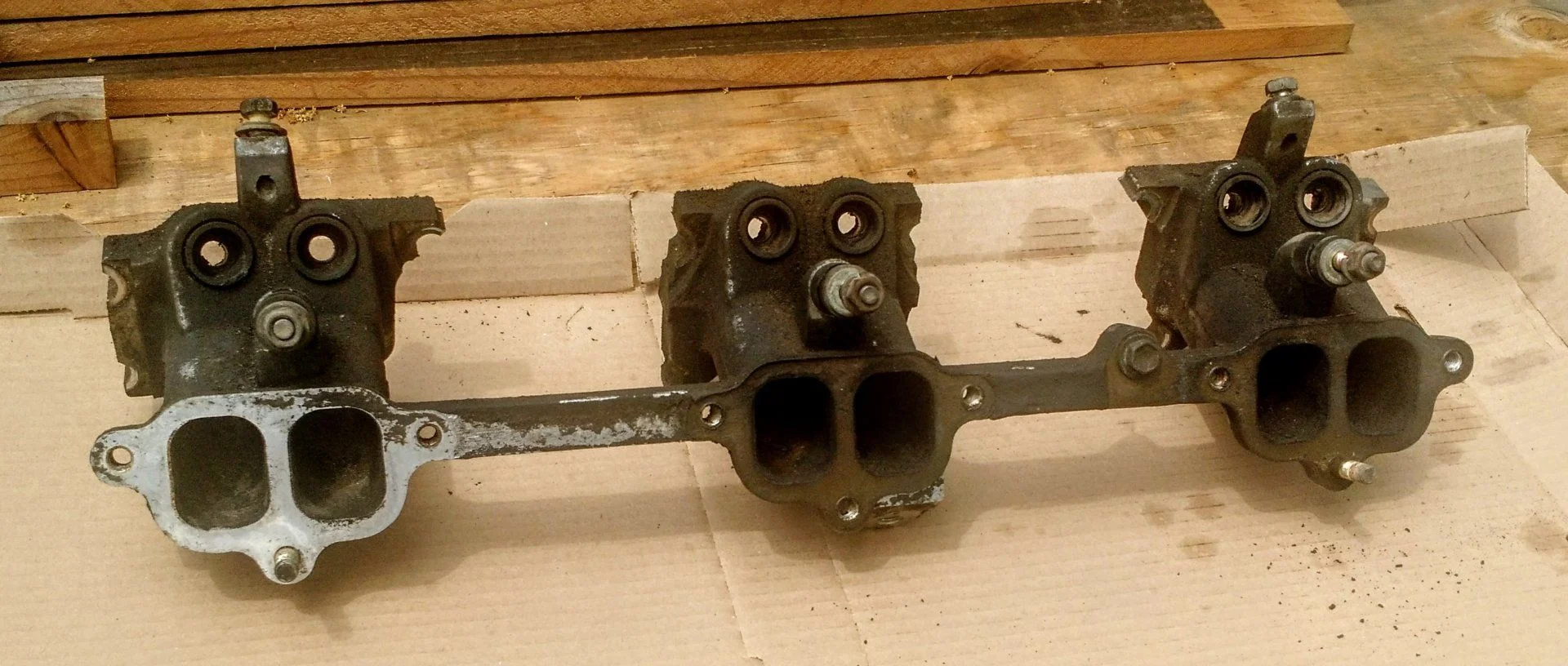

I started to get to the task of cleaning up all the old grime that had accumulated or gotten stuck to the various parts of the Exhaust.
The Exhaust Intake was pretty gross.
It was fun getting a wire wheel and a paint scraper onto the engine block to clean up the old exhaust manifold gasket. I felt like Mary Poppins.
