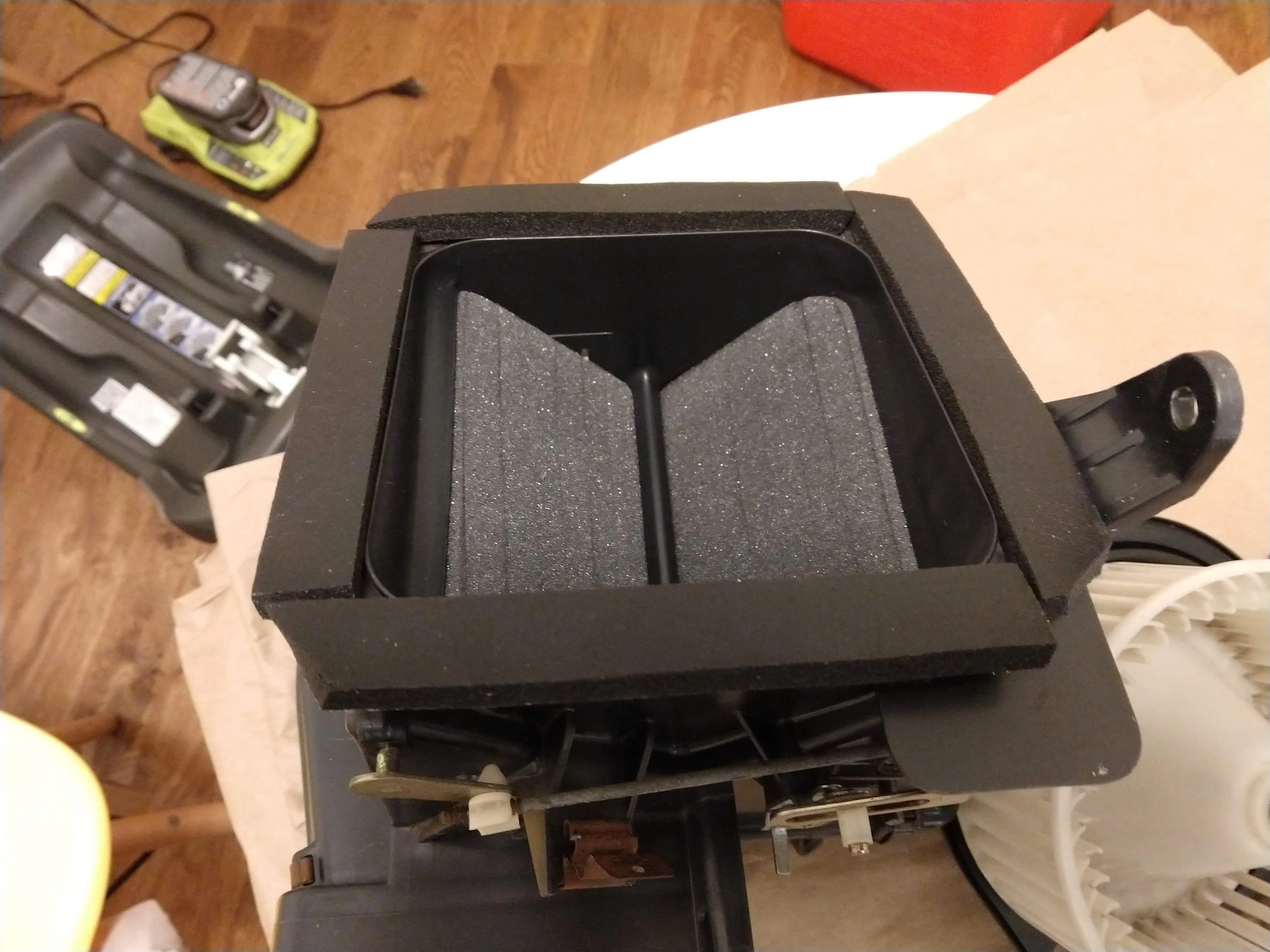

Finally getting around to finishing everything up with the Evaporator and Fan-Unit.
Took a moment to get the right parts figured out, since it was annoying having some items hard to source or mis-labeled ( like Rockauto sending me the wrong AC Expansion Valve). Also, was not the easiest finding the right type of open-cell foam for the recirculation flaps.
Ended up using some open-cell foam that I found at Ace Hardware. It is not from a foam shop ( didn't have time or care enough to drive to another foam store after Joann fabrics was a bust). Didn't really find anything good on Amazon ( I am sure it exists, but I am not going to spend MORE time on this small project). The open cell foam I got was in a 17' long roll and only about 1/2" wide, so I had to cut little strips and push them together ( as seen in pictures). I am sure that one sheet would have been a better option, but I can always fix this in the future if it ever becomes an issue.

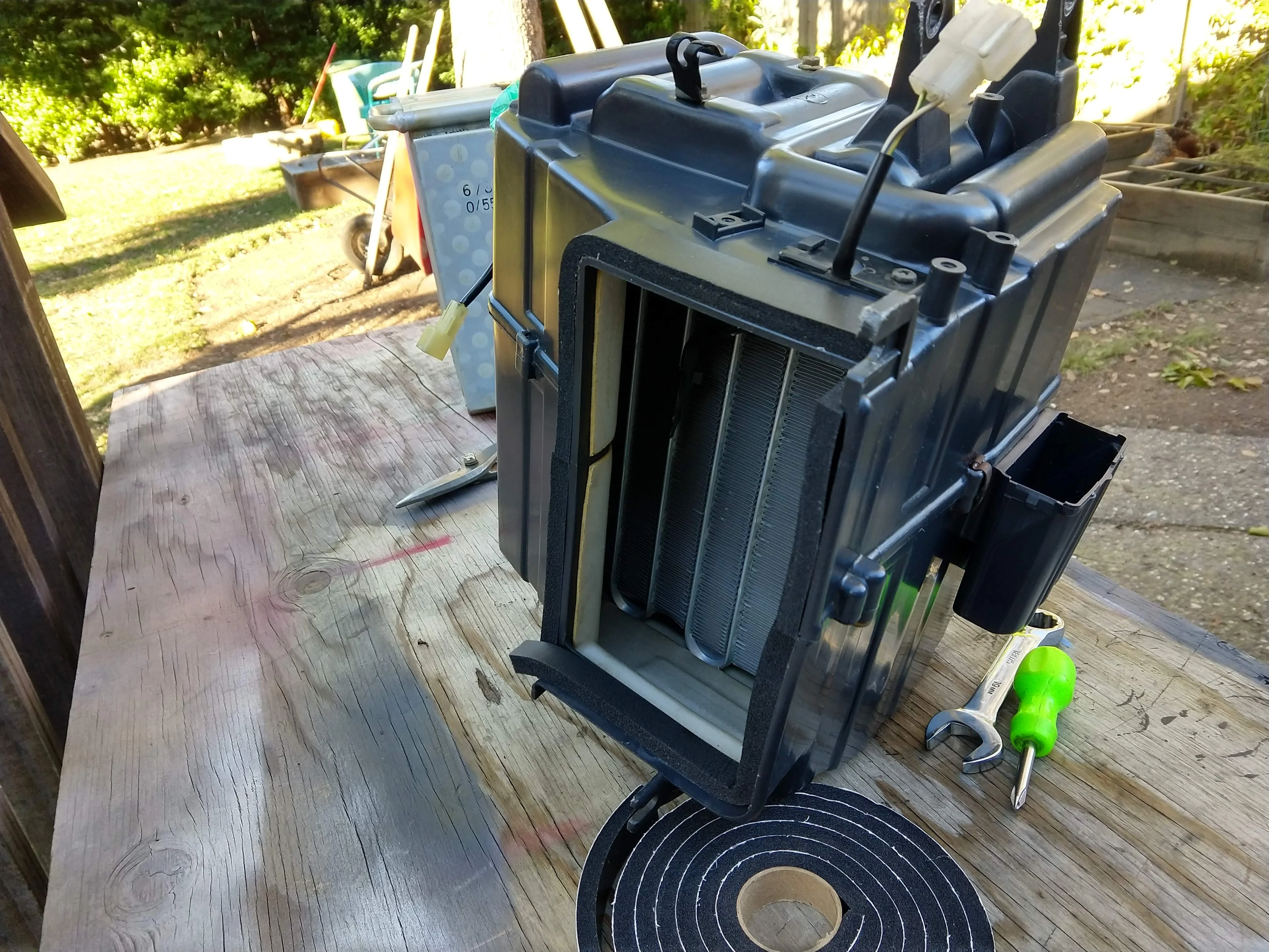

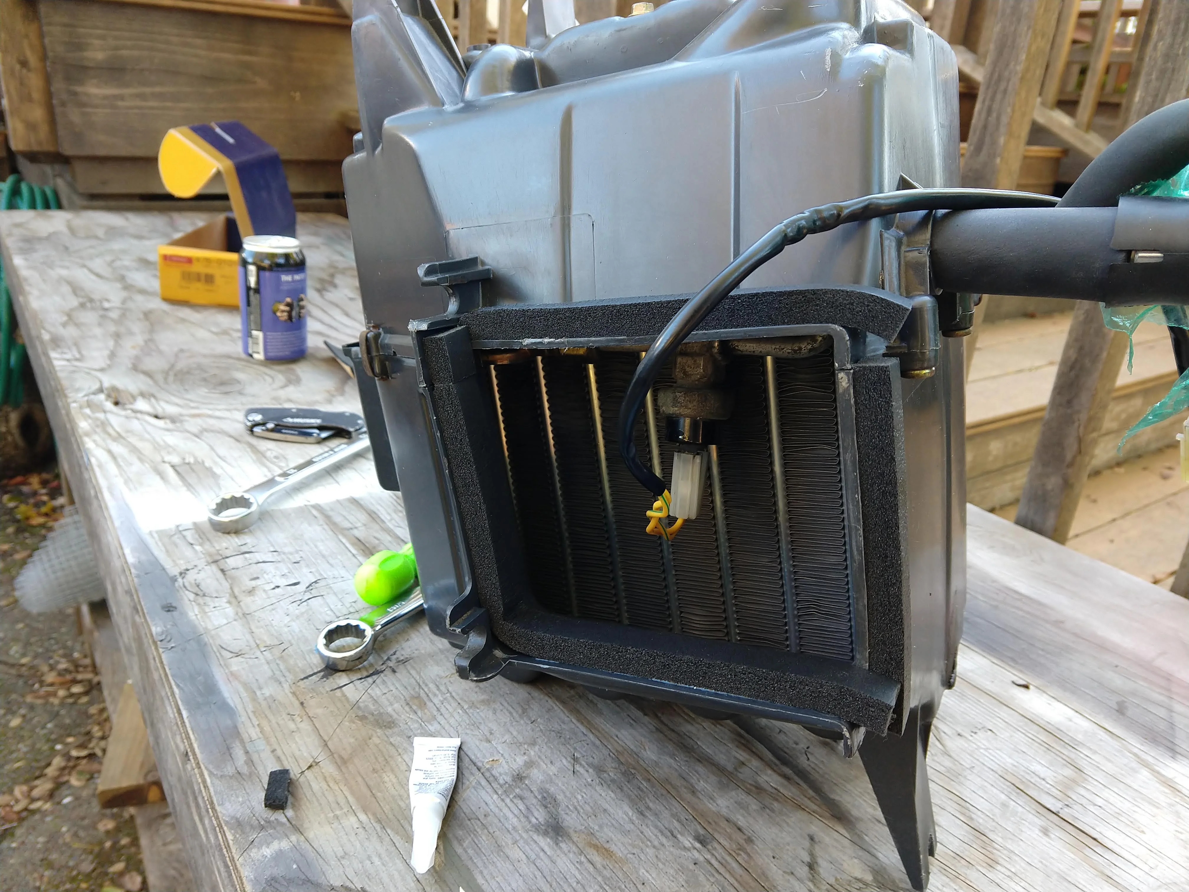

The welting I used is just closed-cell foam, which is also 17' long and both can be found at any home depot. This is the stuff in the door section of Home Depot for filling in gaps between doors or window frames.
The closed-cell foam had trouble sticking with its adhesive so I added some superglue to the mix in the hopes of securing the closed cell foam.
It made the reinstallation of the fan unit a little cumbersome, but I feel like the unit is really solid now and there are little to no gaps.
Took every component for a nice little cleaning - all the way down to scrubbing and using pipe cleaners. Will not be breathing in 30 year old deteriorated foam any longer.
