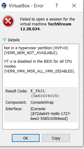

I feel like I may have missed something. After opening the VirtualBox and attempt to "Start", I get an error message:

You guys need to go into your BIOS settings and turn on the option for virtual machines. Message me
@Bsherv87 thank you for the quick response. I was able to learn how to change BIOS settings thanks to the school of Youtube. Link attached for anyone else that may experience the same issue.
worked in like 10 minutes - hey, I just turned older, and I do things a bit slower.

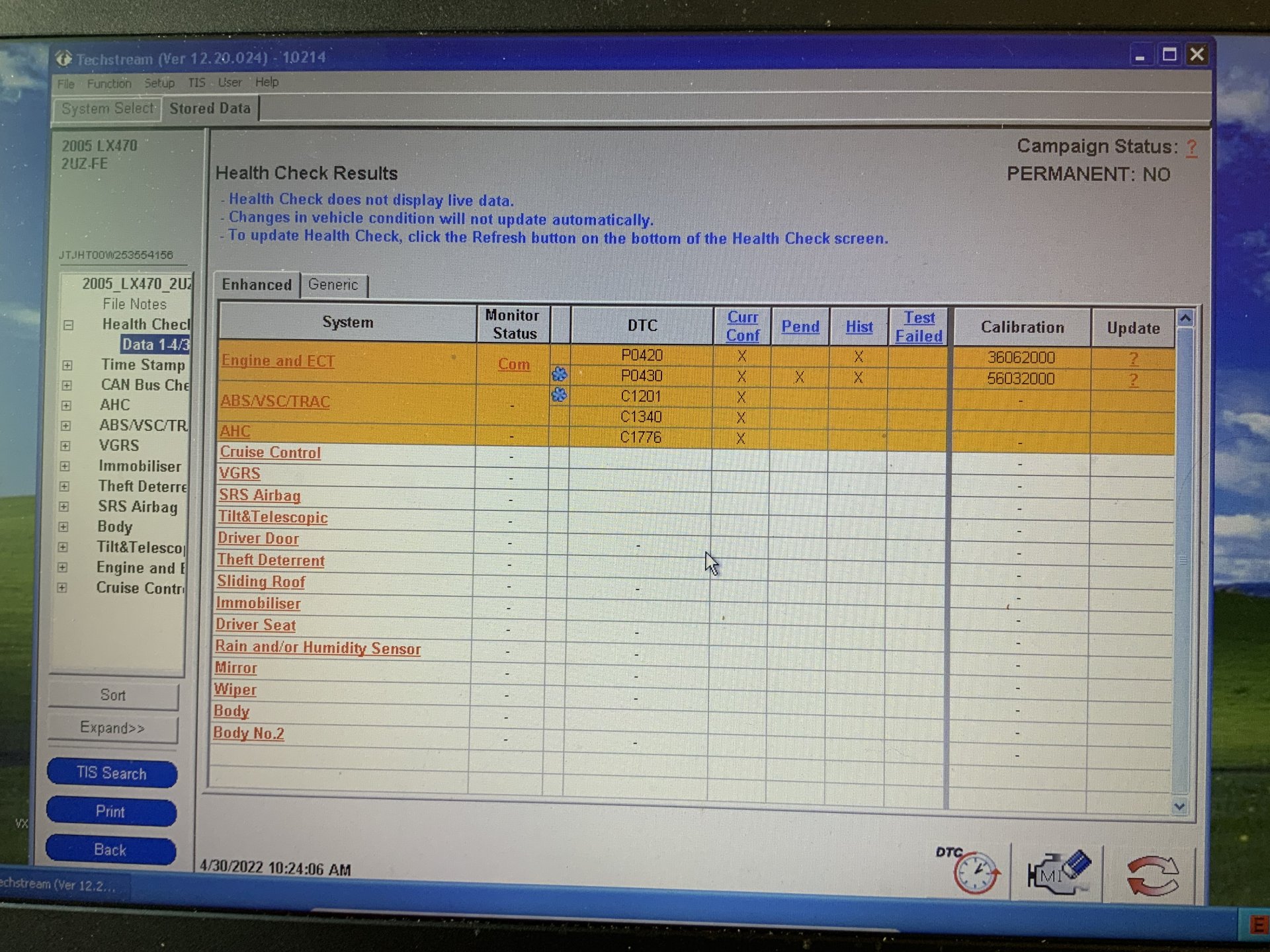

I sometimes get stuck on the Health Check selection in the Virtual window. By that I mean I can’t stroll or move the windowed box low enough to select that I want to perform that Health Check. Does anyone know how to solve this issue?
Try change to a higher display resolution.
