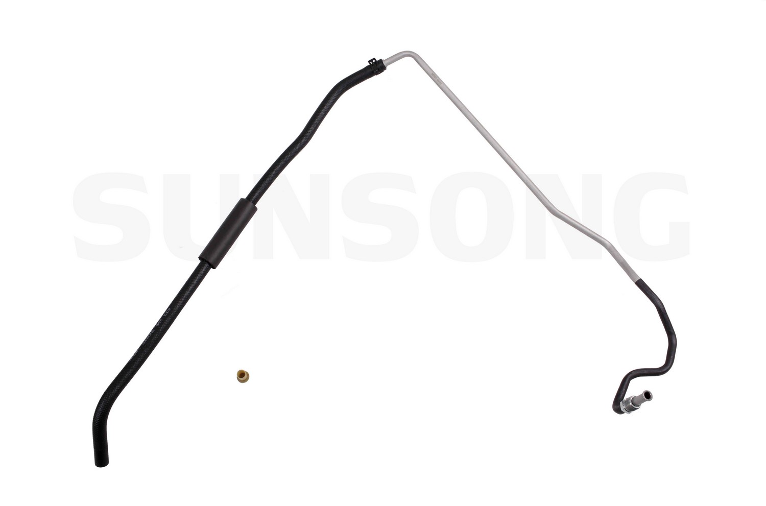

Update, I found the aftermarket hose from Sunsong on e-Bay, PN 3402991. It came yesterday and I put in this morning, pic of the new hose below. It seems to be of good workmanship and had all the right bends in all the right places and fit with no problems. Best of all, it cost me 35 bucks...hopefully it lasts a good long time. Here's a pic of it as received.
Low pressure hard line NLA on eBay.
Rock Auto carries this p/n, but they are out of stock, as is all the local parts stores. I am getting pretty close to cutting this, but would like to be able to get a replacement. You can get both lines on eBay for $122:

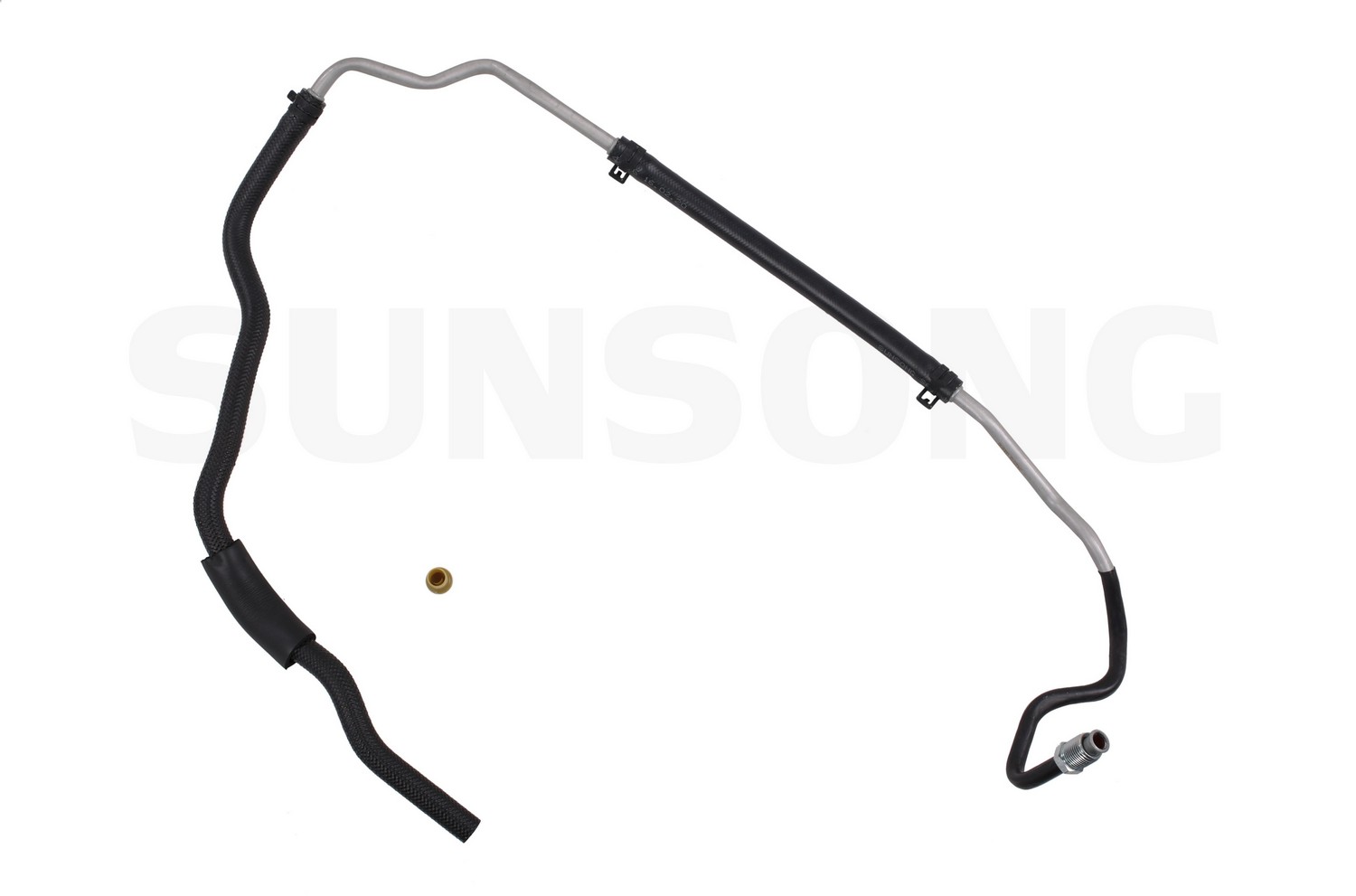

I wonder if the low press return line from '02 to '07 will work?
Has anyone tried this?
The rack is the same for '98 to '02, yes? So maybe a return line good for an '02 will work on a '99? My local O-Reilly and Auto-Zone have them @ $72 ea.
'02 to '07 return line:
'98 to '02 - both lines:
