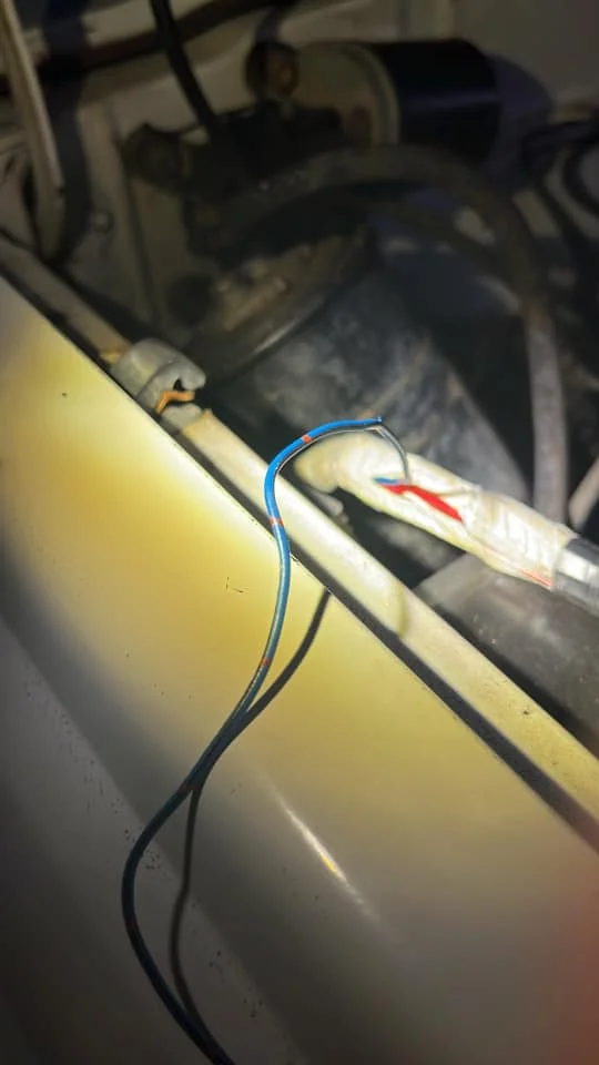

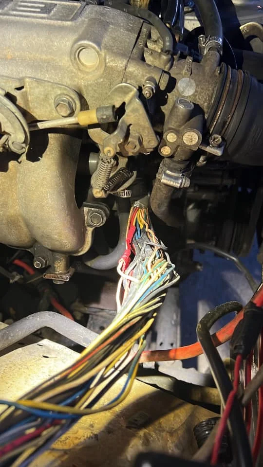

So I think I have two wiring issues. The wire I thought was for the 12v+ of the compressor is actually a negative from the a/c harness. It's blue with black, someone on facebook said it's the negative to the safety switches. I have no idea what it is supposed to hook up to so any help would be appreciated. What color should the wire be for the 12+ side of the compressor be. Can see my harness in the photo. Does it loop up under the intake and then back down? I feel like most photos I've seen the wire comes from where I'm showing in the harness but I opened up my harness and I'm not seeing an additional wire. My 86 had factory A/C and everything was in place except the compressor was removed.

I am not positive but I don't think this is the plug that goes to the compressor clutch. I'm only seeing five wires here, not six like the diagram. I believe that wire that bypasses the connector is the one that is cut. Any ideas on which connector I should be looking for? None of the other ones look like what I would assume the diagram would be pointing to.

I'm really not much use in this discussion. But, that cut wire looks like it's a W-B, white with a black stripe. Toyota traditionally uses W-B wires for grounds. I also see a W-B with a butt splice. I suspect those two are related.
Agreed. Any idea what color the wire is that goes to the compressor is? I can't find any definitive. Is the plug I'm showing the supposed to be the 1 through 6 plug in the diagram? I'm guessing with the system not charged if I do find the correct wire under the hood for the clutch engage it won't have continuous power right? Any idea where that under hood blue wire with black stripe should be connected to? Does that have something to do with if the engine is overheating?
See above, forgot to tag you.
The L-B wire is for the compressor clutch.
Are you sure? L-B is the blue with black stripe right? When I test that wire it's giving a negative signal and completes a circuit on my test if I touch the positive terminal with my tester. Will that change once the system is charged and ready to function?
Yes, I'm sure. From the 1986 EWD.
