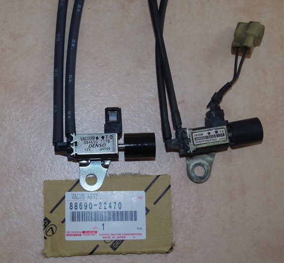

I have a fully functioning AC system( proper charge) sometimes and every time I jump the power wire to the compressor clutch. Other than a stuck VSV I'm not sure what is causing my sometimes it works. Looking for a replacement VSV for my '85 system now.
You will need to bubba an extension, but the part works.

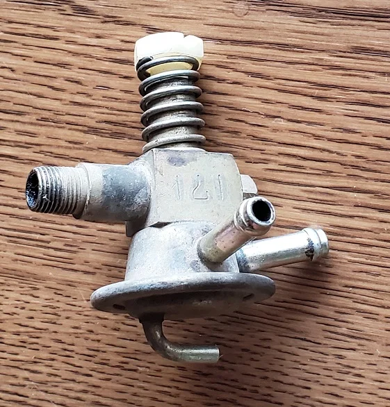

Just to add, that idle up valve in the pic pappy posted above are often bad. If it doesn't change your idle speed when you adjust it ,it may be bad. They are getting old and the diaphragm inside fails. It won't keep your A/C from working though. It just doesn't kick up your idle to compensate for the load.
Ya, there is an o-ring that fails. It can be replaced. I have a bunch. Let me know if you need one. The diaphragm can too, but mostly it's the o-ring.
