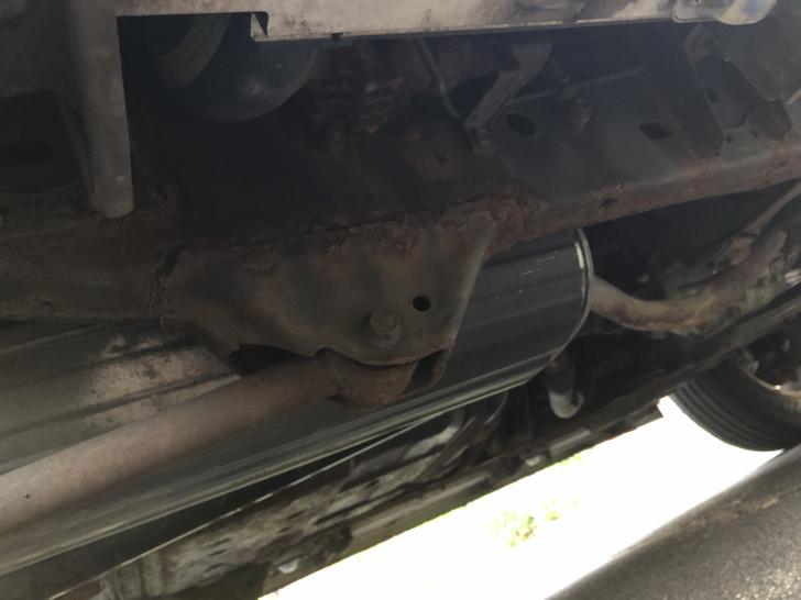

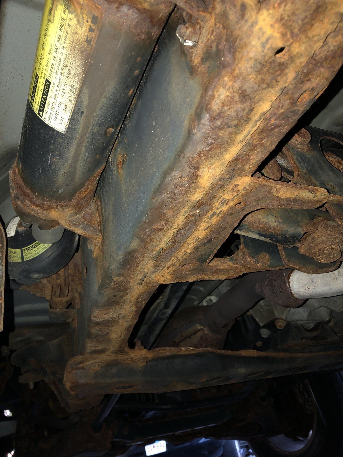

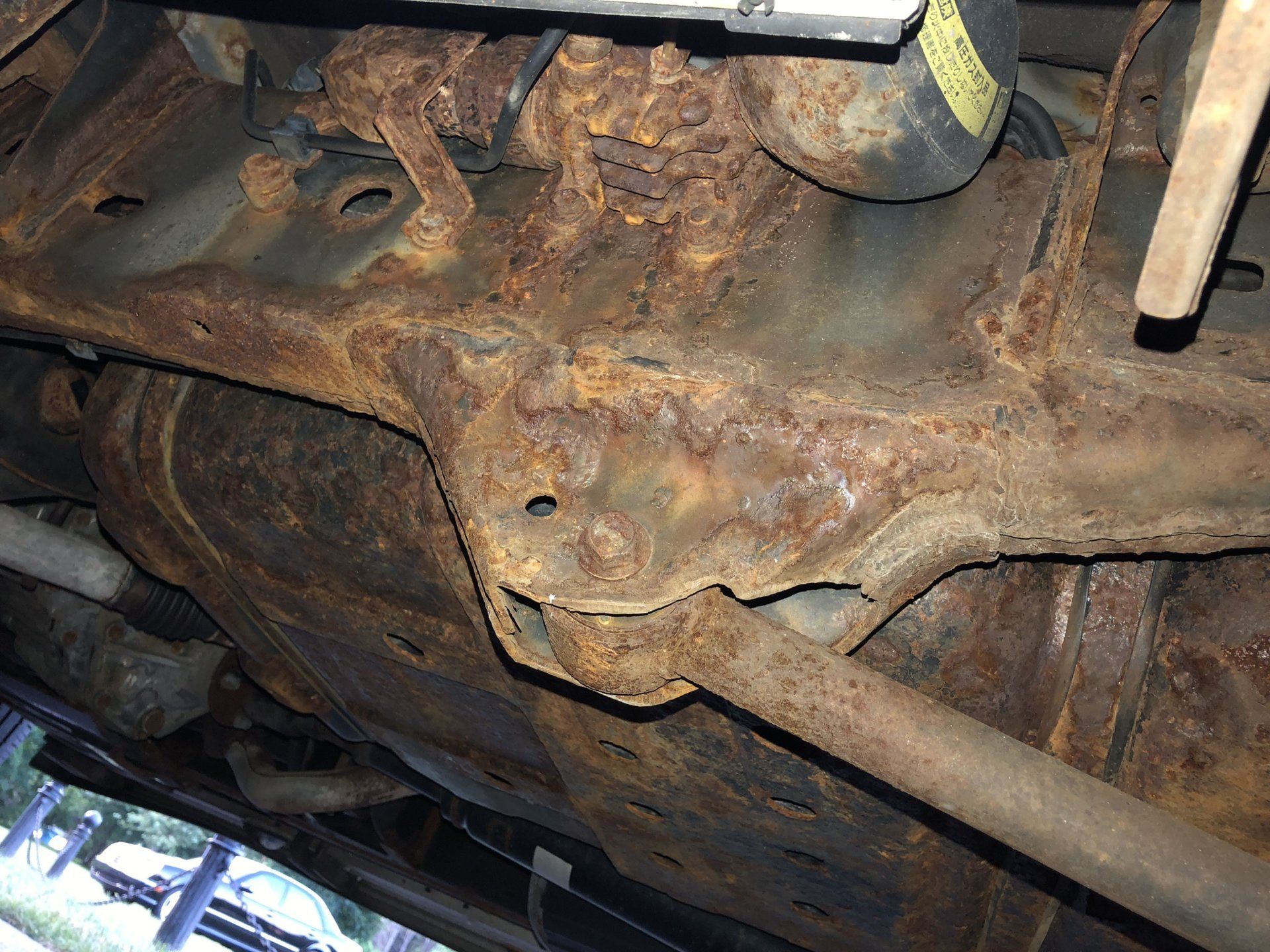

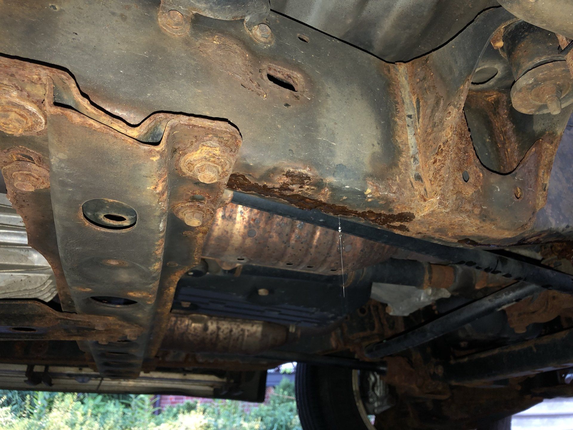

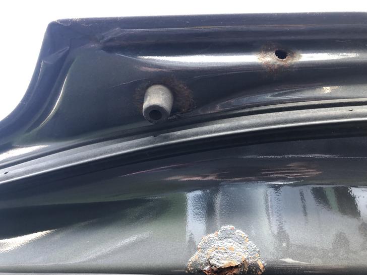

Hi y’all. I’m new here and trying to jump into the deep end of the 100 Series owners club. I’ve had Jeeps in the past but love the idea of something with the same capability but more reliability and comfort. My budget is tight and I have my heart set on an 03+ (which may not be entirely realistic) and I found one locally that ticks all the boxes. I went to look at it yesterday and found more rust than I had expected. Granted, its a New England truck so some is to be expected, but how much is too much? Link to Imgur gallery below to more photos, but the frame is my biggest concern and is below. The rest of the truck is in great shape and has been maintained religiously. Most importantly, its an 05 within my budget... But is this a sign I should run for the hills and look for another? I'd be willing to put in the time of slathering on some rust converter and POR15 if its not too far gone, and likely would have to replace the rear hatch, but I just wanted to get some expert opinions. Thanks!
Last photo is the upper hatch.

Why would you even remotely consider something like that when there are so many clean, rust free 100s to choose from in the SW?

Having lived in the North East my entire life, I feel like I've become slightly desensitized to rust. I also don't love the idea of buying something that I can't go drive and poke around myself. Poke I did, and while my screwdriver didn't go through anywhere it was clearly enough of a red flag that it resulted in this thread lmao. I certainly appreciate your input!
Dude, I have a Midwest 02 LX470 that I consider has a ton of rust. This one is worse and I am from midwest.
How many miles?
What's it asking?
It's usually the rear cross members that rest out first. If the main rail is looking like that I'm expecting there's holes in the rear 2 cross members.

On this forum, people are especially sensitive to rust and may have never seen it. I have seen some posts where it was just surface rust but posts saying run.

149k miles, asking is $11,000 but I have a strong feeling I could talk them down more. The interior is practically mint and everything works perfectly. If it wasn't for the frame, I would pick it up without a second thought since I have a buddy that can fix and repaint the hatch (or repaint a replacement) for cheap.
But it has no future. Investing in it would always be questionable and filled with angst. You'd its caretaker on the way to the salvage yard. These vehicles should have a bright future as collector cars. Buy one with a future.
The problem is that the frame is the foundation of the truck. Great interior doesn’t help much if it’s attached to Swiss cheese. I grew up in NY, and am well familiar with the problem, but having moved to Colorado have really come to appreciate rust-free vehicles. One of my big concerns with the photos you’re posting is what looks like a very rusty seam down the middle of a major frame rail. Suggests a continuous (through the seam) failure. And, as others have pointed out in other threads, it’s not only the frame components that present issues- you’ll be fighting corroded together fasteners whenever you do anything.
