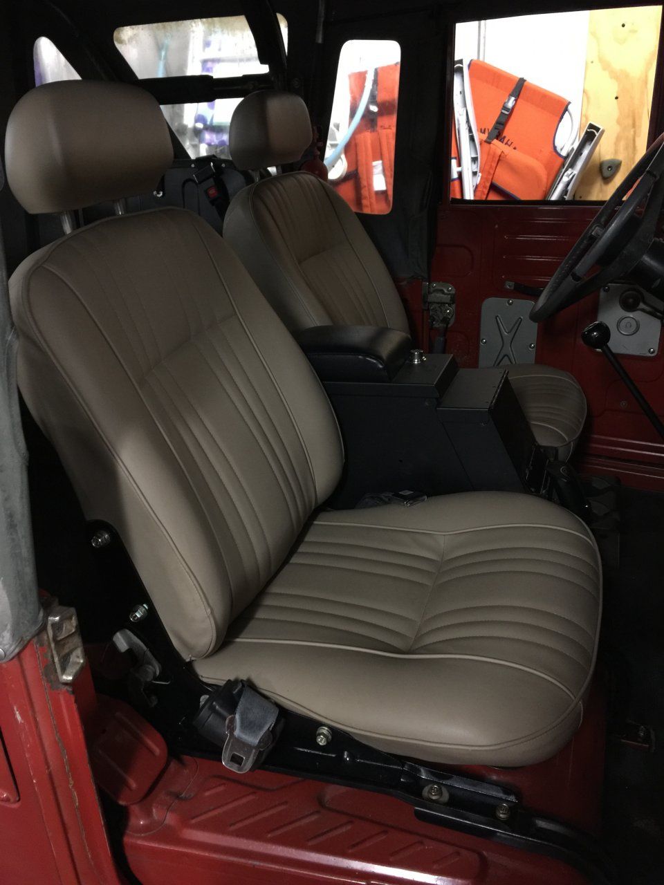

It’s a snug fit but it will be fine - it definitely touches the chairs. I have the one with the stereo slot which is 8” wide at the front (remaining is 6.5”).

I have the Tuffy 8" in my '77 with OEM seats. It is snug but works and I also have the issue with the shift shaft and tall drinks but I don't want to bend the shaft. I did a 7 1/2 year restoration on mine, all original. Constant travel, overseas contracts and family didn't allow a faster rebuild.

Yes it’s snug but does fit. I did bend the shifting cane to give it a little more clearance

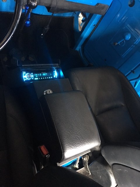

I have a tuffy 6" with the radio pocket and cup holders. My seats are aftermarket and I'm 6'8 so their position is different. The console sat too high in the front and their top cushion is really tall for my liking. I cut their mounting bracket and just used back part to clear the rear heater hoses. The frt part of the box is bolted to the stk seat crossmember. I knew i need a lock box because I dont run top, and this is a solid unit. My only minor complaint is, it's a little tight between the top of the radio and the wall of the box. My fat finger has got to be just right to turn the radio on. I'll be making a shorter top pad with some distressed leather in future.
