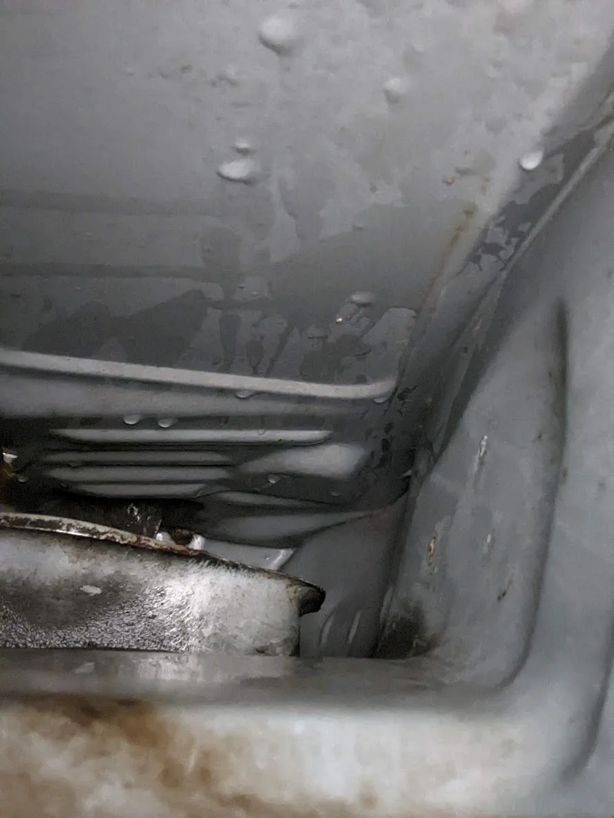

They can get in via the torn steering shaft seal but I also believe they get in via the water run off channels on each side of the cowl. The air intake does not have a screen/filter over it and it is direct to the the blower below it.
Here is mine with a filter.

Is this a custom made filter?

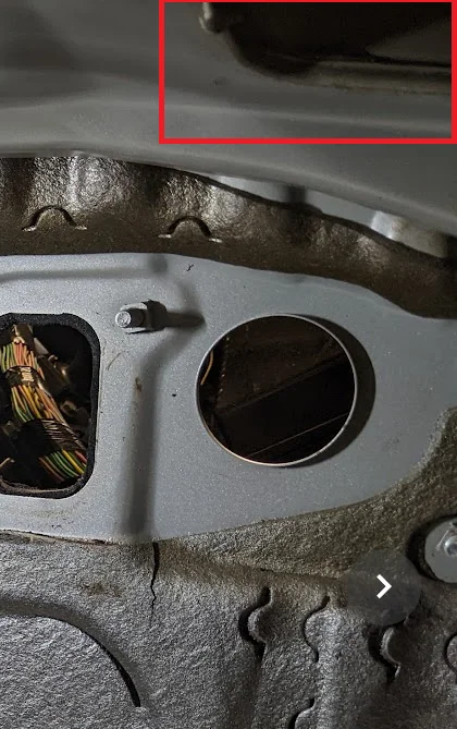

What? How did you get that Photo?? Where is it taken from?
I really want to fix this mouse problem. It could potentially dwarf any standard mechanical problems if we cannot find a cure.

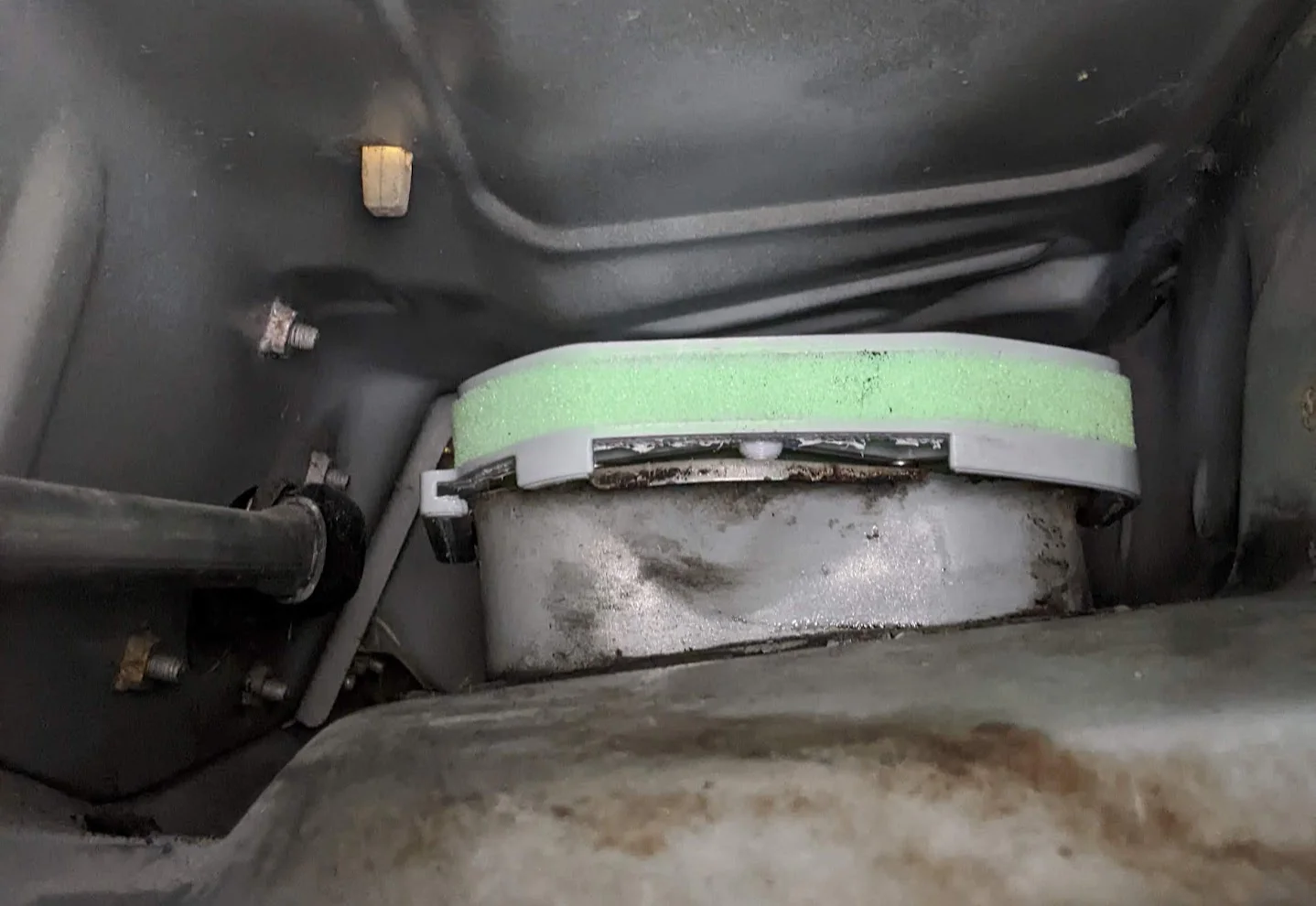

Not sure if this is what @NeverFinis has or not, but this is the only solution I'm aware of that's on the market

Yes that's a Solve Function cabin air filter. I thought it seemed sketchy that there's just a big open hole under the cowl leading into the cabin. You could cover it up with some sort of screen or mesh if you just wanted to keep mice out.
Here's my install on my build thread:
Yes, I have the @Outsane cabin filter to stop mice intrusion. I would make the web pattern top piece a little tighter grid to prevent the little assholes from eating through the foam. I would also add metal mesh as well.
The photo taken from underneath the passenger side of the cowl, looking from the center of the cowl towards the passenger side fender.
This photo shows the cowl hole from below. It connects to the blower of the HVAC.
Here is partial view of the top, before the cabin filter was install. Hard to take a good photo of it. 😜

I can make a version with a metal top...
Hey I literally just bought one of these from you. What does the metal option entail? Any idea of this has a noticeable affect on airflow into the cabin?

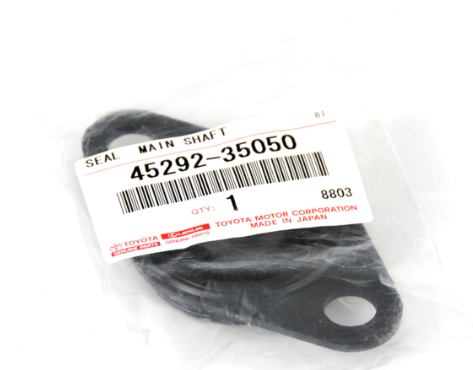

Well, I said I'd post when it was fixed and it's far enough along for an update. Cleaned chewed insulation out of glovebox, heater fan, and heater radiator then used a borescope and mirrors to see where the mice were getting in. I now believe that they DID NOT come in through the windshield wiper cowl or any of those crud filters in that cowling. I think they gained access past the steering shaft seal shown above. My steering shaft seal is completely worn out with plenty of space for a mouse to enter the cabin.
However, once inside you can see how the critters can travel to more places under the dash if the air flap control is left on the outside air setting rather than on cabin air. Especially if the air flap happen to jam when closing on a fat lazy mouse.....
I wrote earlier thought that the air control flap defaulted to the cabin air setting when the key was turned off - but with the mouse body out I can't get that test to repeat consistently & now am thinking the flap just stays in the last position until changed by the dash control.
The new steering seal arrived yesterday & I'm wondering if I can install it easly by taking the rag joint apart in the driver's seat area?? I'm not up for crawling under the car and disconnecting things.
