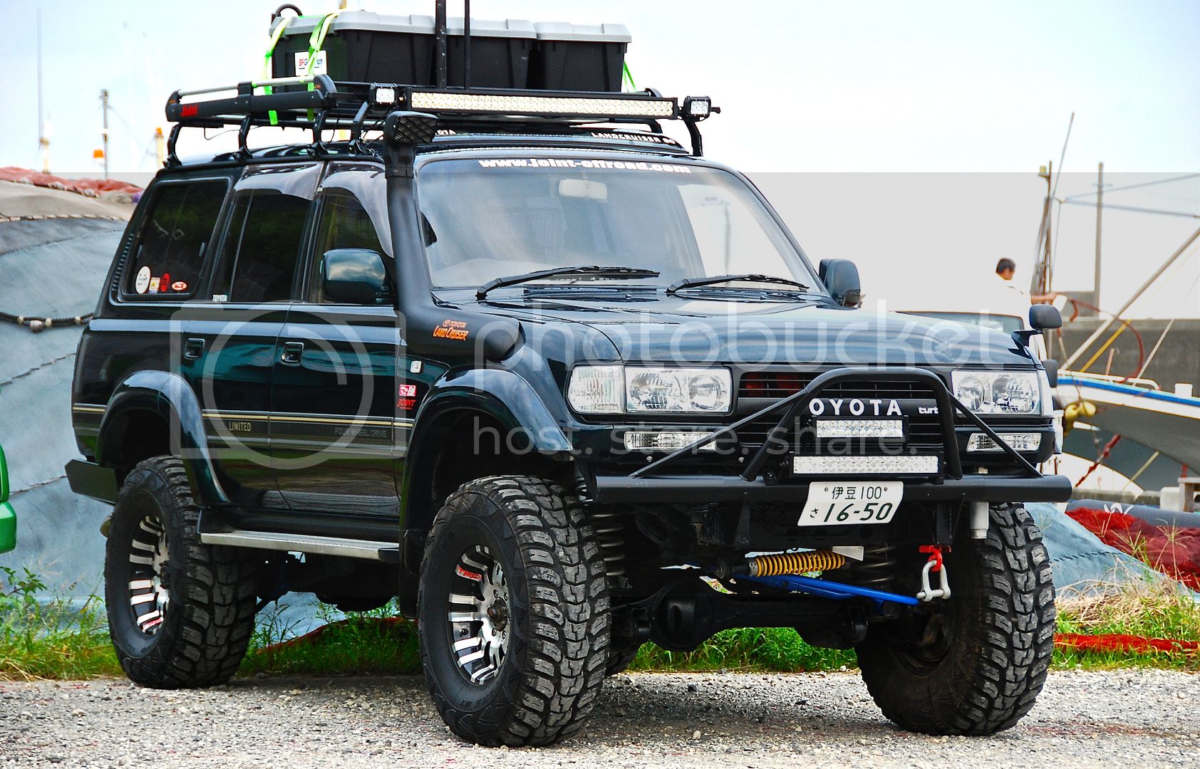

Not much work at all. I have the Slee 4" lift along with their radius arms. Wheels are 17x8 & 4.5" BS and it only rubs a liiiiiiiiiiitle bit on my Slee rear bumper. No cutting needed on mine.
are those actually 37's or the 345's? the 345's are a bit shorter.
