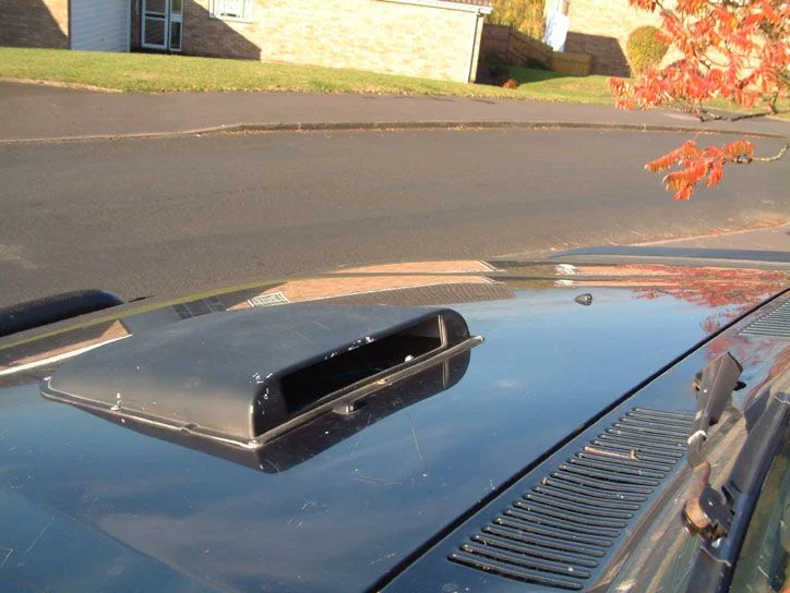

Pics:

Wildsmith,
Nice scoop and a nice rig. I didn't see it on Kenlowe's website, might you have a link for it?
I assume there is a fan in this thing? If so, is there a way for you to see if the it rotates on its own at hwy speeds? Just trying to ascertain if there's a decent amount of air flow coming out of the hood.
Thanks.
I can't see it on Kenlowe's web site either. I phoned them and ordered it after seeing an advert in a UK 4x4 magazine. The scoop & fan was on the same advert as their radiator fans and transmission oil coolers. It has a 10" electric fan under it which I doubt is turned by passing air but has plenty of room for air to flow through it. You cut a 10" round hole, bolt the fan on and fix the scoop over the top. The fan is wired to my radiator fans at the moment but I may get a 2 temp switch and bring this one in first.
wildsmith,
any particular reason it's offset to the drivers side? also does the heat or smell travel into the vent at the base of the windscreen?
thanks
wildsmith,
thanks
It's offset (passenger side in the UK:D) so that I didn't have to cut any of the structural parts of the bonnet. There is sometimes a hot oil smell but I suspect if I cleaned the oil I spilt off the engine it wouldn't be a problem, just haven't got round to it. With the scoop fitted my electric fans don't come on as often but when they do if you put you hand by the scoop opening it's like using one of those hot air hand dryers.

Dang it...thanks guys. Just when I had foregone the thought of cutting a hole in my hood for an air evacuator of some sort ( I prefer the louvres and Kenlowe) you guys go and get me all riled up about it again:flipoff2:. I love the louvres BTW. The Kenlowe looks sweet and thats awesome it comes with a fan.:cheers:
That is one sick ride, BTW, wildsmith...
