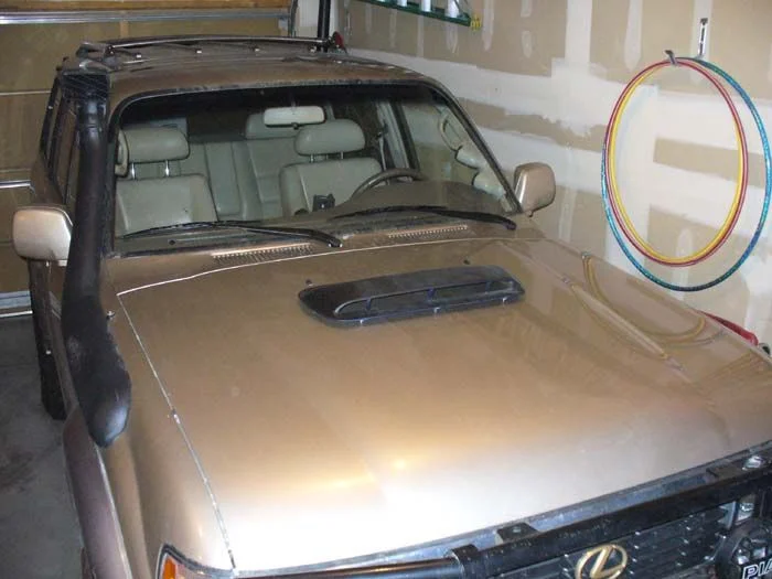

That's the effect I'm hoping for withe the combo. I figure the clutch fan forces air through the engine compartment and in the factory configuration, it goes out through the bottom of the bay. With my setup some goes out through the top (where the highest concentration of hot air would be). With the addition of the scoop, I'll hopefully just be moving more air and allowing less heating of the engine bay. The IC, if it works out will lower intake temps.
Those parts on the floor are inventory for the never complete punchlist...

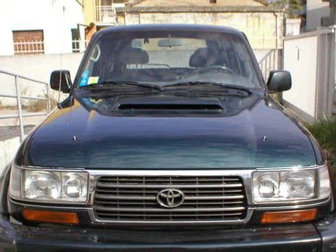

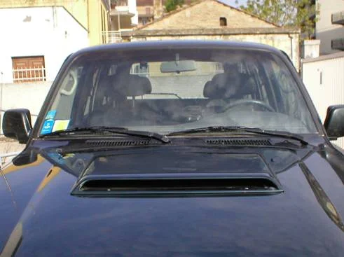

this is mine, toy hdj80+intercooler. Hood scoop cames from ISUZU TROOPER 2.8 TD.

After looking high & low for this hood scoop, I finally figured out the exact details. It came off of a 1988 Isuzu Trooper/Bighorn 2.8 TD. They're available used down under (Australia & New Zealand, where these Isuzus are pretty popular), and there's a guy here on the West Coast who's replicating them for a pretty darn good price too, if anyone's interested.

You know I never installed the hood scoop I bought, maybe I should sell it :D
