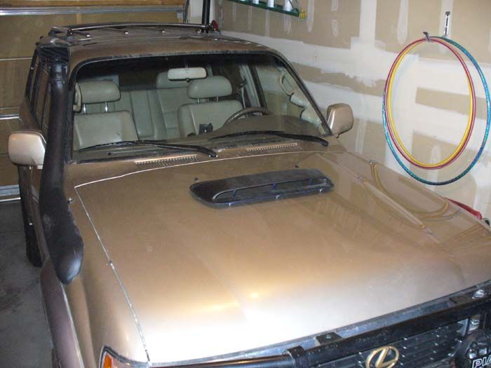

Here are a few of mine with a Subaru scoop... it provides air for my intercooler..
attachment.php
I thought for sure it would look stupid but it looks fine! maybe it would stick out more on a light colored truck but nice work :beer:
The funny thing is that it looks better on an 80 than the Subaru it came of of.. he he
As for hood shake, I had none and still have none..

Got my $20 hood scoop from ebay. Was thinking of painting it, but I think I like it the way it is. Goes with the snorkel. Now all I have to do is either get the courage to cut the hood or hopefully find someone with more skills in this area to either hire or help :D
