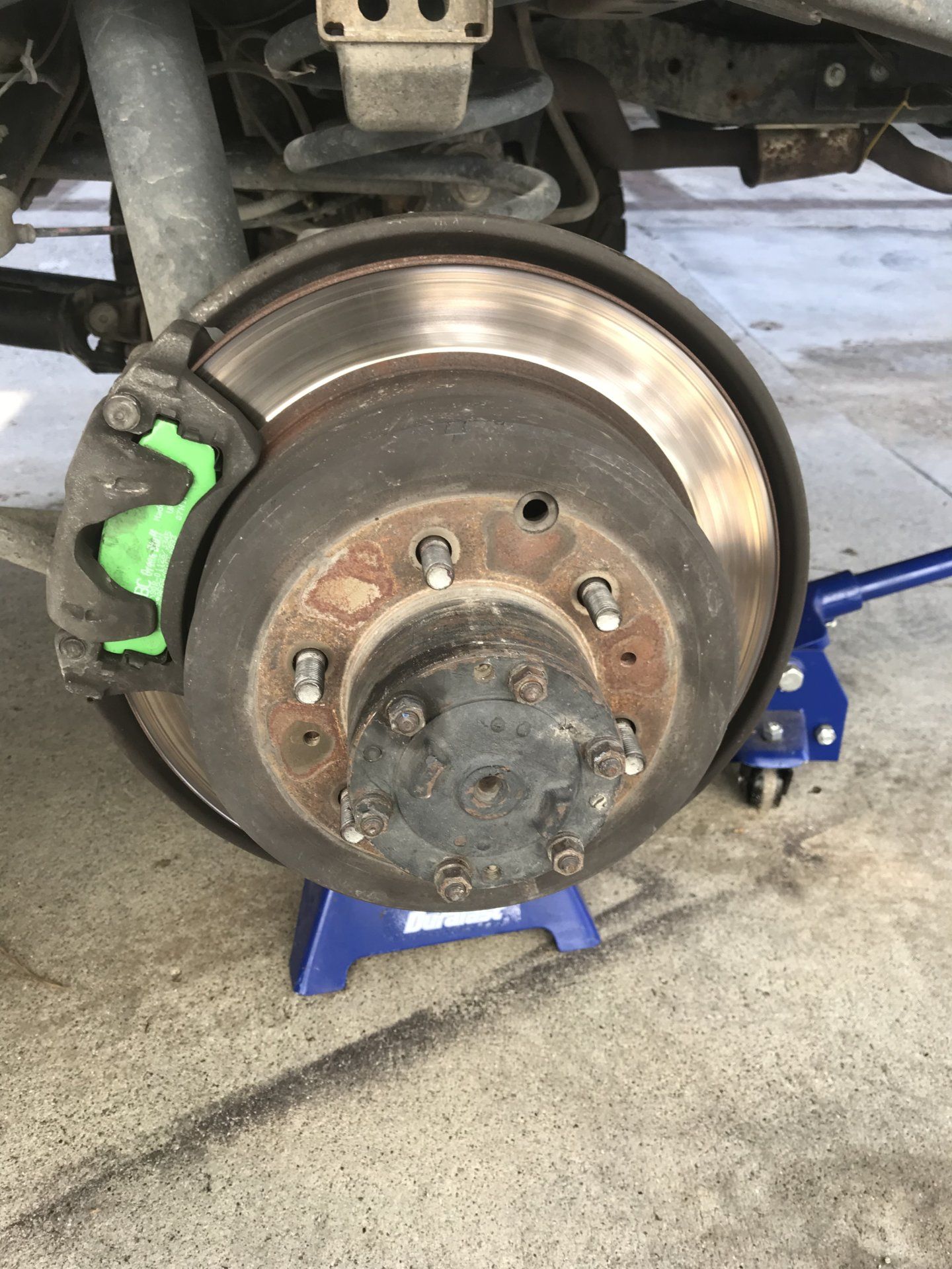

Parking lot brake job in mammoth around 205K miles - only got around 25K miles out of the front EBC 7000 i had on - the rears needed doing a month later......

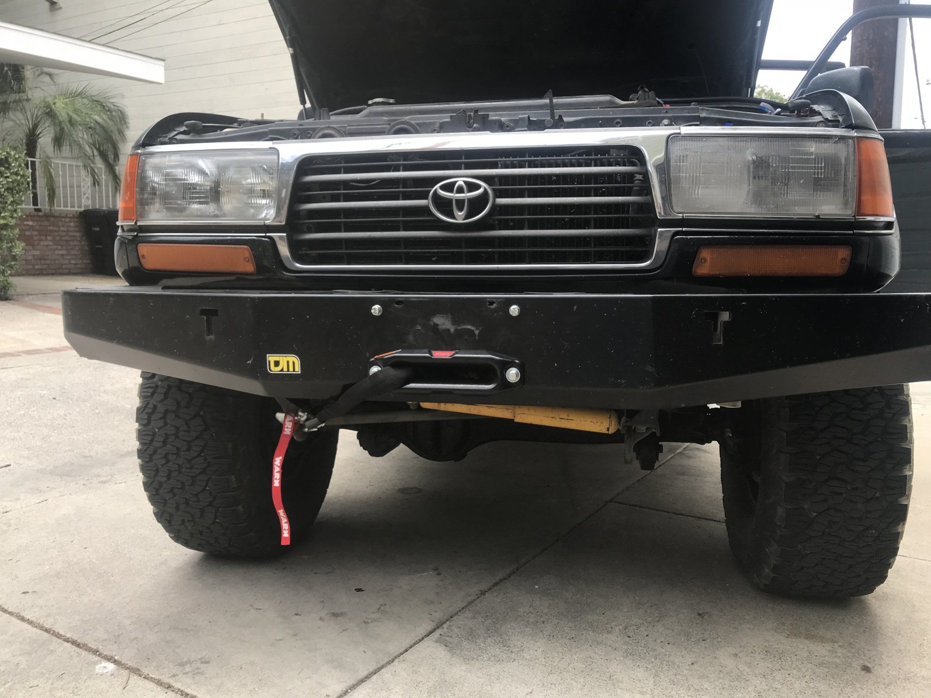

Been a while but....Winch!
Finally installed!
Never needed one, probably never will, was probably a silly buy but if I was following logic here I would probably never have bought the 80 in the first place!
Warn - why do you not supply black bolts!

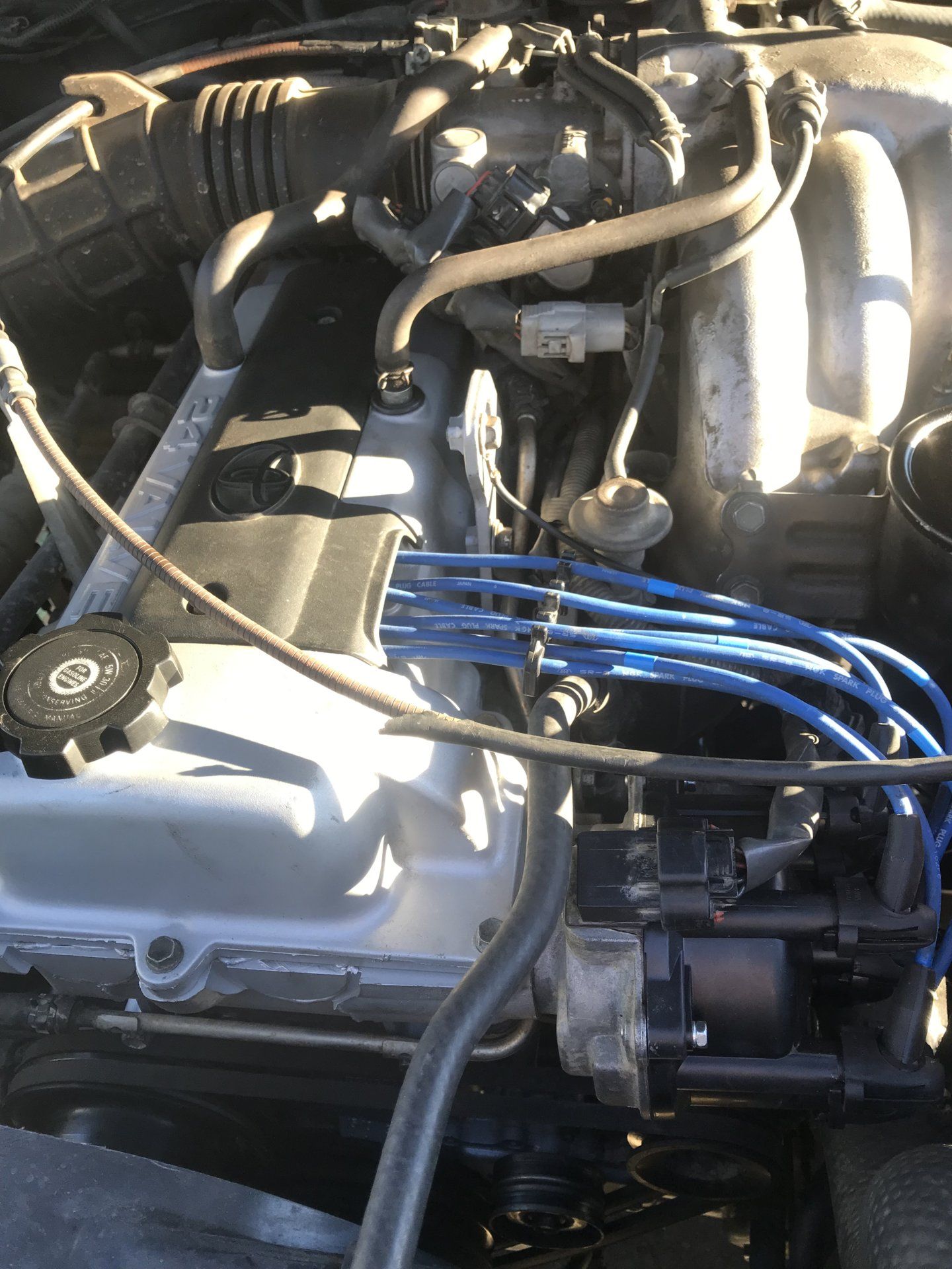

Compete engine rebuild - from bottom up.
New steering box, cap and rotors, water pump - the list goes on...

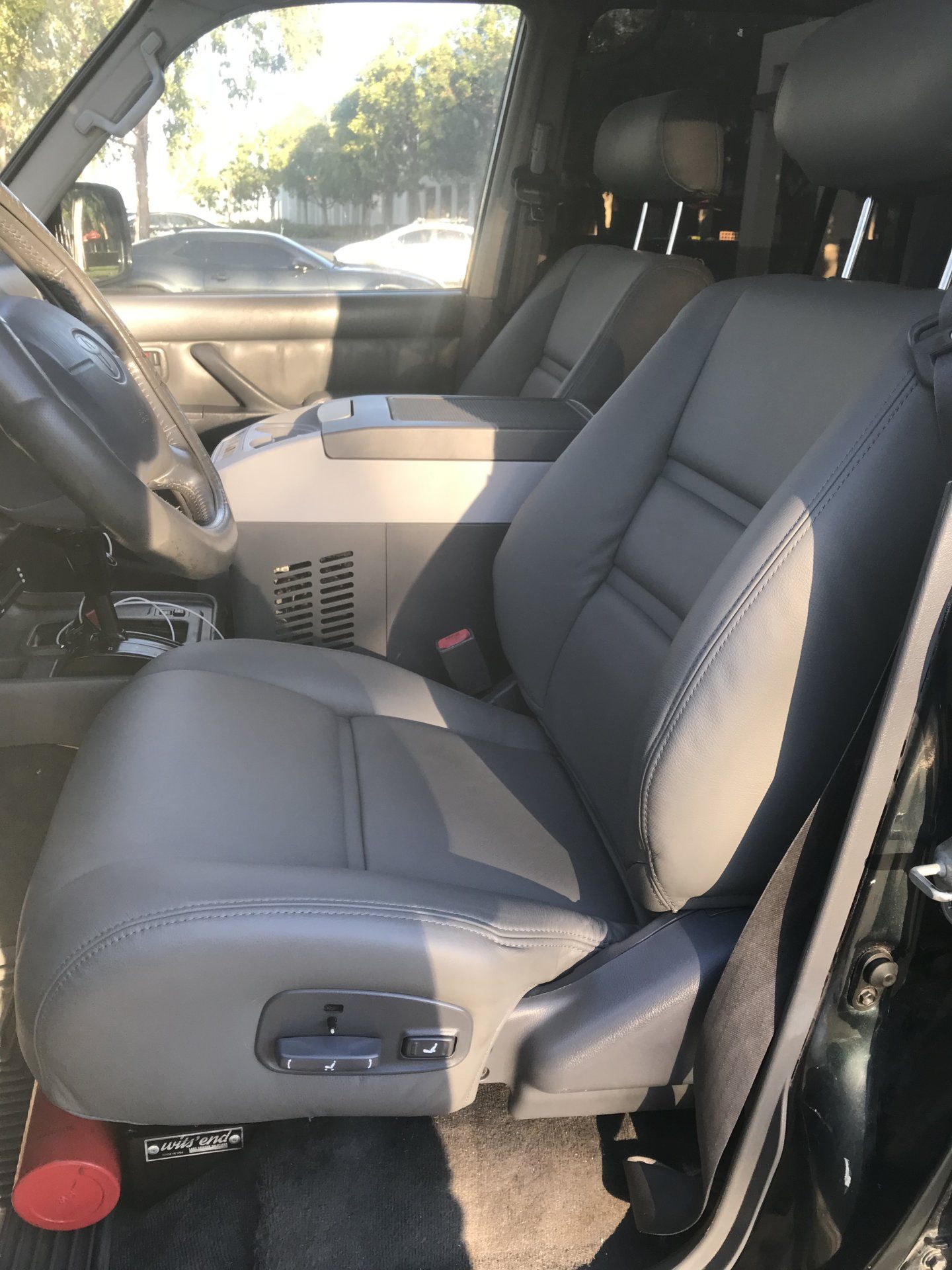

Finally got the new leathers installed from landcruiser heaven - they look and feel great - also replaced driver seat foam.

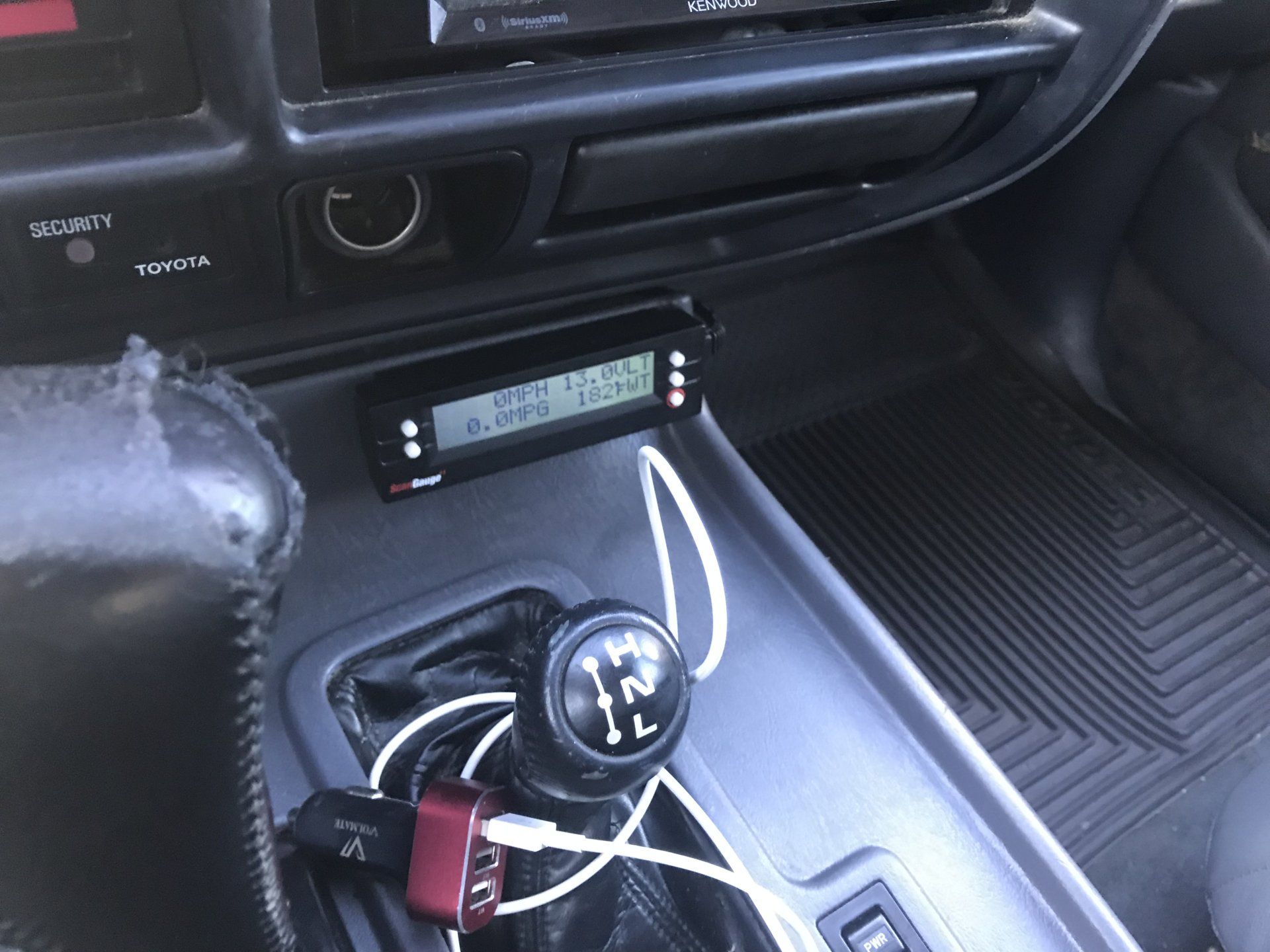

Scangauge installed!m
Thanks as always to @beno for parts - more to be placed sir!

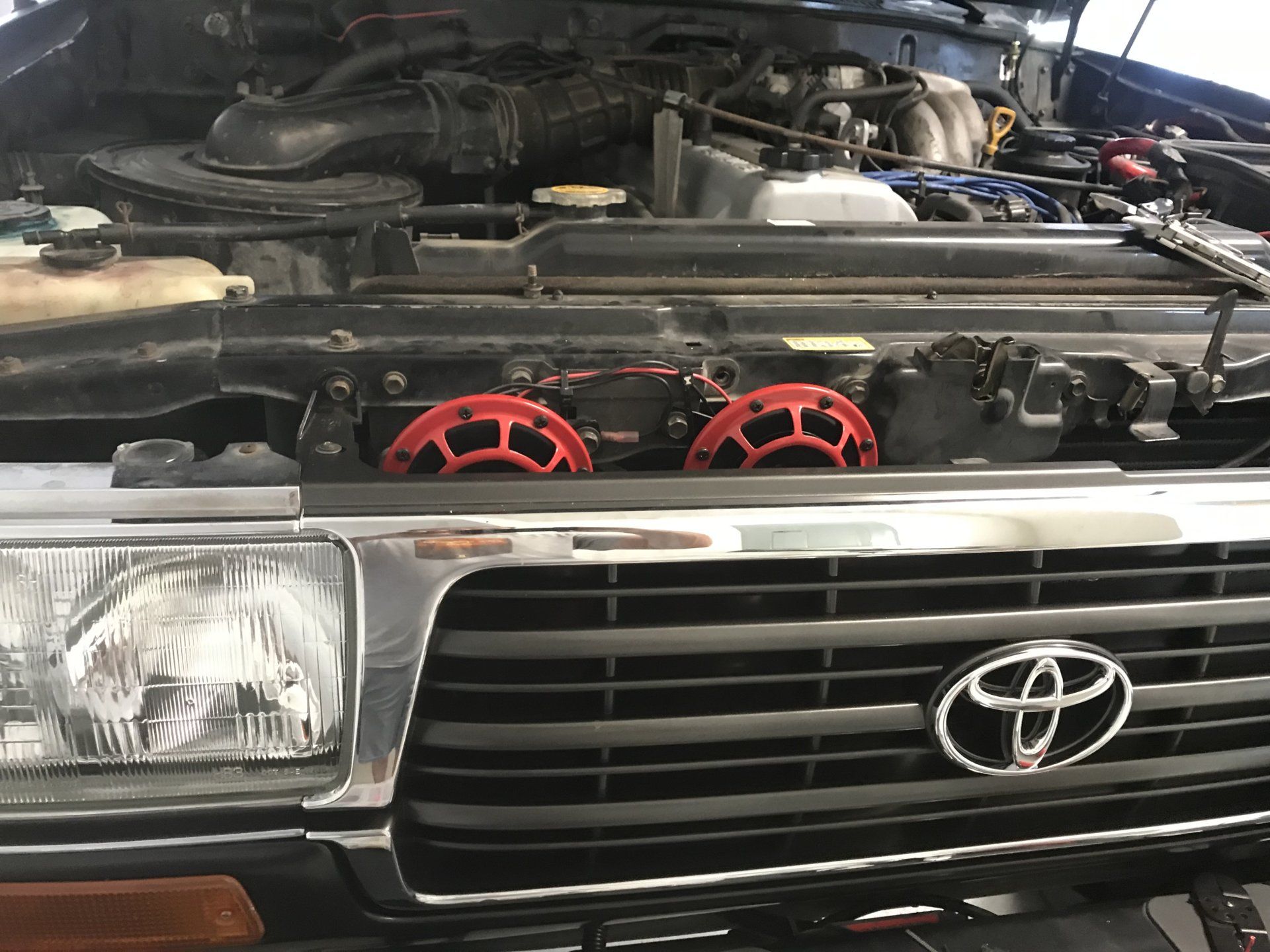

Some more minor stuff - new rear brake pads, new hella horns, replaced the headlights, front grill and valance and trued them all up to get them all flush - correcting some minor damages from a minor fender bender 4 years ago!
Turns out the front grill was fine - I have a spare - Check the classifieds!

Question for you. Did you also install the relay with the new horn? If so, was it super complicated?
Thanks in advance!
Paint job soon......
View attachment 1856075 View attachment 1856074
Great thread.
Thanks in advance!
Thanks and no on the relay - just spliced in the horns right at the factory wiring near to the speakers - used the stock relay. Really simple install!

New front brake pads

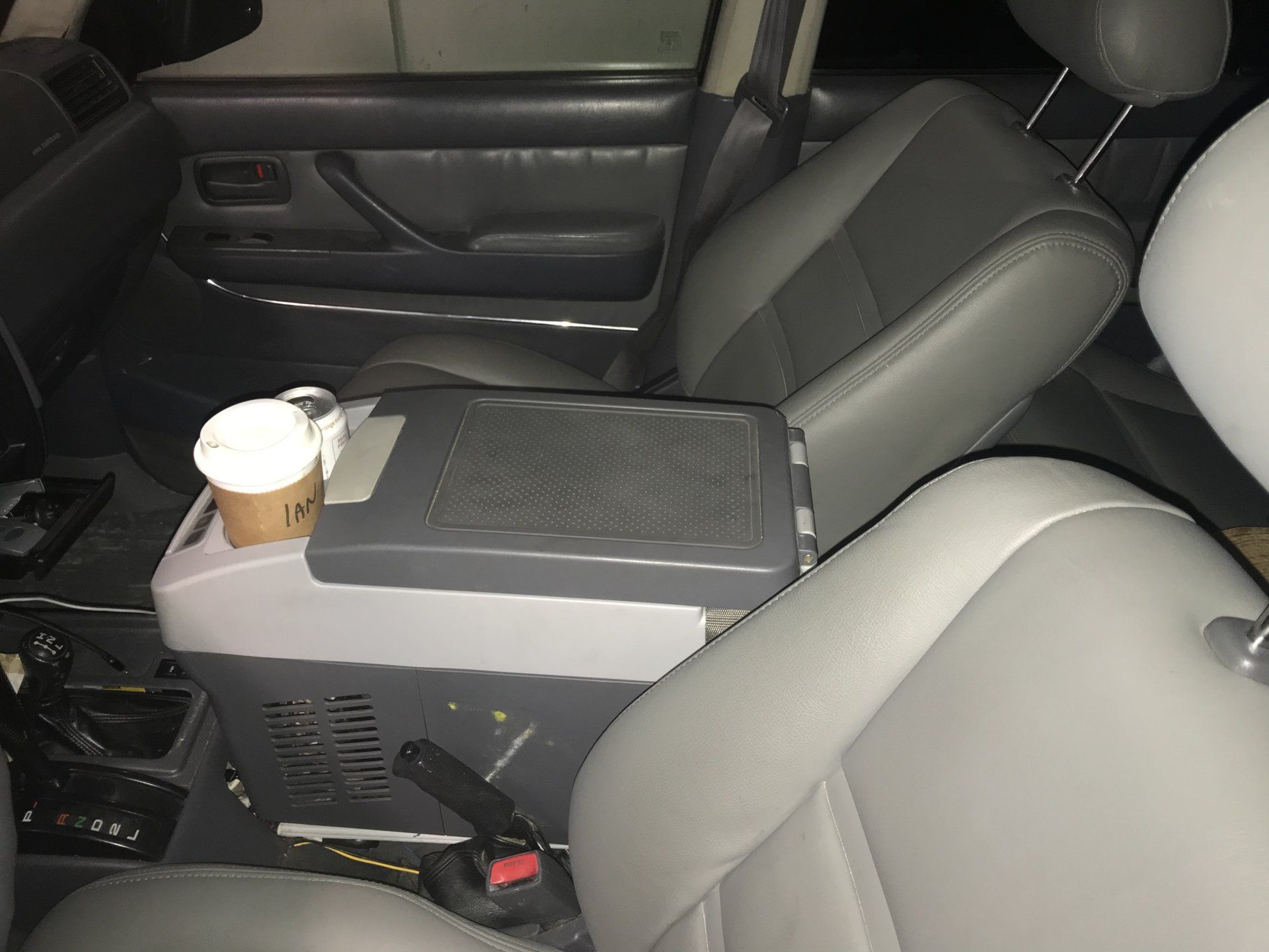

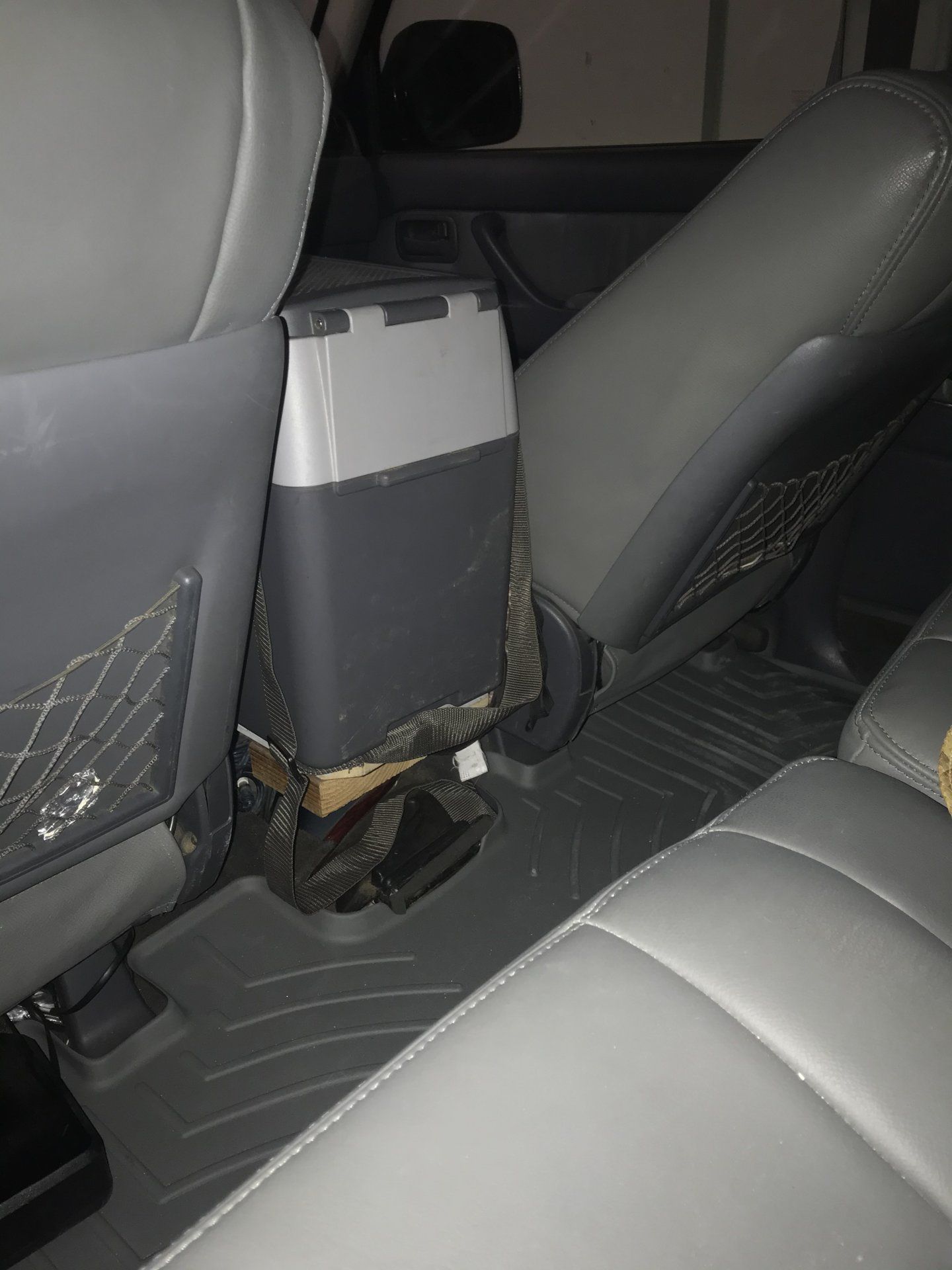

I'd like to see some more pictures of how that fridge looks between the seats.
here you go - light not brilliant - can get more later if needed
you have to angle it slightly toward the passenger seat so to get access to the handbrake and shift down into low
still need to anchor securely in place...on the to do list
Can you do a review of the EBC green disc brake pads? Do you use them front and rear? Do you use 80 vs the larger 100 series front pads? How do they compare to OEM pads?
