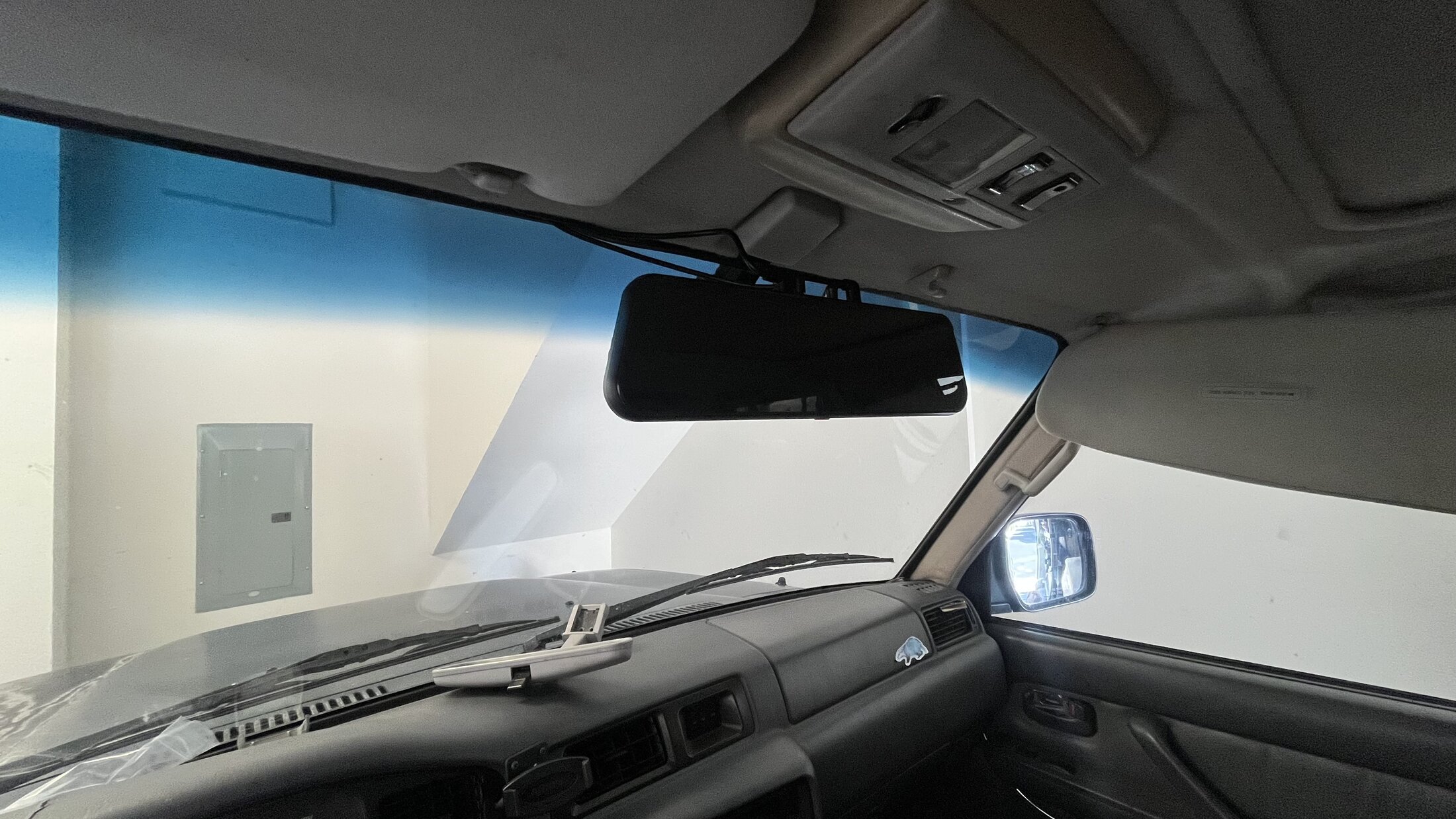

wolfbox g900 tri cam setup - front just near to my winch. Wired my rear after popping it through the firewall at the front and wiring it under the car to avoid having to rip out all the trim. One thing I do is often have a bike rack on which can block part of the view so I found some magnets and glued that to the base of the camera - now allows me to easily move the rearview cam to a few locations - works great I just need to get one of the those super strong magnets but I think its going to work. Got the deltaVS rear view camera mount so will post up when I figure how to mount that - supposed to be simple!

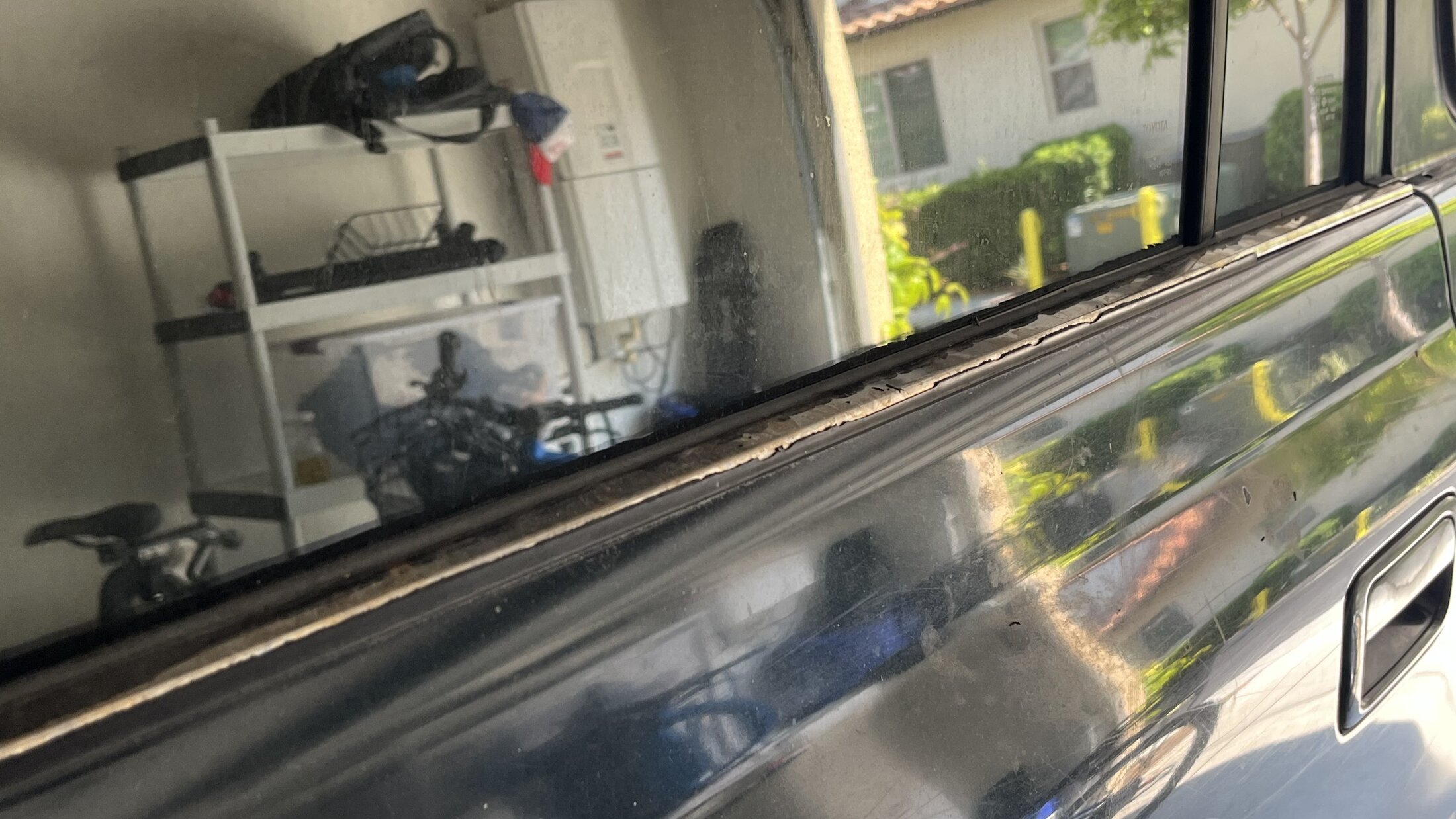

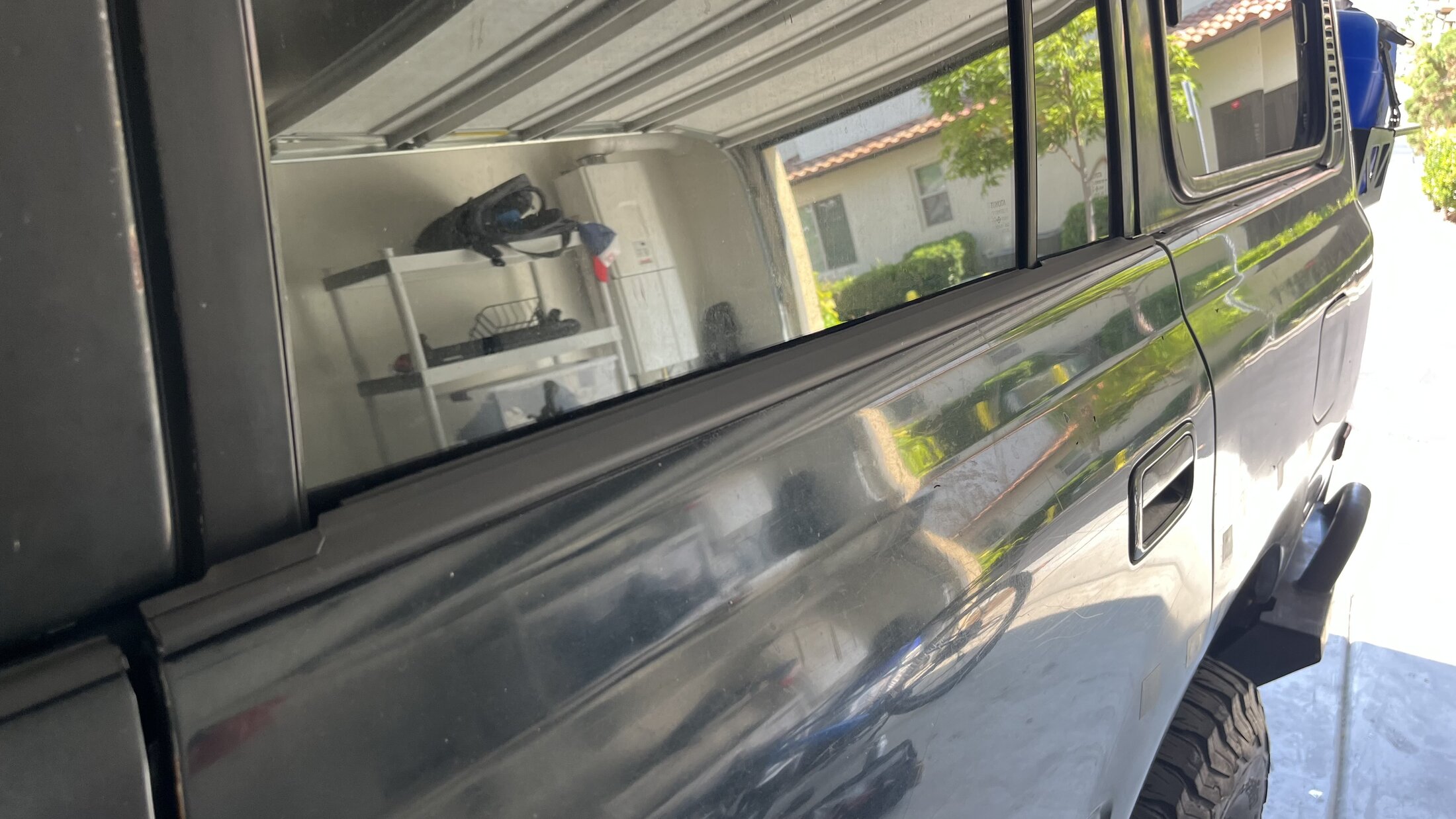

The plastic window trim - been looking nasty for a while - found some cheap replacements on eBay. Look pretty decent - will have to rattle can the rear strip for some reason they are silver - 70 bucks
Old original
New eBay replacements

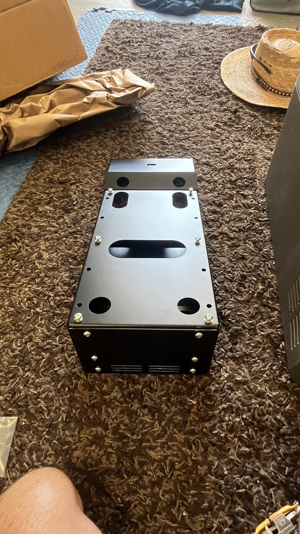

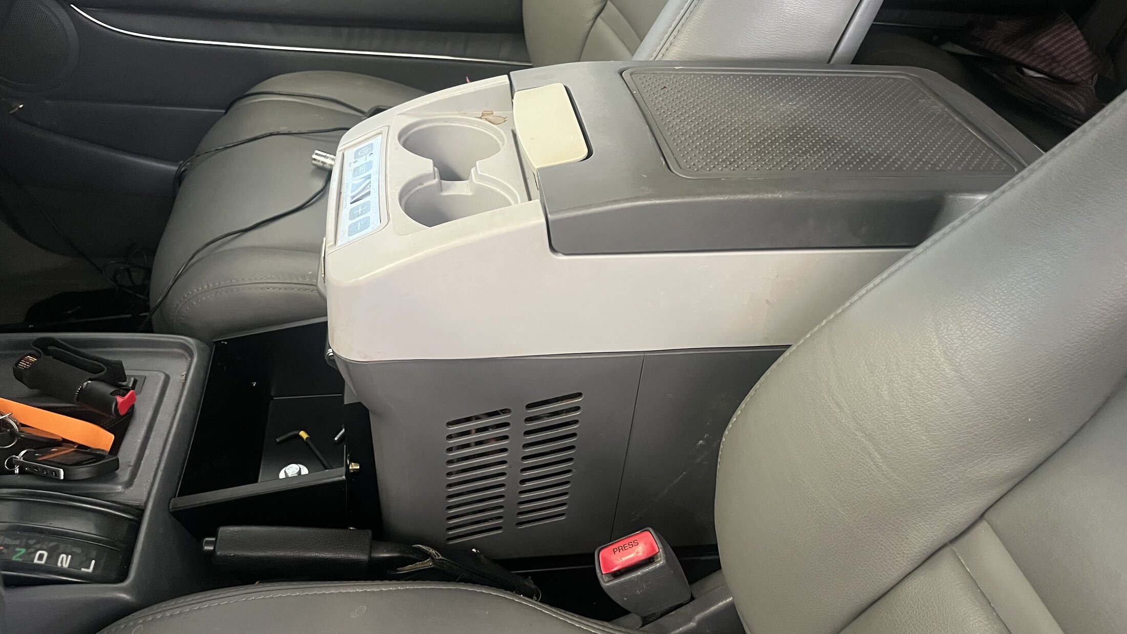

Figured it was time to upgrade my attempt at a center console shelf for my dometic center console fridge
Not the safest thing in the world - happy to discover deltaVS build a platform and a fridge mount!
Major upgrade!

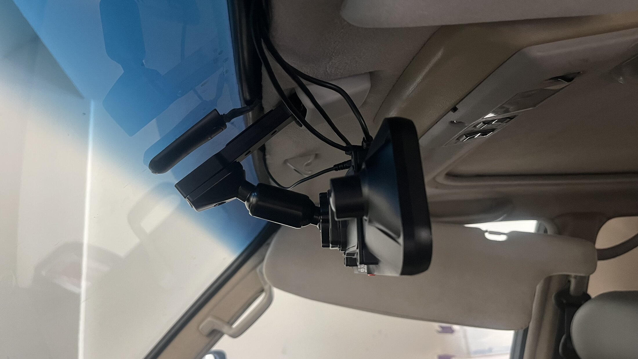

Also got the deltas VS rear view camera mount - needed the wolfbox adapter kit as well - 20 bucks from Amazon
This is a side view with the mirror pulled forward - normally sits way closer to the windshield
