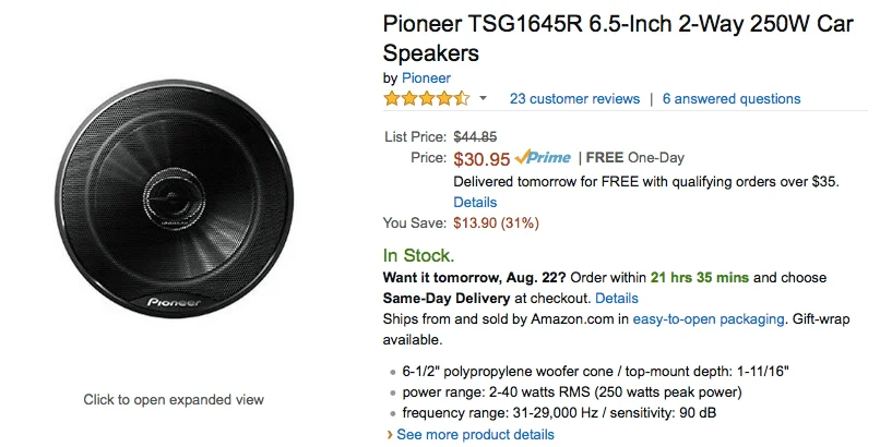

rears - cut off the back brackets of OEM and glued these rear speakers into the plastic frame - OEM grills cover just fine

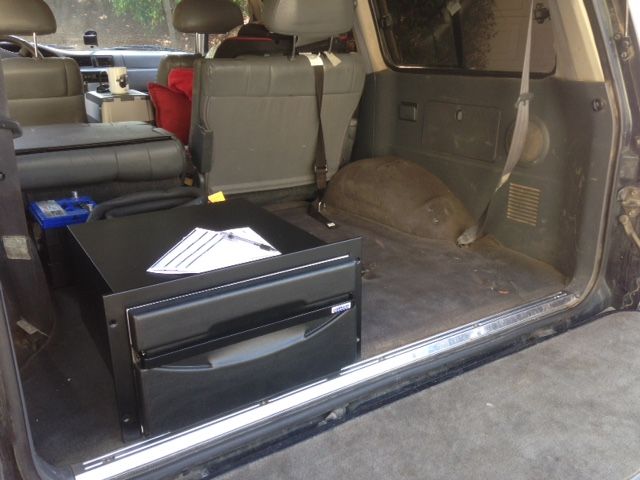

Replaced center console with dometic cdf11 - plan to use as freezer and have a rear pull out fridge when rear shelf system is installed.
This is a great fridge/freezer - ultra quiet and gets to temperature super quick.
Also solves the cup holder conundrum and you get an armrest out of it!

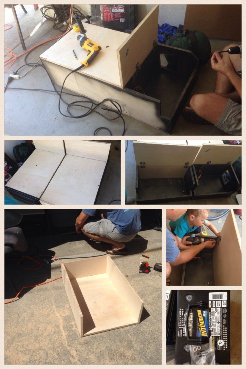

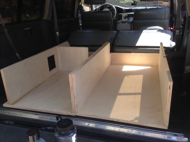

start of rear shelf system - idea is to have a pull out fridge on the left that will remain permanent - then to have another shelf to the right that has the option of being removed.
At the rear of the fridge will be the compressor - building ventilation into the design here - behind this will be the battery setup.
fridge
vent holes for compressor - also a channel out the backl - nice thing about this fridge is the abilty to be able to remote mount the compressor if this design doesnt work out.
next steps - work on the tops and get the dual battery system in!

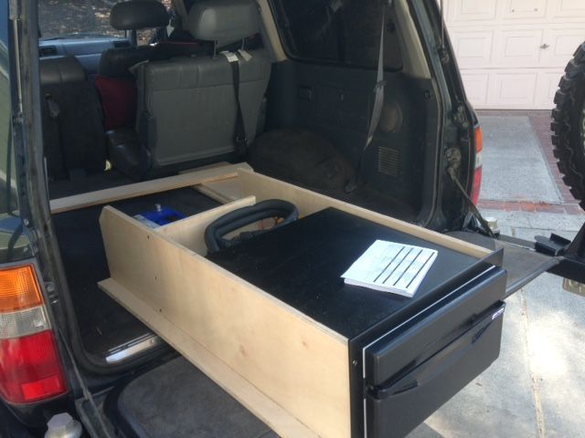

More drawer build - picked up two of the intimidator batteries - should provide 40ish hours of use with no charge....hopefully
fridge
OK, sorry for my ignorance, but that black thing as a refrigerator?
yeah i think it'll work for my intended purposes - its actually meant for a boat - hoping that in combination with the center console freezer to be rid of the need for a cooler - if not I'll remove it and sell it on!

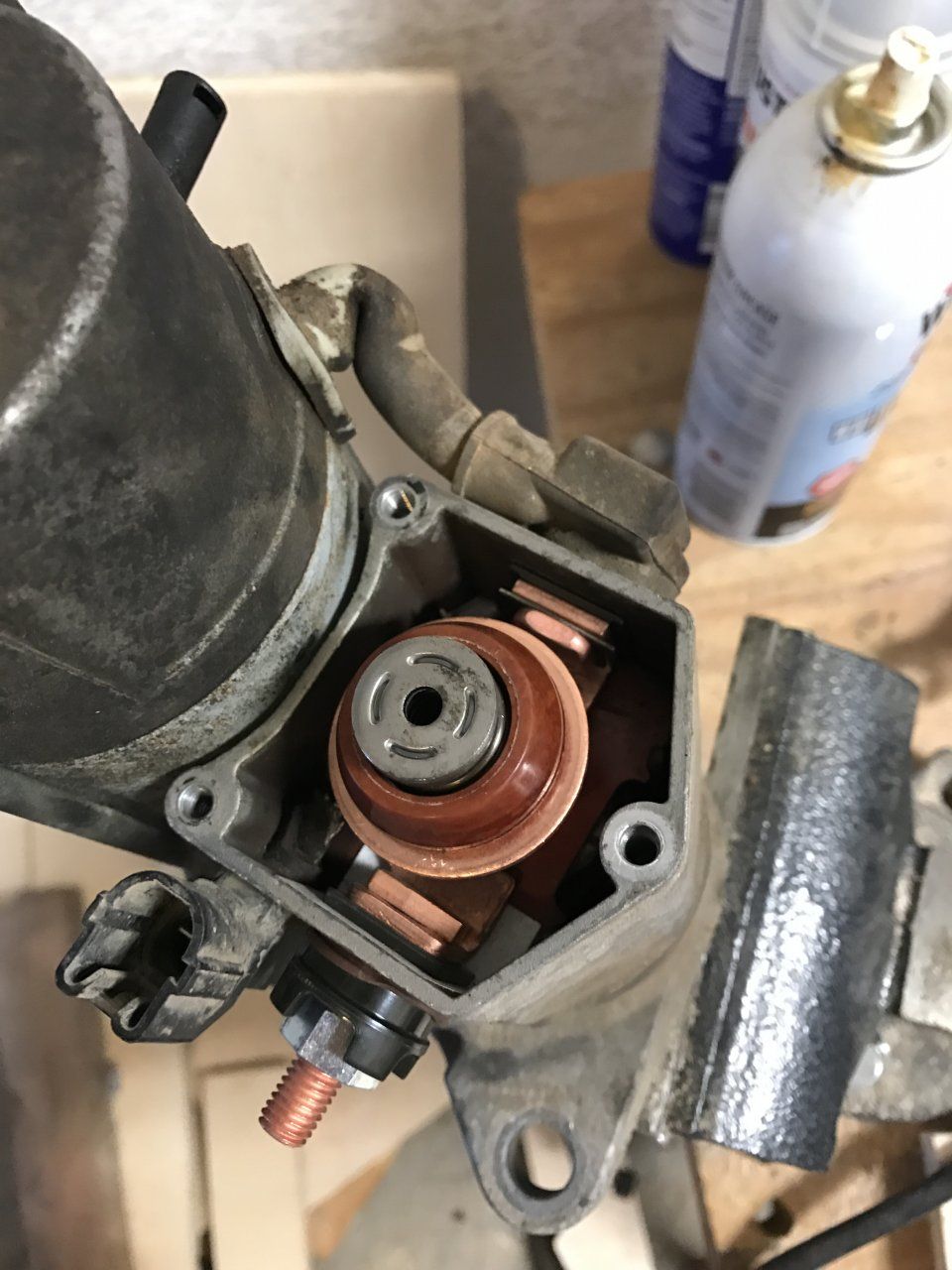

Rebuilt starter after this was happening....very straightforward thanks to mud...
starter engaging after engine starts

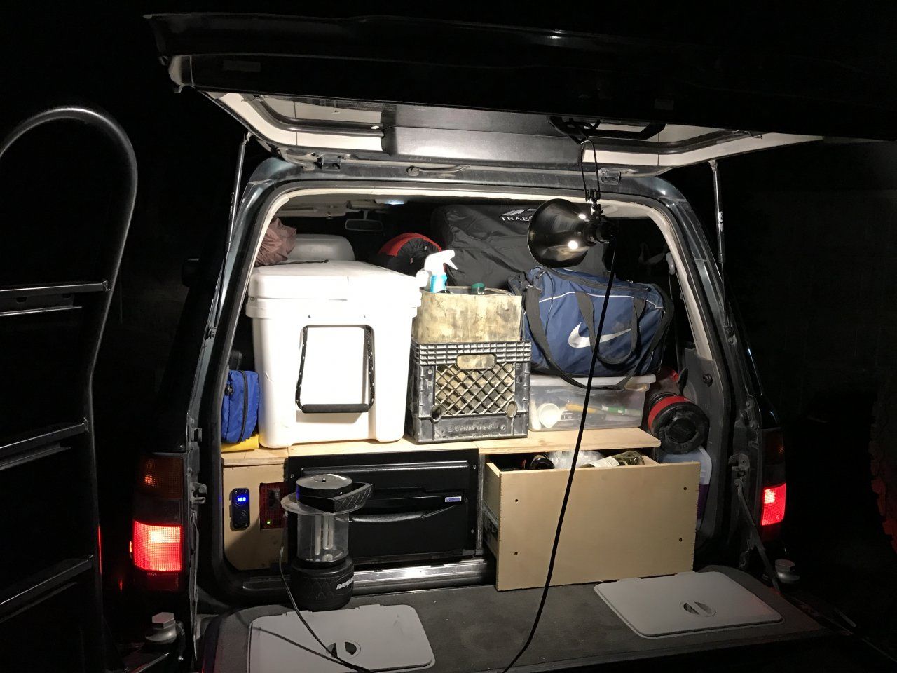

Rear drawer system with pull out fridge nearing completion!
Nice build! I like the tiny fridge and think i will looking into one. What size is your Yeti? I have the 35 and 75. I'm very impressed with them.
Thanks! The yeti is the largest one you can get - borrowed from a buddy - and simply no comparison with any other cooler out there imo - in terms of quality and price!!!
Along with the center console freezer and pull out fridge at the back am hoping to get rid of the need for a cooler altogether....
Currently have plans for mounting a 200W solar panel on a pull out rack mounted underneath the roof rack that will pull over the windshield on telescopic legs to enable angling toward sunlight..... mulling around my brain anyhow!
