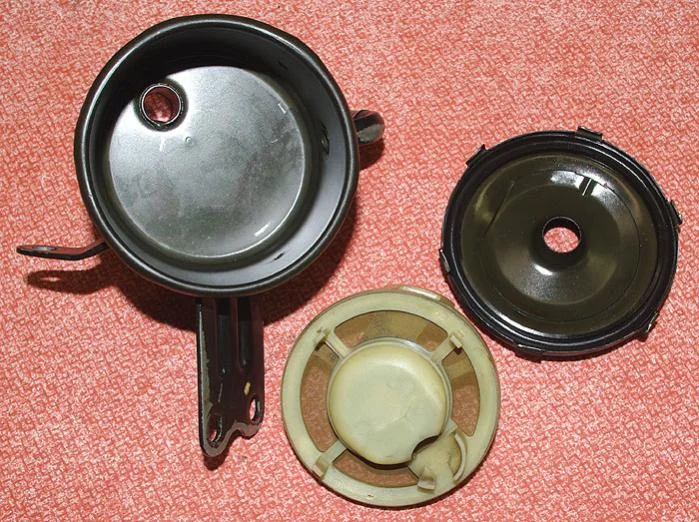

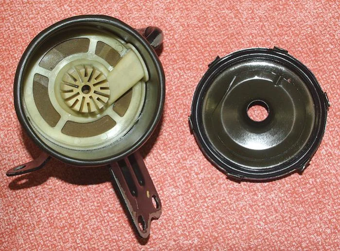

What do you mean "pry the top off the reservoir"? Is it removable? Mine weeps a bit and it would be cool if I could just change a gasket.
The reservoir is not considered "serviceable" no parts are available. That said, if you are careful, they can be serviced. The top is held on by tabs that are bent over the rim of the base, carefully pry them up and it comes off. The screen assembly is held in by dents in the side of the can, flatten them out with a punch from the inside, note/mark the rotation position and remove it.
Clean everything, put the screen back in position, redo the dents with a center punch to hold it. Clean the can rim and gasket in the top oil residue free. Apply a skin coat of RTV to the can rim, put it on and carefully re-crimp the tabs with pliers.
