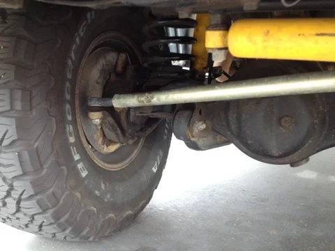

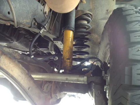

A while back we were trying to get the steering tightened up - a little too much play for our liking. Figured it'd be nice to be able to turn the steering wheel knowing that the wheels would reliably follow suit! First things first - bunch of new bushings ordered from Beno - Ended up paying a shop far too much money to press in new panhard bushings, Frame side front control arm bushings and new sway bar bushings.
New OEM Tie rod and relay rod ends to go with new tie rod and drag link from Slee - all about 182K miles.
what made the most difference in 'tightening up' the steering was making sure the front wheel bearings were tight to spec......
Also - finally got around to installing the rear adjustable panhard from slee. On the last off road trip there was a huge 'clanging' coming from the back of the truck like something was really loose. Got under there and really tried to shake thing loose - nothing - everything seemed 'tight'. After installing the adjustable panhard to correct the axle shift following the OME lift - clunking has gone away.....go figure

If i remember correctly - the axle was shifted about 1/2 inch after the lift - but I could be wrong - it was definitely noticeable by eye when you stood behind the LC that the axle was shifted right. So just visually corrected for that with the adjustable panhard- when the rear swing out bumper goes this will have to get double checked......
