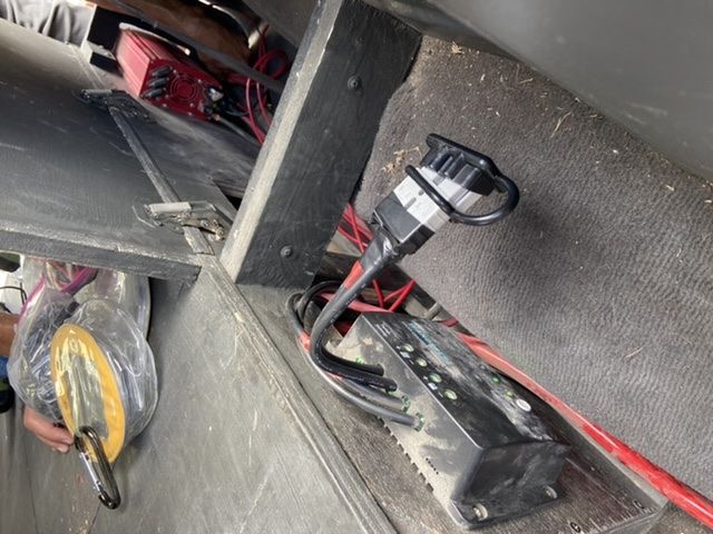

Installed 2 key switches to be able to turn the fridge and water pump on/of without pulling the fuses - so apparently according to isotherm you shouldn’t turn the fridge on and off using thermostat in the fridge....go figure.
installed a quick connext for solar pane wiring.
also - mounted a water pump to feed a camplux water propane heater to be able to have hot showers ‘out there’

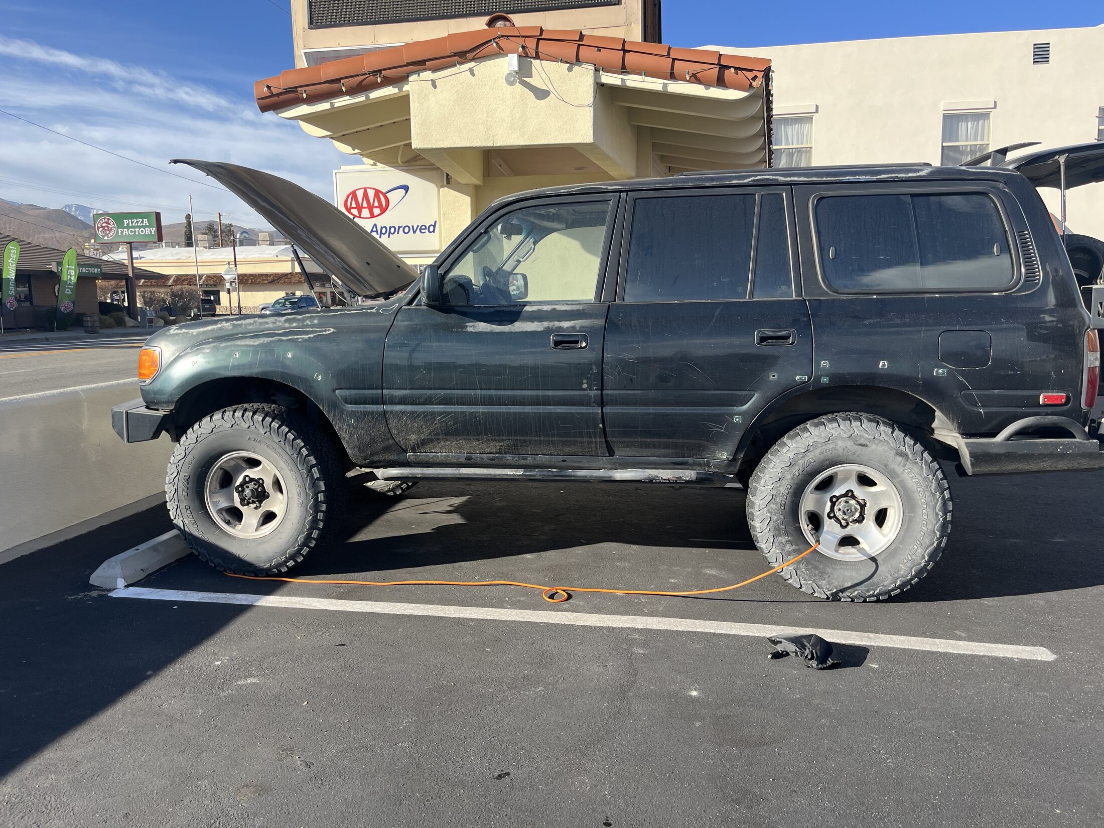

New front and rear pads at 232k.
Time to Regear to 4.88 - running 35’s - any heads up on mud vendors I can support I’d appreciate the link - haven’t got into the research side of things yet.
I have a local shop to do the work in SoCal (Orange County) - alway like pushing money to mud vendors if possible though!

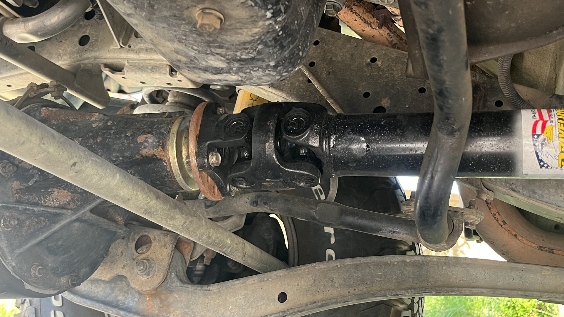

Eventually regeared to 488’s in summer 2022 for proper fit with 35’s and also finally got one of these below - February ish 2023 - no more driveline growl
I thought the DC was supposed to go at the Transfer Case end. Or doesn't it matter?
Please correct me if I'm wrong.
You are correct. The slip joint is supposed to be towards the 3rd member in the front.
Hmmmm - that is in the works…. I did this after I regeared - growl and vibrations that were there after I switched to 35’s got so much worse……now totally gone after this……The u joints that were in this were only a few years old.
Kinda at the limit of my knowledge on the mechanics when I got this done - will consult here in future as I used too first…. But the car drives orders of magnitude better so 🤷🏻‍♂️

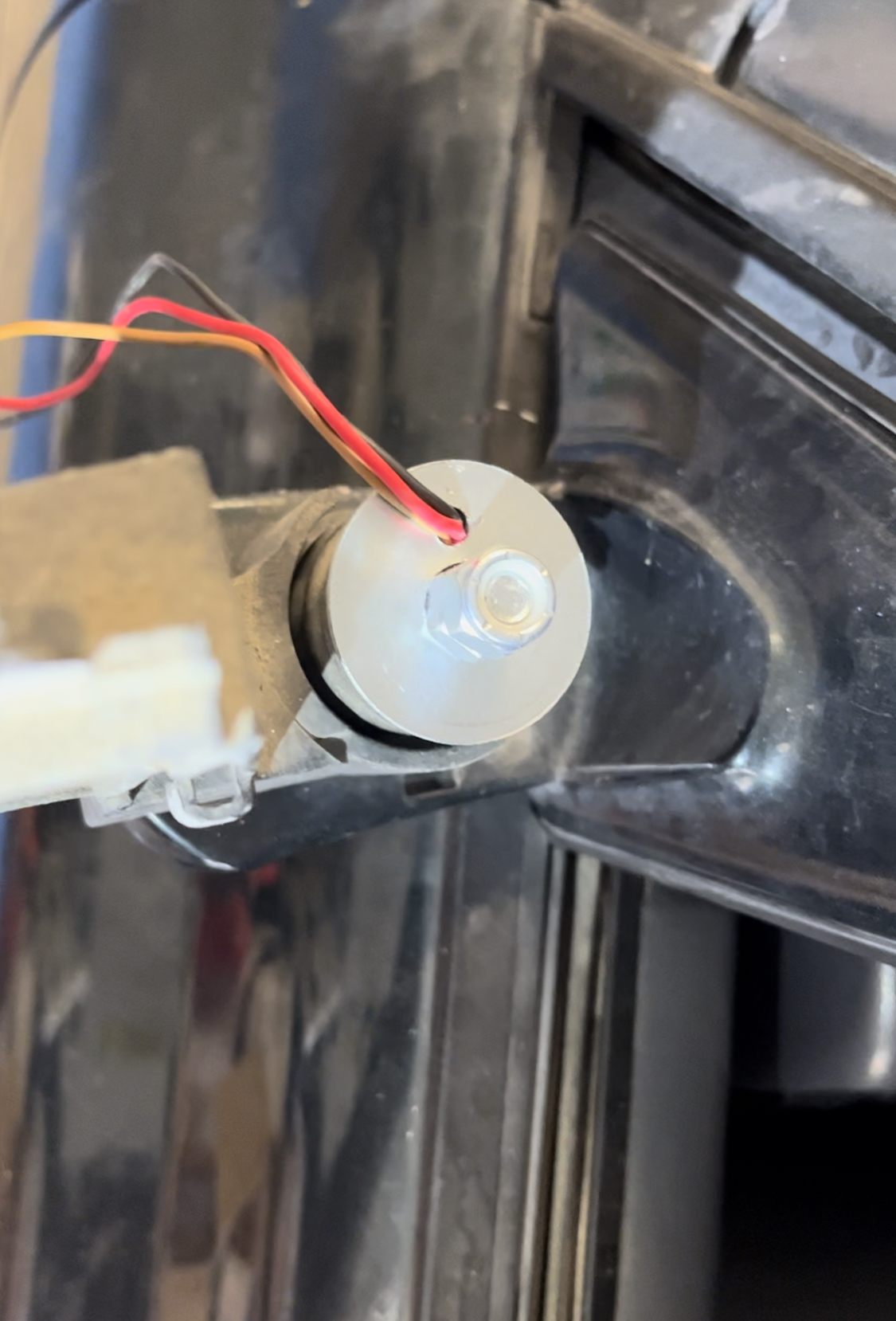

from shaky mirror to shaky entire wing mirror - fixed!
Thanks to this thread below….
Saved me 500 if bought new…
Replaced fusible links hoping this solves battery drain issue, trying a 3D printed fix for shaky mirror syndrome and and replaced tire swing out carrier bearings

so getting around to taking care of a largely neglected truck for the past few years in prep for a 5000 mile road trip in September - @Rusty Marlin and @OffRoadScott you both mentioned the DC should have bene oriented to the transfer case and checking out this video as well below it seems that might be the case - this is beyond my mechanical knowledge (and still learning here) but as i'm understanding it the greatest variation of angle (and then driveline growl noise culprit) is at the TC - so thats where the DC should located - slip joint should be oriented towards the front diff in this picture....
So hopefully this is a simple shop fix.......
Yes, just flip that driveline end for end and bolt it back on. It runs best when there is a 90 degree angle formed between the driveline tube and differential companion flange. 1 degree of deviation is usually not a problem. If this be the case at the differential end then the DC joint will automatically split the angle at the transfer case end perfectly between its two U-joints allowing the shaft to spin free of vibrations.
so something I can do myself? looks pretty straight forward if so?
