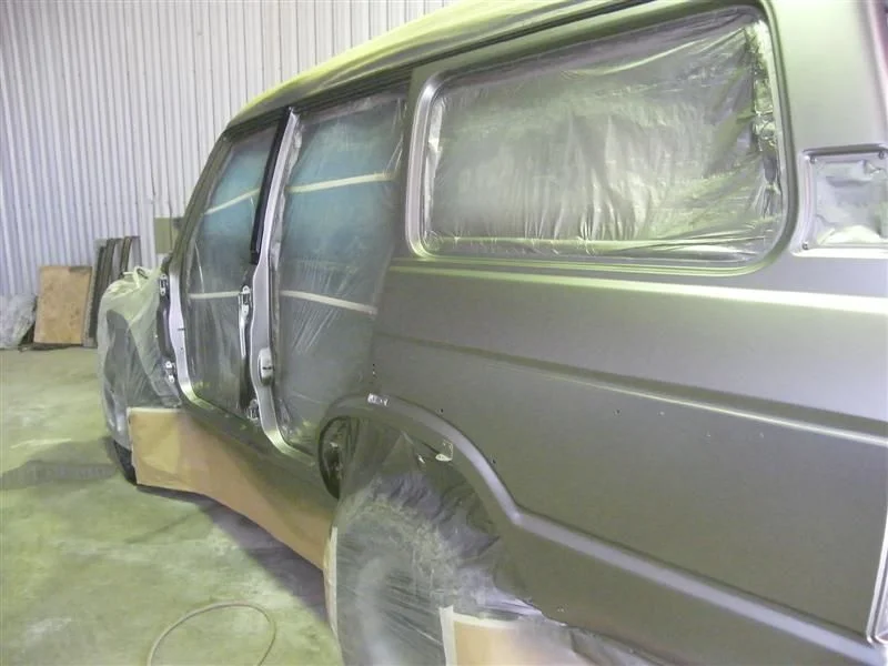

I did the repairs etc trapper then blocked it off with 240 wet where i could,i went dry on the roof as the gutters were bare,then 600 wet to finish,scotch brite mainly on the jams/tight spots.
A mate of mine is doing the painting.

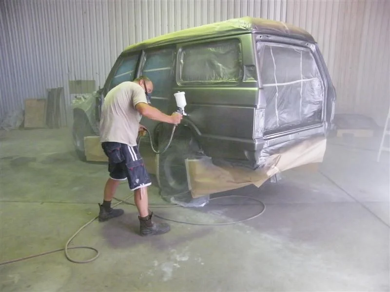

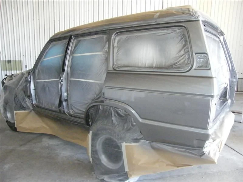

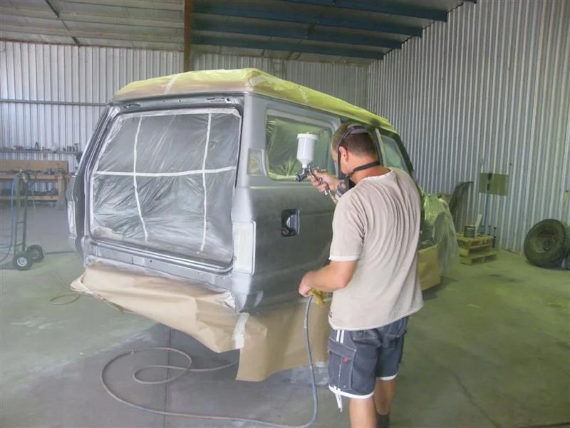

Got the rest of the body done today.
1st shot is light coat.
2nd is 3rd coat.
3rd is bubble(craig)starting the clear coats.

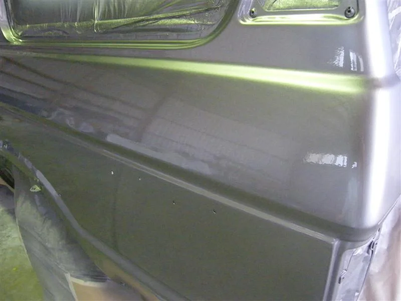

Finished job,it looks good but this shed and the camera don't get along.
Im keen to get it outside,it'll look completly different,but that will be a couple of weeks.
Man im glad im up to this stage,its been alot of repetetive work the last few weeks,now the fun begins.

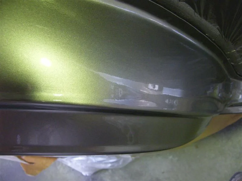

We are lightly buffing the rear quarters this morning,a couple of small runs in the clear so buble wants to fix them up before the paint gets to hard.

From what I could tell, the roof's already done...
I was harrassing him to paint it white though...;p
It's definitely masked off in the pictures above, unless my eyes are deceiving me.
...and post 58 looks like a freshly painted silver roof...;)

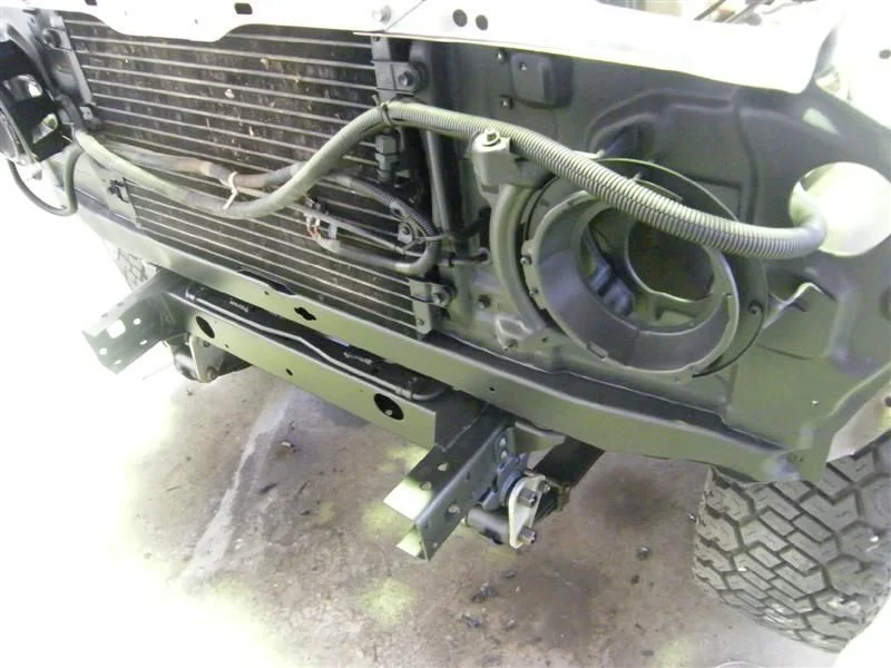

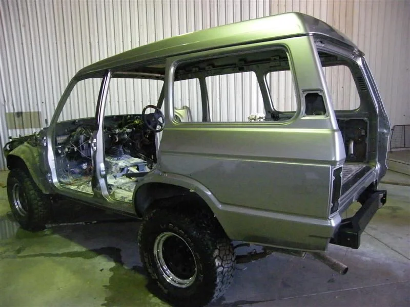

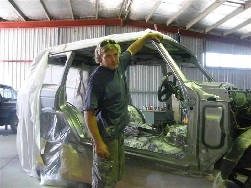

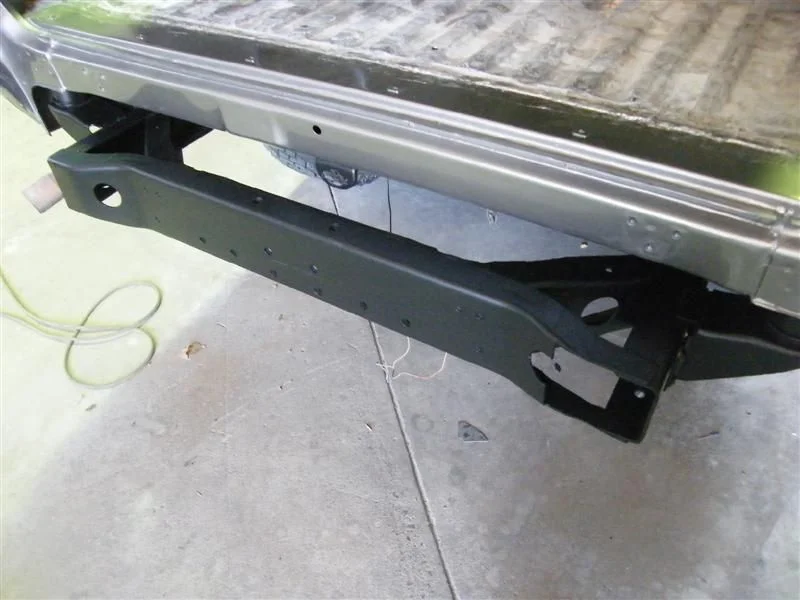

Cleaned the ends of the frame up today,we buffed the quarters.
I was like a little kid on christmas morning,it was like unwrapping the biggest best present i ever got.

That looks great - so your window/door pillars will be in black? That is a great idea - can't wait to see the finished...
Thanks guys,the hard slog has paid off,its not perfect,we didn't get to fussy on the interior and a few other spots you don't see(areas like where the flares bolt back on) but we tried to get a good finish on the outside.

Goldchaser, what did you use for sound-deadener on your wagon? I can't quite make out the brand in the pictures, but I'm thinking about doing something similar or laying down a layer of insertion rubber over the floor area to get rid of some noise.
