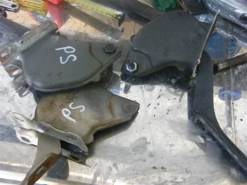

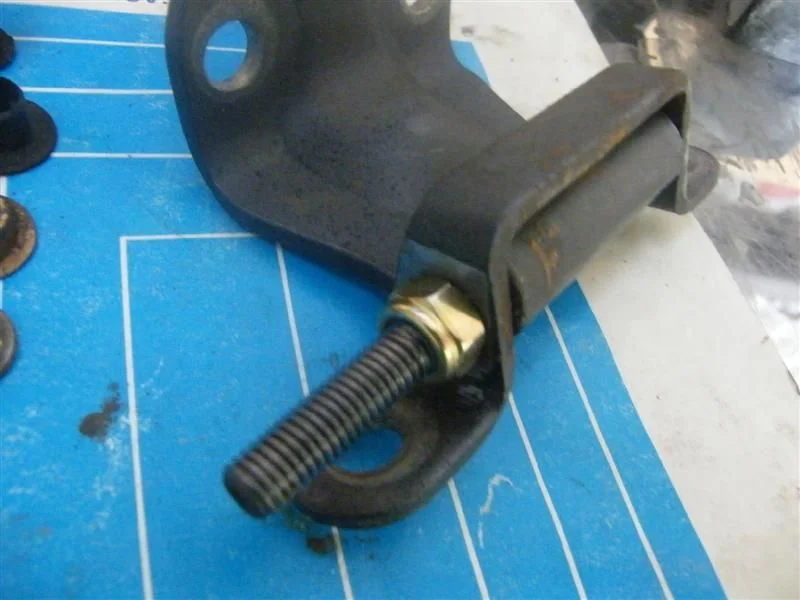

Man my bonnet hinges were bad,i drilled a small pilot hole in the riveted side(see the spare one in the photos,its not drilled but you can see the rivet) then drill the old pin out with about a 6mmm drill then knock it out,both sides are slightly recessed and its hard to get a grinder to knock the head off the rivet,drilling was easier for me.After the pins out bang a 10mmm hole through them then i used a high tensile small bolt with enough shank to make the distance then weld the bolt/nut either side after tightening it.
Then i had to grind about 5mmm off either side of the nut and bolt as the hinge has a narrow gap to go back in through.There is no bushes in the bonnet hinges.

Bonnet hinges,not cut or welded yet.

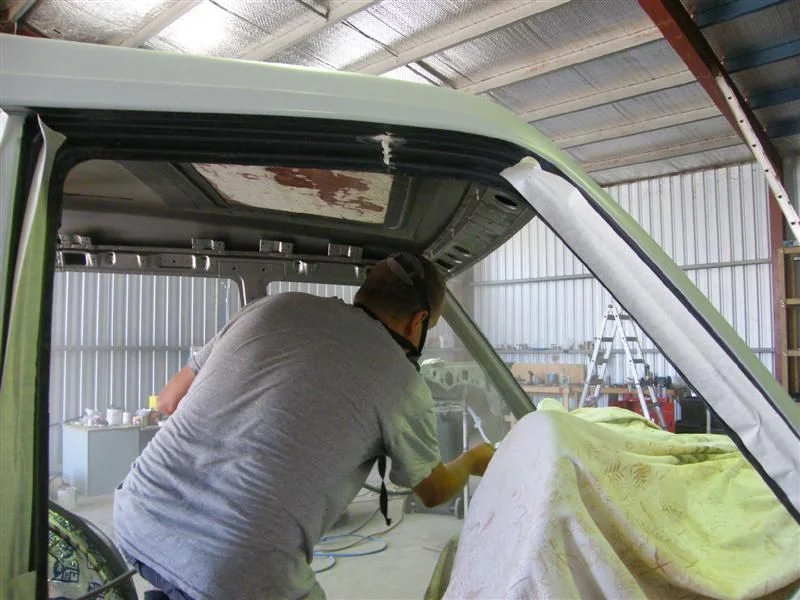

We painted the interior yesterday morning.
It looks ok,inside the shed doesn't do the colour any justice.
I think it has pearl in it,if you look at it at different angles it changes quite alot,will be alot better out in the sun i think.

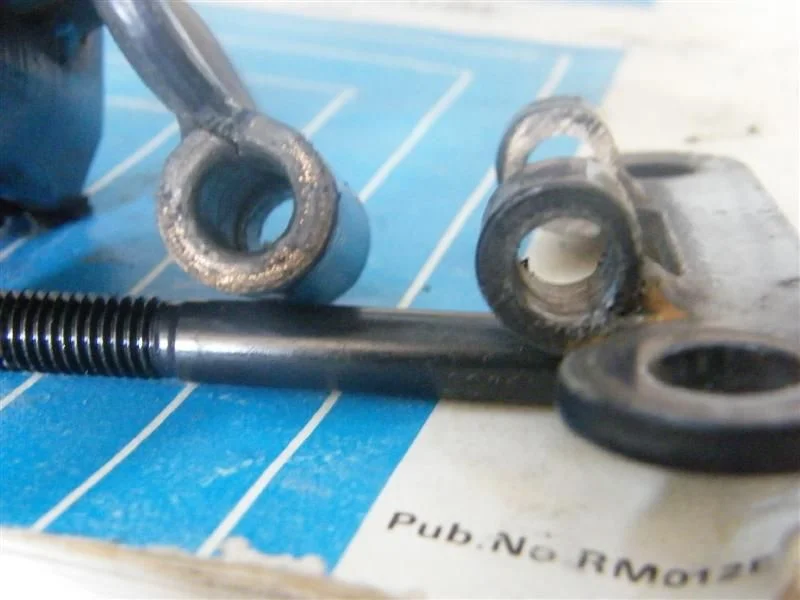

Oh here's the old bushes
Top two are the top tailgate,1 is steel,1 is nylon:hhmm:
The next two are the lower tailgate,both nylon.
Next two are door bushes,left one is the new ones i put in,right is the original.
Bottom ones are the drilled out bonnet pins.
Ah try again,im not 100% tonight,that time of year:D

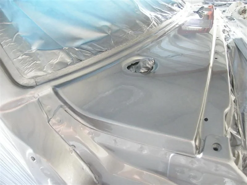

I reckon im on the home stretch,i put a big day in yesterday and the day before.The body is ready for painting,we are knocking over the roof/front cowl after my mate finishes work this afternoon,i'll post some photos tonight.I keep forgetting to take the camera with me to the shed.
It looks pretty straight considering what we started with,there has been alot of repairs,i attacked the repairs then blocked all the flat panel areas with 240 wet before priming.Then after primer ive blocked/sanded it all off with 600 wet.We had to reprime a few spots again where i busted through to metal but it hasn't been too bad,still have a couple of panels to finish(final rub on tailgates/bonnet).
Looking forward to seeing the paint on it then start the reassemble.
Ive easily got 200hrs in prep on that body so far,but im no expert,just some good advice,so ive been taking my time,i reckon my mate would do it in half that.

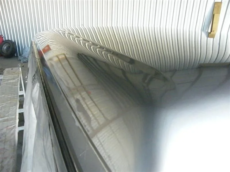

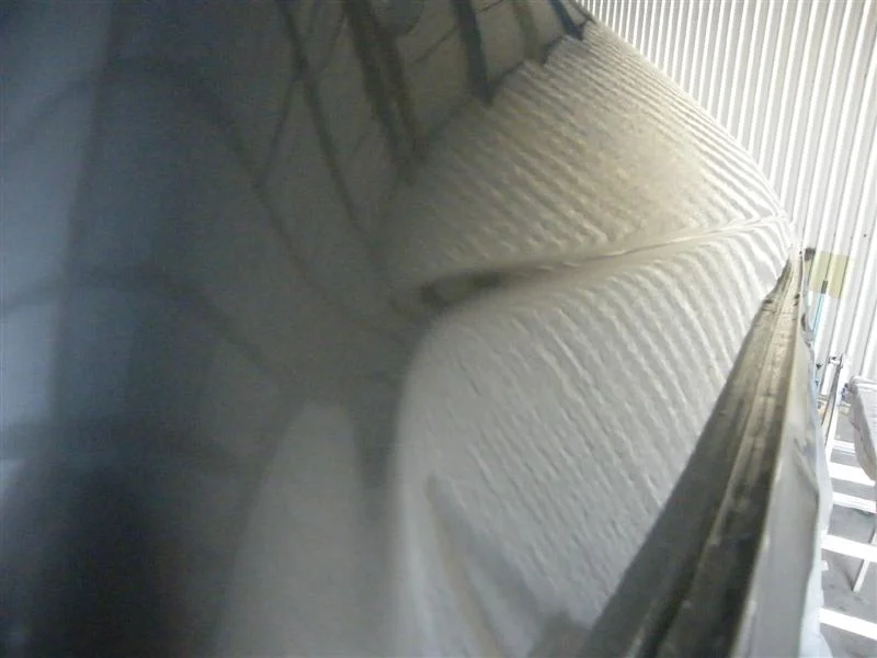

We got a bit of colour on today
another
