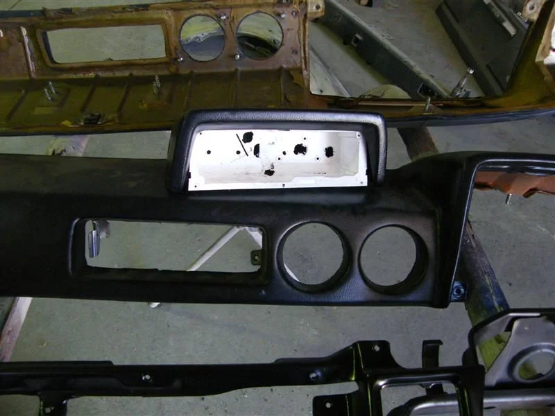

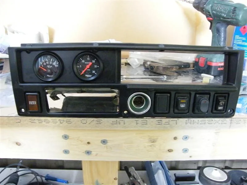

Cleaned up the dash with some fresh paint,on top of the dash pad im fitting a four runner instrument cluster modded to take 3 gauges,oil, egt and water temp,the insert for the dash will hold volt and turbo gauges.

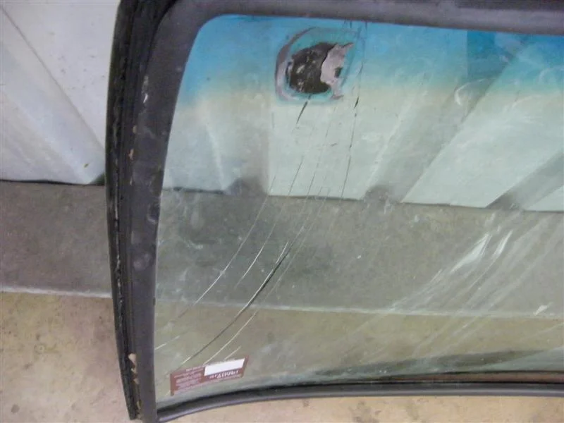

Windscreen did not survive extraction:mad:

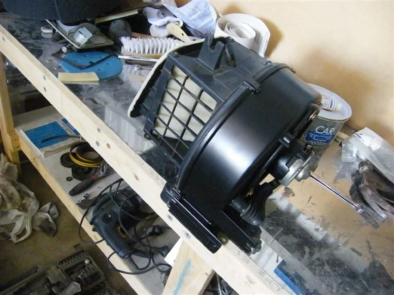

Restored heater/air con fan.

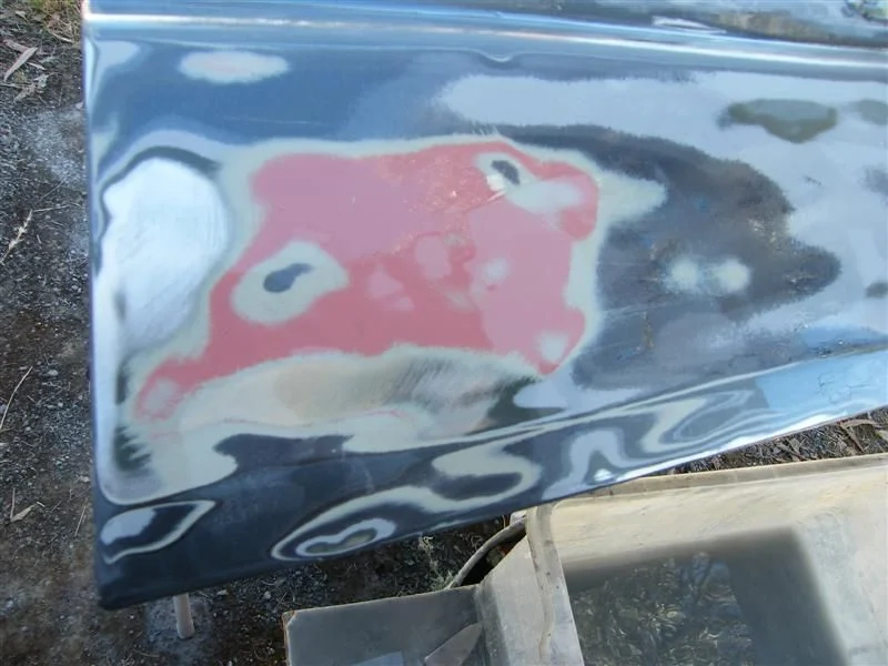

Final photo is old repairs i keep running into under the paint,no wonder the body look a bit of corrugated tin.

Progress has been a bit slow as ive found quite a few old repairs under the paint, nearly rust free but she's had more hits then bruce springsteen,nothing major just small ones,it came from the city so its got to be expected.

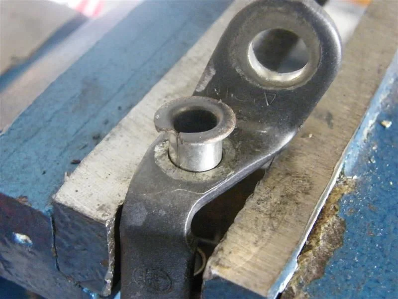

I sourced some 8x10 flanged sintered bushes as a few hinges are buggered,the rear tailgate ones are the worst,both drivers door,the rest are quite good,but while its apart i might do the lot,i didn't ask toyota for a price on hinges as i reckon it might be a bit scary,plus i like the idea of making them a servicable item.You have to drill out for the bushes but it looks like they'll come up quite well,i'll take some more photos and detail this later if anyone is interested.

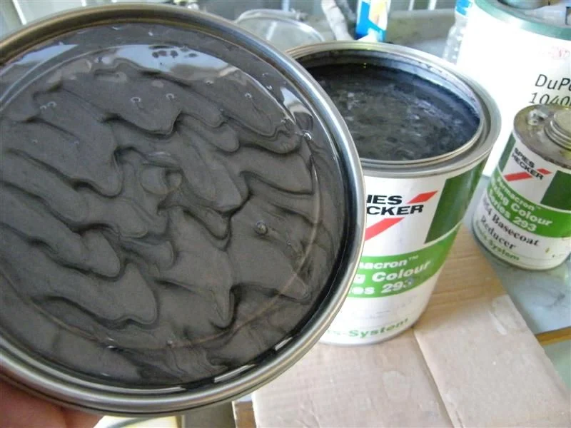

Paint turned up a few days back,4ltr colour,4ltrs clear,half ltr black base coat,hardeners and reducers added up to $1100:censor:
Yes, please post pix of the hinge repairs, I'd be very interested...
Hinges from Toyota are available, but run about $45 or so each, US, so it can add up fast if you replace the whole lot.

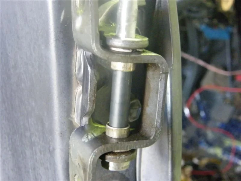

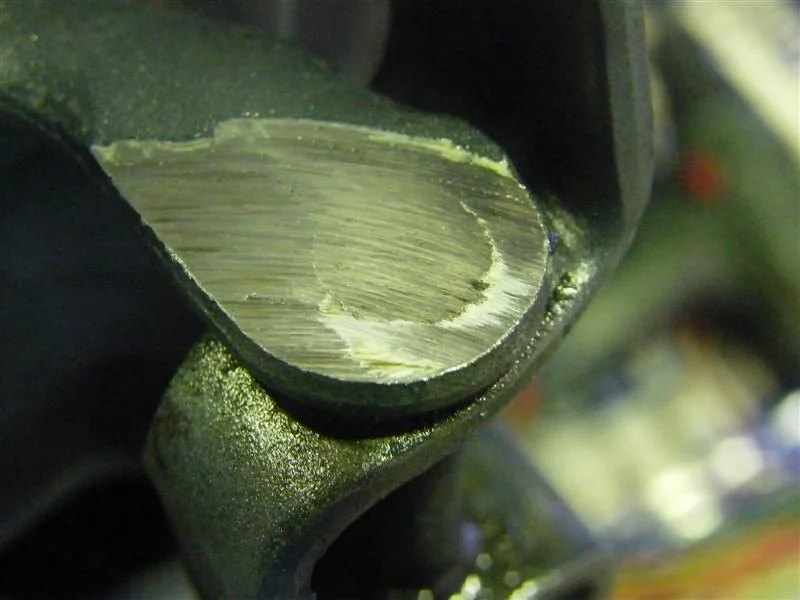

Here's some more photos of the hinges
The door hinges take a 10mm bush without drilling,its a nice tight press fit or slight tap with the help of lube and a hammer.
I had cap bolts with a long shank i cut off and just welded the top side,in hindsight i should have cut them flush both ends and welded at both ends:hhmm:
The door hinges are not for the faint hearted to attempt,they are a bit weak when not bolted to the door,knocking the old pin out can push them apart a little if your not careful but they bend back jusy as easy,next time i'll do them completly off the car.I left them mounted. Grind the old head off the pins,the smaller side of the rivet is the easiest to knock out,i also ended up cutting them in half in the middle also to help ease the stress on the hinge when driving it out,i then drove one up then the other out the bottom .
Put new 8x 10mmm bushes in then your new pin(whatever you use just make sure its hardened steel) then clamp it together a little before welding.
Next time i'll also try and source the right lenght bolts to suit the hinges as it would be easier to spot weld a bolt and nut after its tightened.
Ah but i just remember the 8mm cap bolts i used had a little play in some of the body hinges,dam i better get some weld on the bottom side tomorrow:doh:
