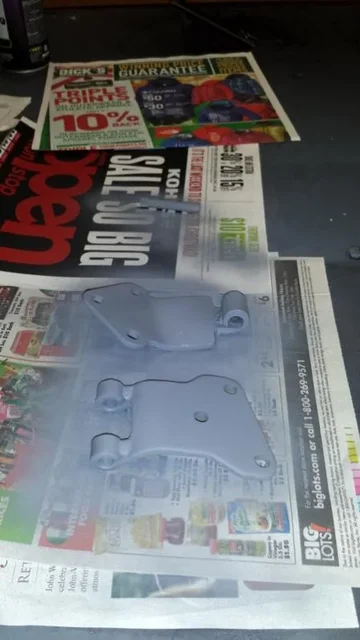

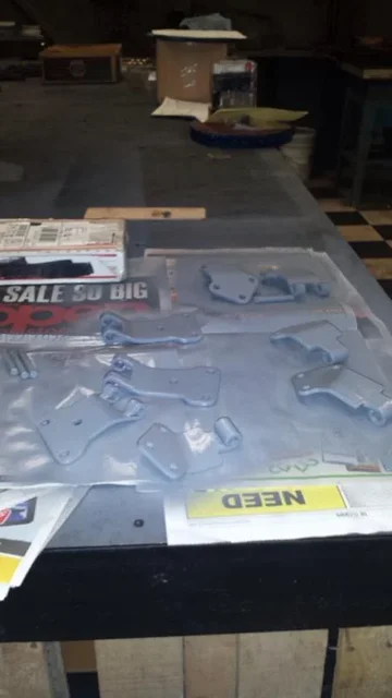

The paint was super tough. I had to heat it then sand blast. They look good now. First coat of paint will go on them tomorrow.
Just reminding all out there about what we are doing. No drilling out precious metal. Disassembly, bead blast, prime, and paint...reassembly with new brass bushings. All who have seen our work, please chime in.
