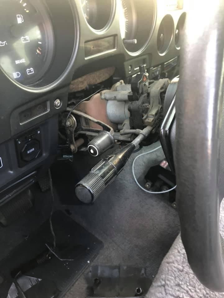

Just as motivation to anyone who might think this is more trouble than it’s worth.. this is what happened to my FJ62 about a year ago. I just recently replaced the door lock finally. Decided to not even repair or reinforce the door panel metal. (Figured that would just make the damage worse the next time someone tries to pry the lock off)
Pretty sure it was an inside job.. probably tipped off by our outstanding rent-a-mall-cop “security” patrols. This day, I happened to park in the 1 lot that had poor video camera surveillance. Figured it was ok since it was fairly close to the busy main entrance to a hospital. They punched a hole into the door and popped the lock off. They even covered the gaping hole in my door with a small piece of white duct tape, I guess in case someone walks by?
Once inside, they destroyed the steering column cover. Basically tried to hammer a screwdriver into the ignition to force turn it to start. Amazingly, they got so close.. but apparently never succeeded. Eventually, I was able to use a smaller screwdriver at a certain angle and get the car to start. The morons didn’t even steal my AirPods which I stupidly left inside my center console. But, plenty of damage. I was eventually able to get the jacked up ignition cylinder out and replaced with a new OEM one from the local dealership. I fixed a donor door lock cylinder and “rekeyed” it to match, but messed up the bezel bad. Need to get it done right eventually by @ToyotaMatt. But other more important things on the ToDo list. Anyways, going to have to put some more thought into security, once I get this rig fixed up finally.
Dang! That is some damage! Im glad they didn't get the cruiser at least.
Yep.. these worthless pieces of s*** in So Cal..
