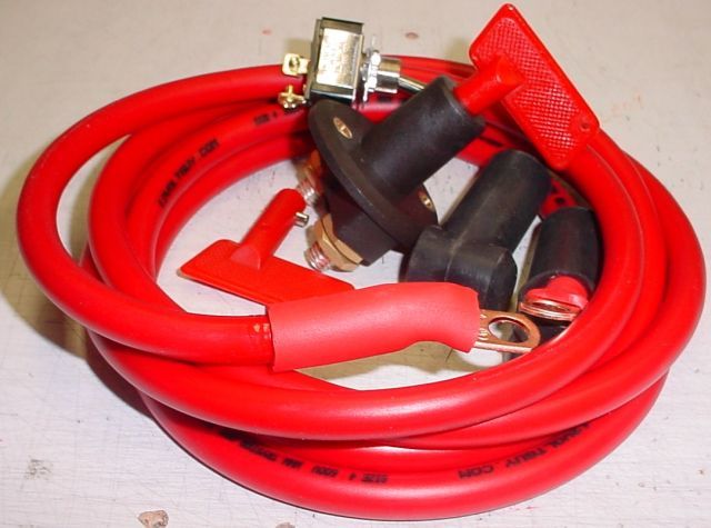

Sorry for late reply
I just sold 2 of these kits so I took new pics
I usually use a bit thinner adhesive shrink tube but ran out so pic shows the triple heat shrink tube with built in adhesive, it melts out sealing the connection when heat shrunk:grinpimp:
includes
8 foot of 4 ga cable
big switch with 2 keys
cable end boots
1 o-ring sealed on/off toggle switch, use to cut ignition or fuel pump relay power, I suggest you do more then just the theft kit cutting power to starter motor.
I like to use these big switches on the negative battery cable, this way it cuts all power, but to keep your computer happy and radio pre-sets + clock install a 5 amp fuse from battery negative to ground.
this keeps battery connected, and even if a thief has your keys, the small 5amp fuse will blow as soon as he trys to start the rig as the starter will draw 100-300amps...........theif will likely think this car/truck has problems, after all the dash had lights a second ago, or the door chime was just working:hillbilly:
The idea is to at least do something to prevent thef, make the next guys car easier to steal then yours:grinpimp:

So with this setup you need a to use a Key (those red butterfly looking things) to turn on or off the circuit/switch as opposed just a toggle switch or something like that?
Can the cable/wire come in black instead of red? (trying to keep it less obvious)
yes, the big switch is a plunger type, push in key & turn.
I do not have black, but I have plenty of heat shrink tube that I can cover entire cable with at no extra charge, just note that when you order:grinpimp:
custom size cable is no problem, longer will cost a bit more $2 a foot, I buy this in 250' spools and the price just goes up every few months like gas, but never drops down.......:mad:
