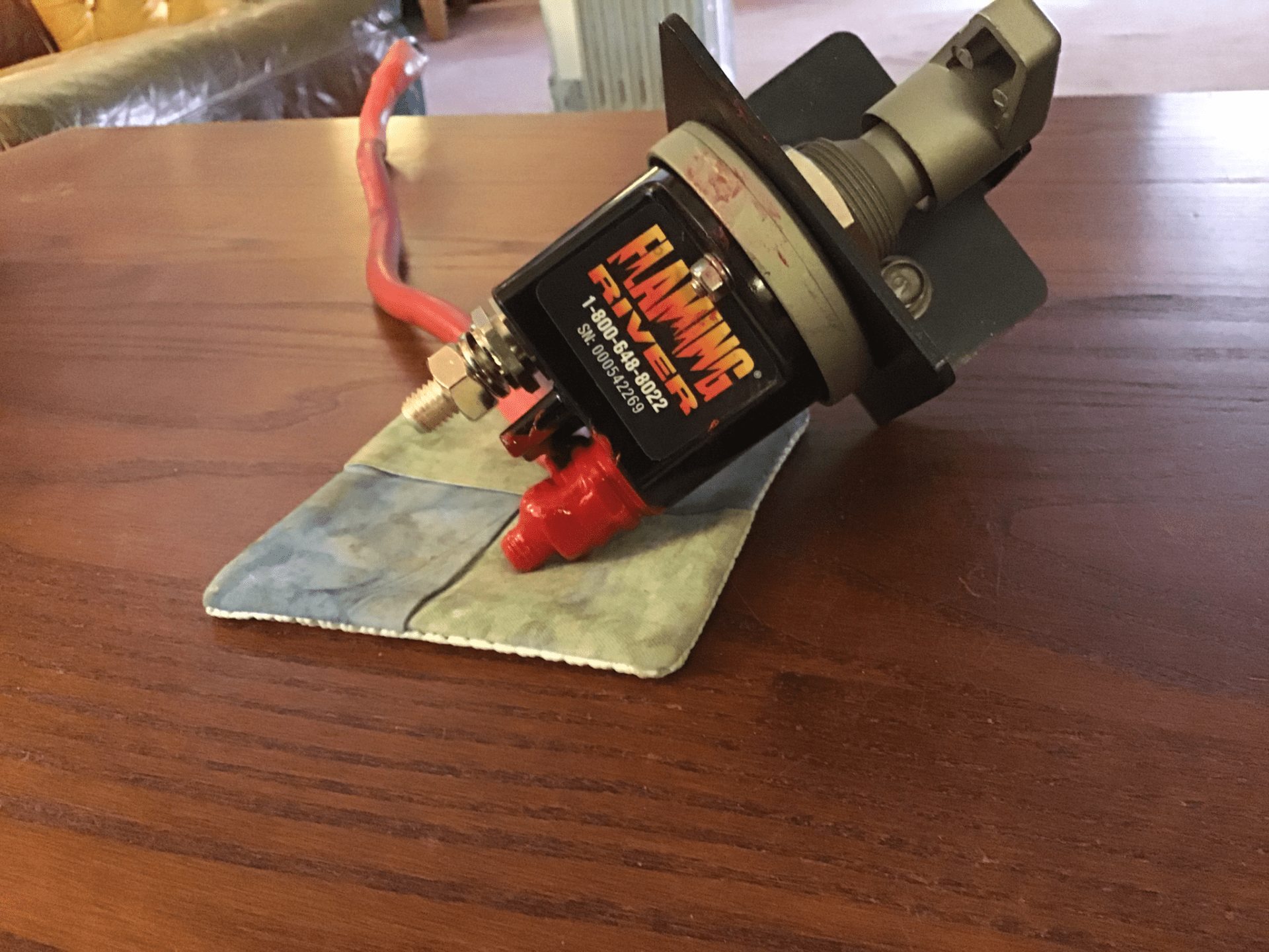

Here’s the battery disconnect that I use, the on/off switch has a heavy duty padlock. As with most anything it certainly can be defeated. But I do sleep better. Have one on my 40 & my 60.

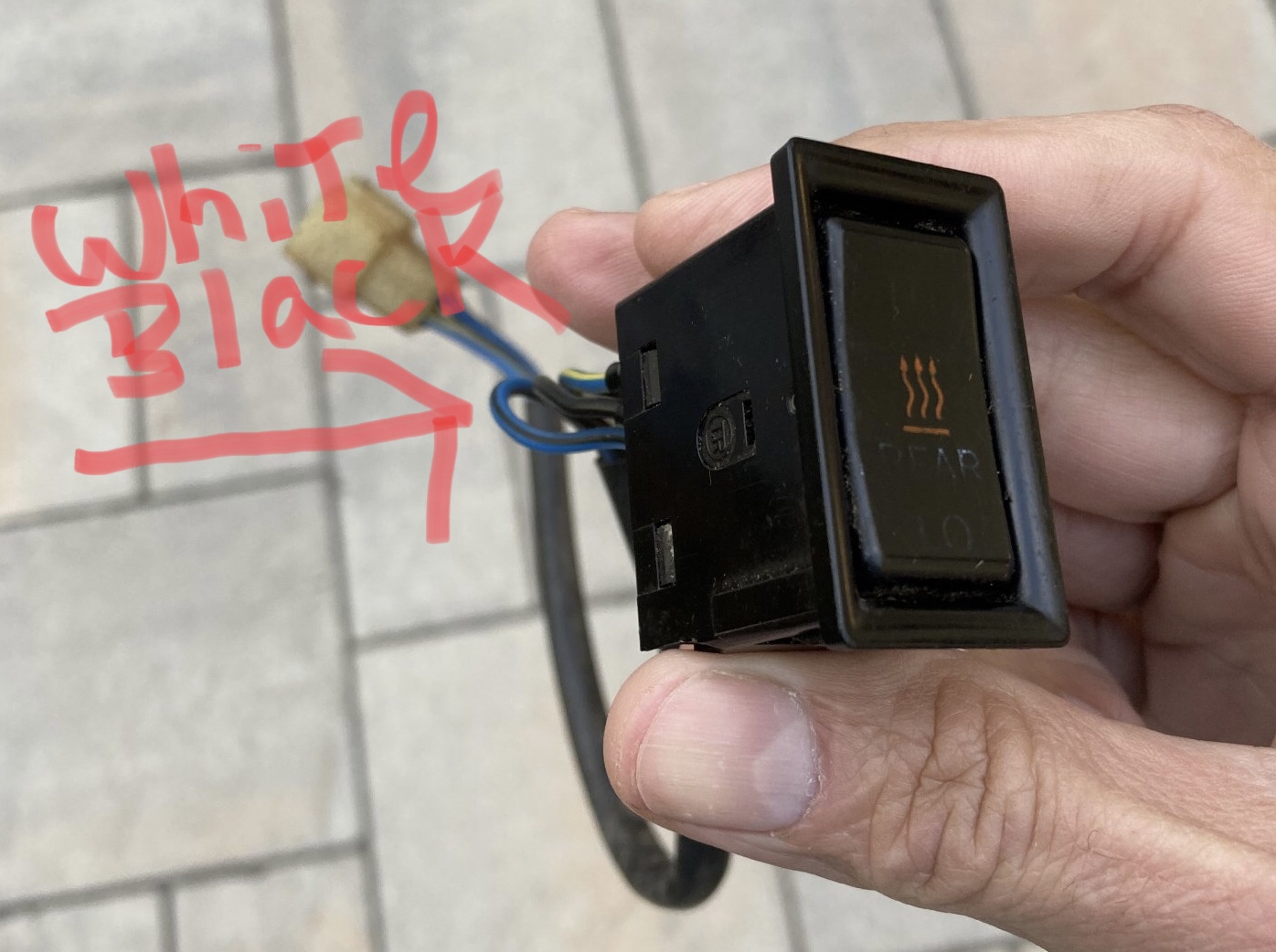

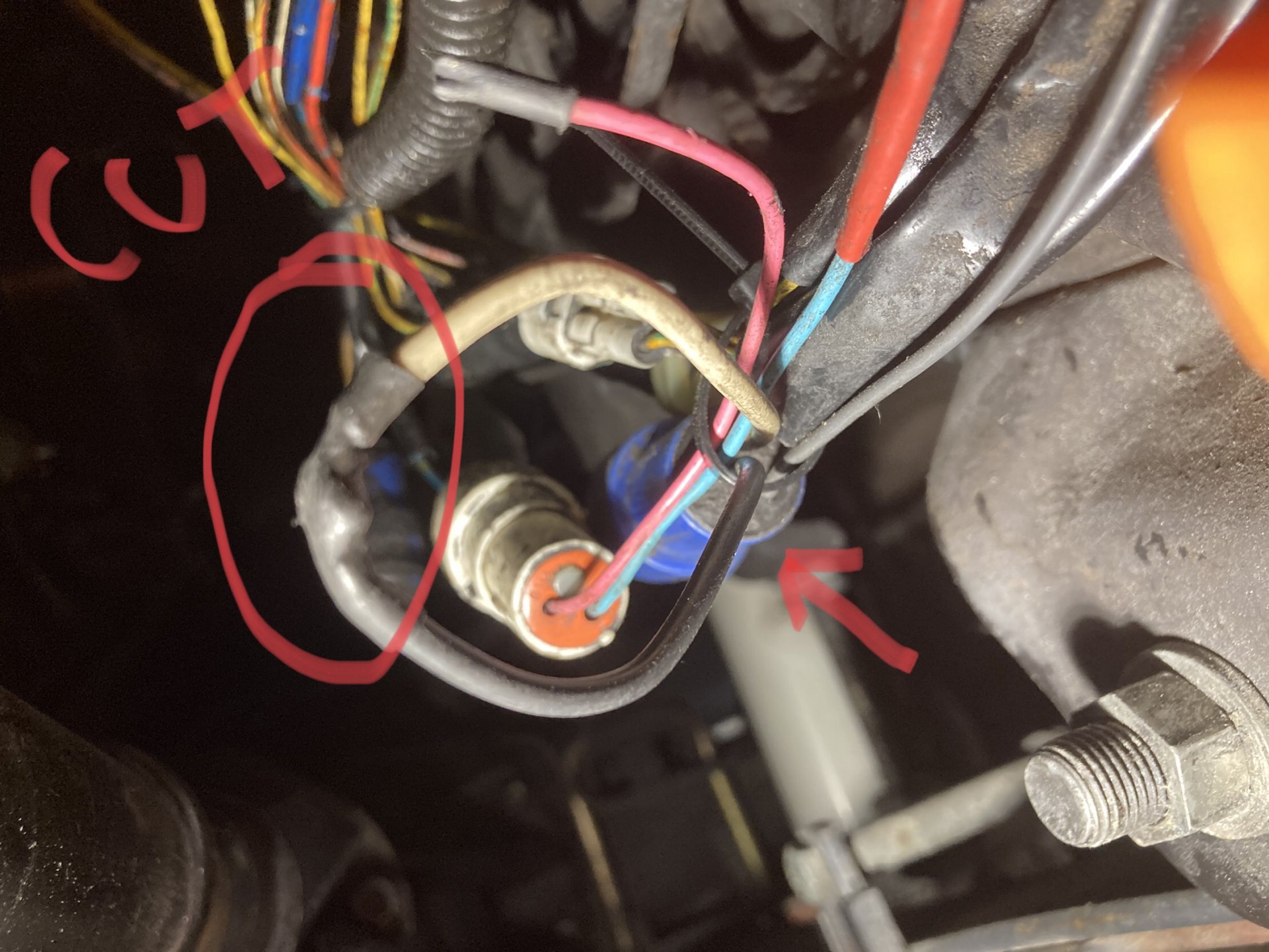

Very easy.
When you did the H55 you had to connect two wires to fake the vehicle into thinking it was in neutral so the starter would work (NSS bypass)
Mine was a blue connector with one thick black, one thick white and one thin black wire coming out. The thin black wire isn’t in play for this job.
For this procedure disconnect the white and black wires.
On the back side of the extra rear seat heater rocker switch there are four wires. One black, one white and two blue with stripes.
I connected white to white (using some extra wire bought at Ace Hardware) and black to black.
For routing, I removed the passenger seat, pulled up the carpet a bit, drilled a small hole in the transfer case floor cover plate, put rust reformer paint on the exposed metal, and ran the wires down under the truck to connect. There were a number of ways I could have routed the wires without drilling a hole but I was a bit rushed so took the easy way out.
This wiring setup will not allow the truck to start when the rocker switch is in the middle position (the natural position of the actual rear seat heater rocker switch) but will start when you push down the the rocker switch toward the dashboard.
