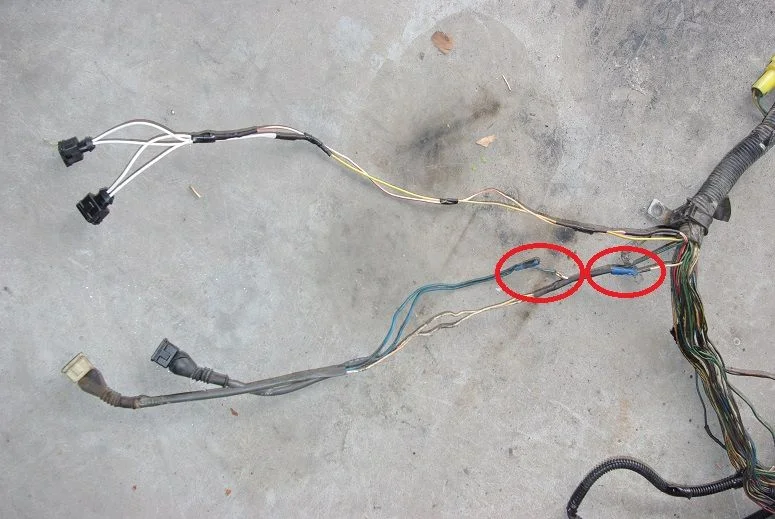

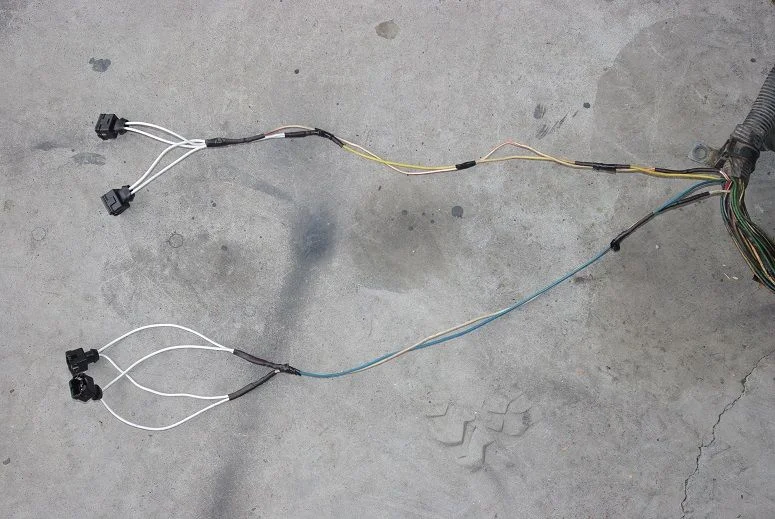

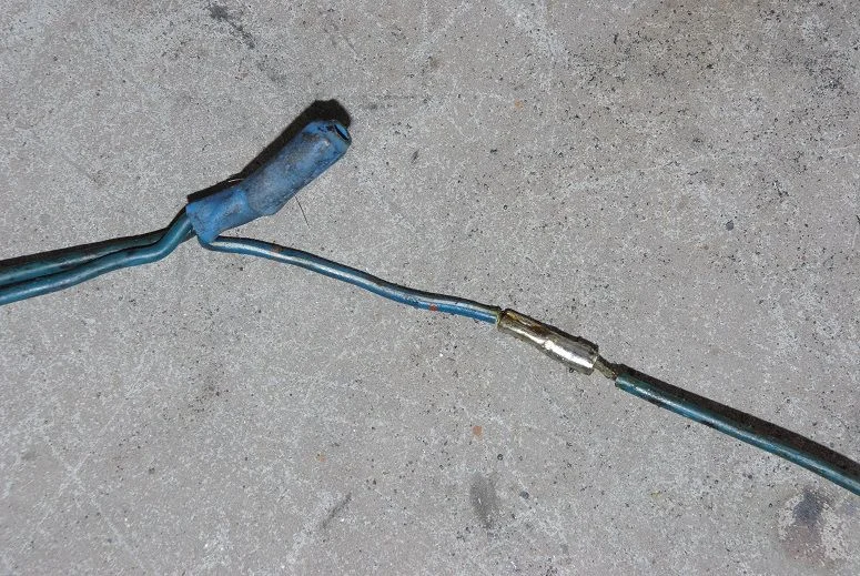

My preferred way is to pull the harness out of the truck and lay it out on the garage floor. Others do it with the harness still in the truck, and just peal it back onto the fender to work on. In a nut shell. There are multiple splices in the harness. The splices that seem to cause the biggest headache are the splices to the fuel injectors. The grounds are spliced together in multiple places. The signal wires to injectors 1 & 2 are spliced together, and 3 & 4 are spliced together. The splices are simple brass clips, and those, plus the wires, corrode. I dug for my pictures, but couldn't put eyeballs on them. I'll keep looking, because pictures help. When I did mine I also replaced the injector connectors since they were brittle.

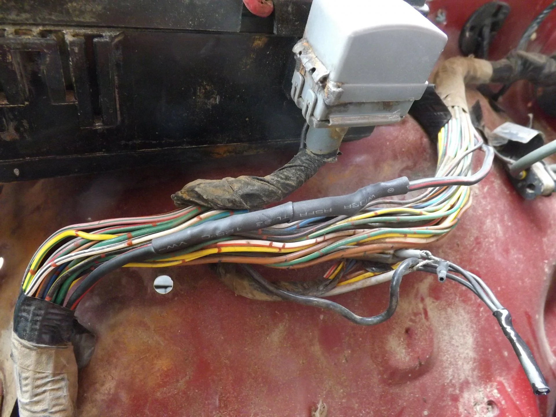

Pics. Just a note. My harness has been repaired twice. Back in the day I didn't know as much as I know now. My truck was running like crap, so I took it to the dealer. This was well before the Internet. Well, they fixed it with butt splices. You can see one of them in the pics. My fixes included solder and shrink-tube.
One of the butt splices, and a brass crimp.
Half the harness fixed.
The harness fixed.

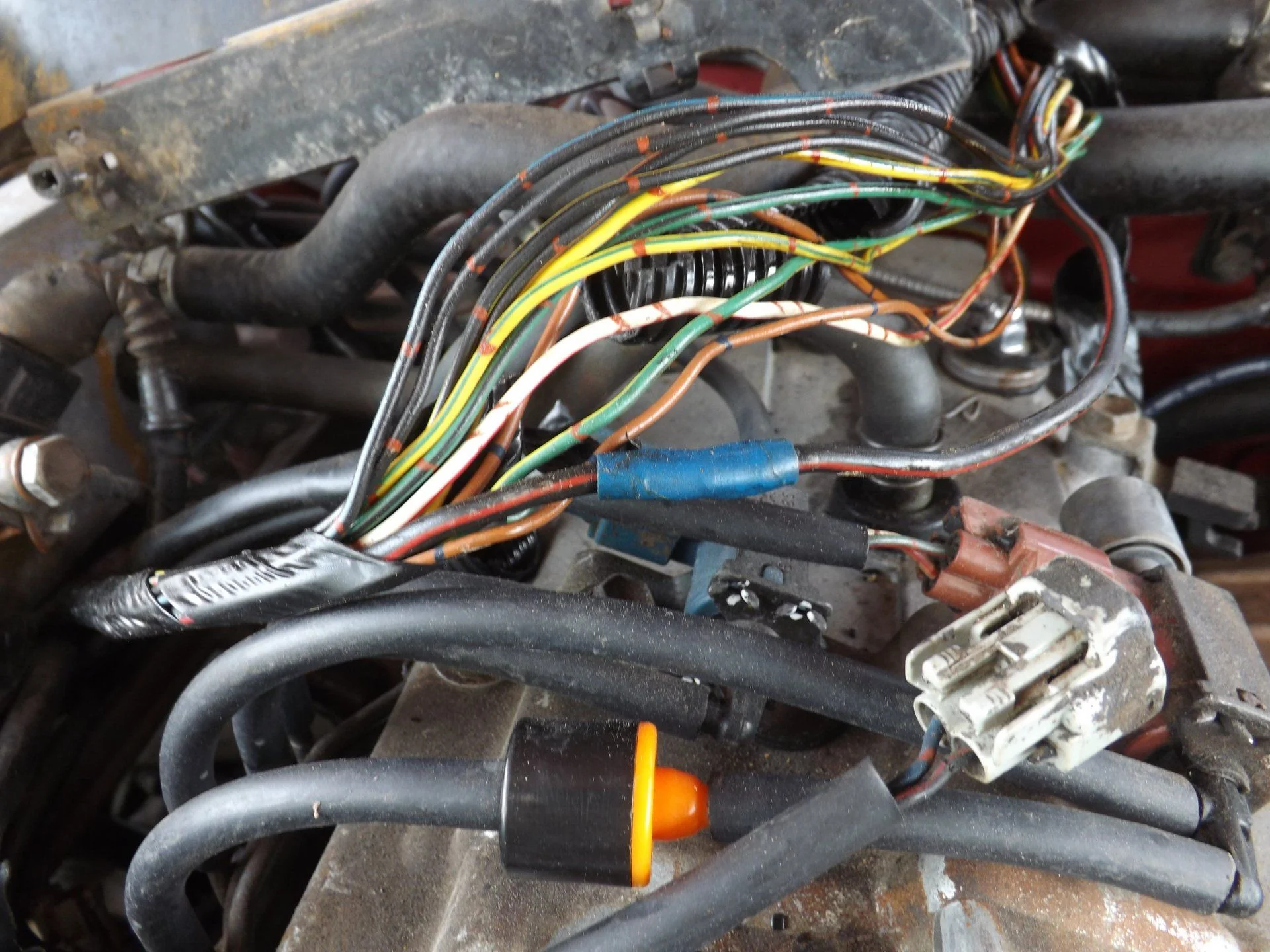

I found 2 butt splices and have fixed them. see photos.
The trucks runs much better but not perfect. I have the 42 code back so I am wondering how to get the harness out of the truck. Do I have to remove the throttle body and box or is there another way? I cant get to any more of the harness the way it is
