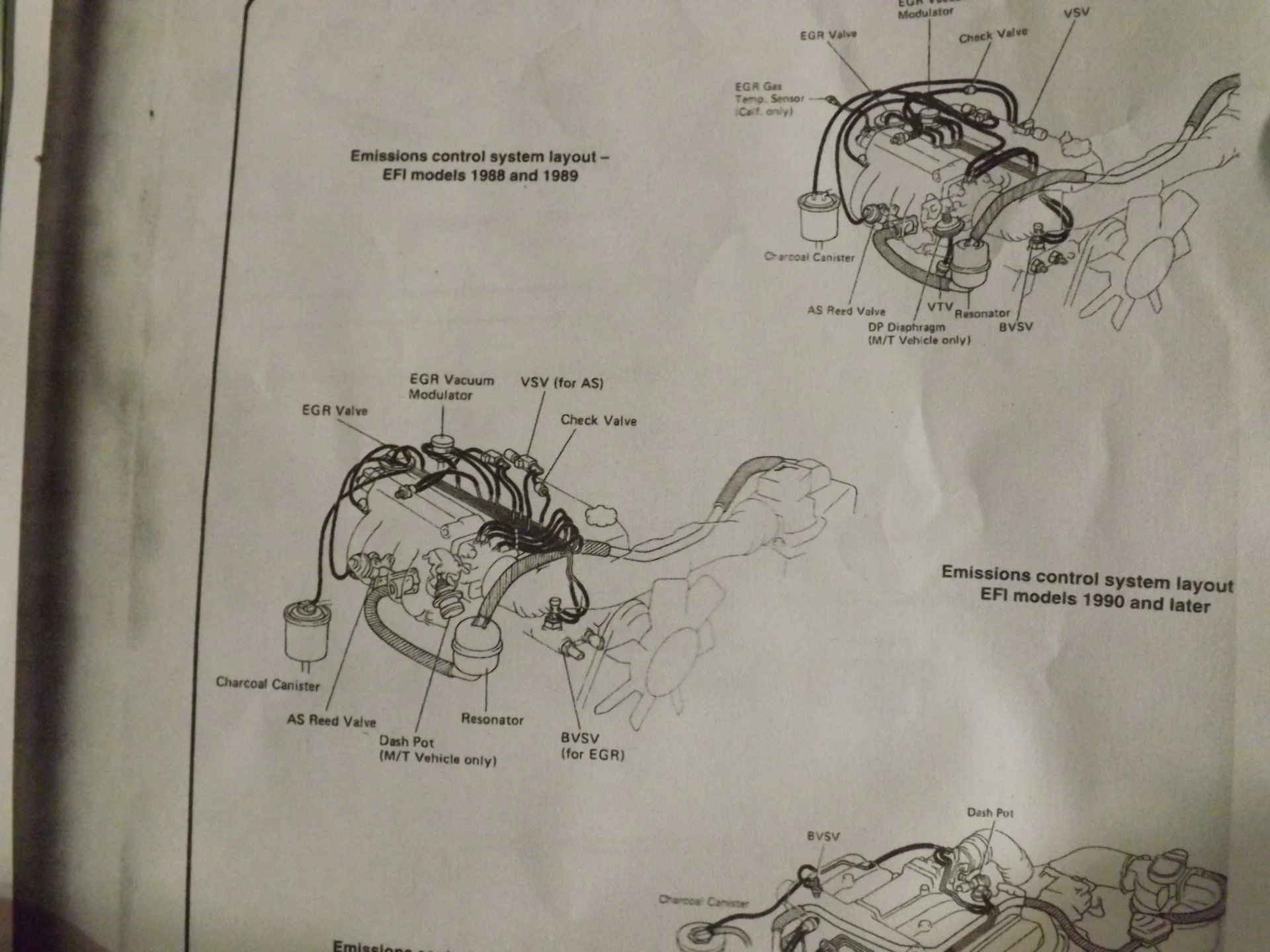

The Haynes book I am using has a picture of a 88-89 motor with vacum lines shown and there are only 3 lines going to the throttle body, mine has 4 like a 90. I am very confused. Any Help?
I will have to find out where to plug in the valve before I can get it tested
the first pic is of the motor I should have but the 90 seems to be the one i have,
the second pic is the vacuum routing

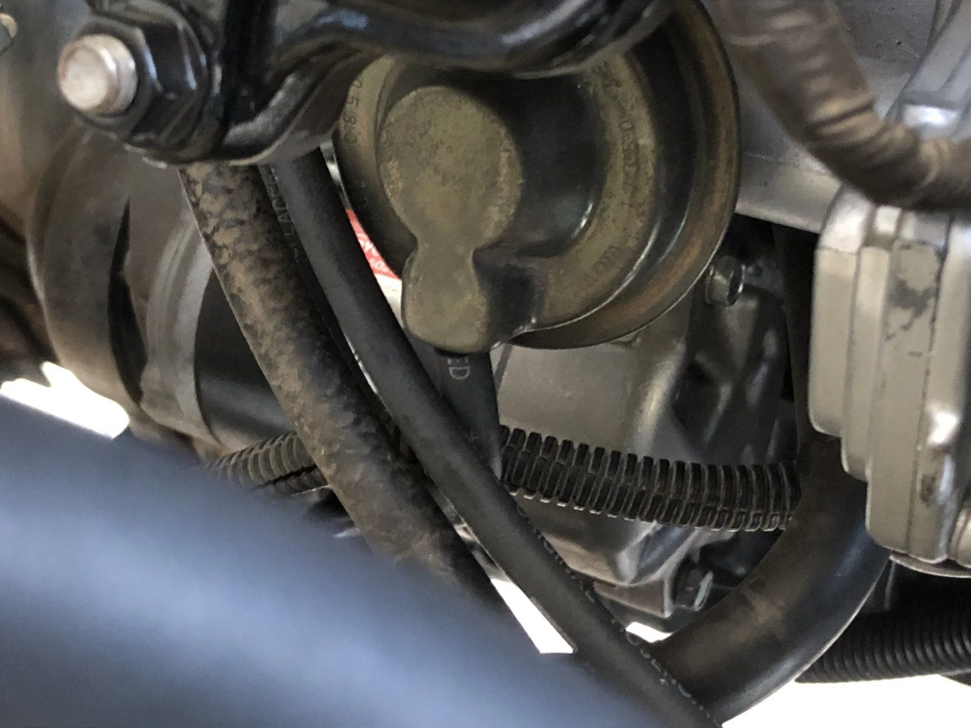

the fourth pic is of the VSV (for the AS). the front live goes to the throttle body and the other line goes to the vacuum valve on the back of the motor passenger side in pic 5
the fifth pic is of vacuum valve on rear of motor
As you can see from the pics the there is no ware to put a vacum line from the AS valve. I need it pluged in to something. If I were to take th line off the valve on the back of the motor and plug in the AS to it then where would I plug inn the one on the back to?

That said, looking at the last FSM drawing, the AS/PAR valve vacuum line goes to the VSV. From the VSV it goes through the check valve to the TB. But, it looks like you have hard lines to feed it though. I would check the routing from the VSV to the TB. I suspect something is either missing, or hooked up incorrectly. With that much vacuum line it's easy to get things messed up.
That last picture from the back of the engine is your fuel pressure regulator. It also goes to a VSV. I don't think it's related.
