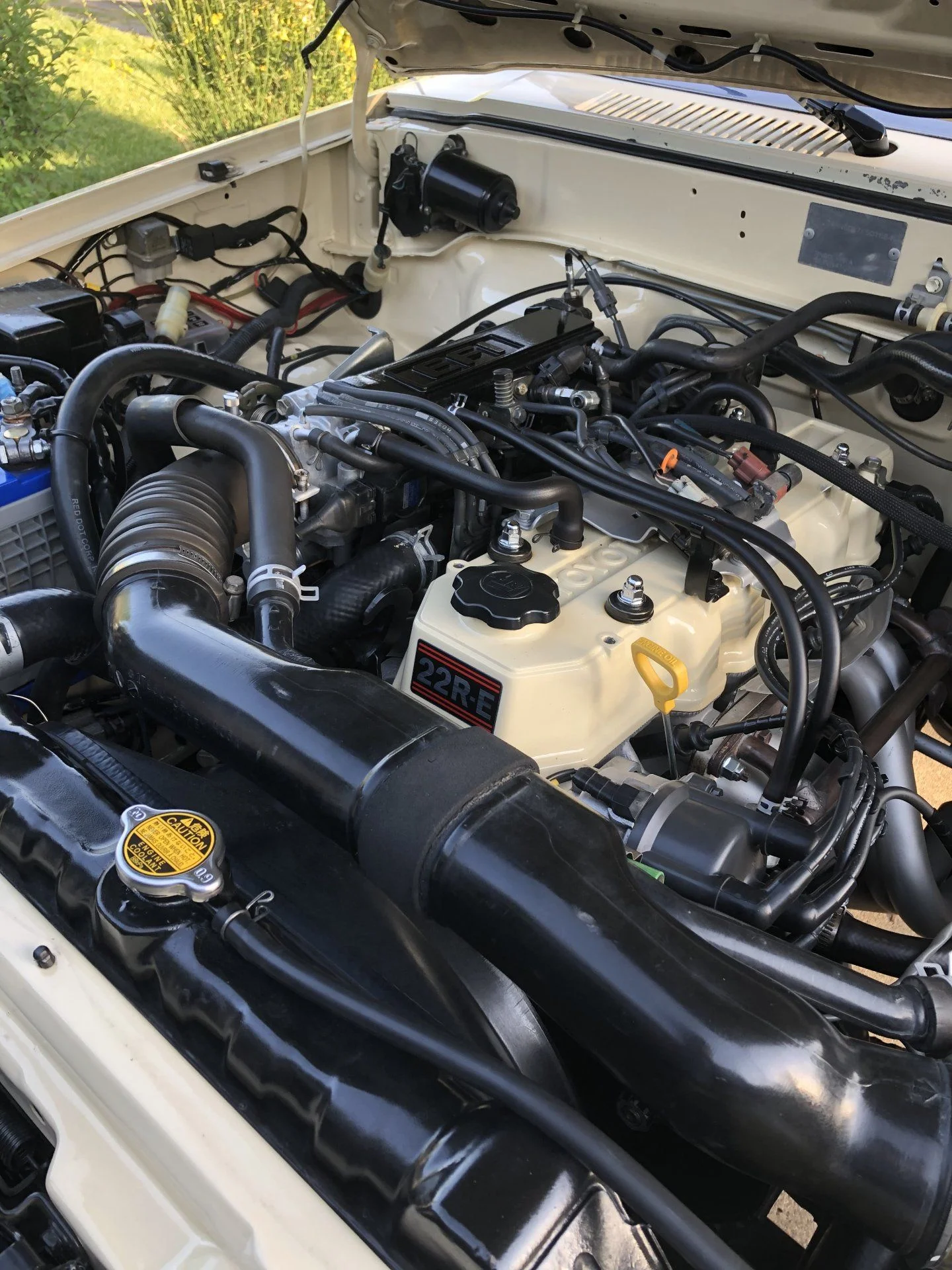

This is how mine is ran

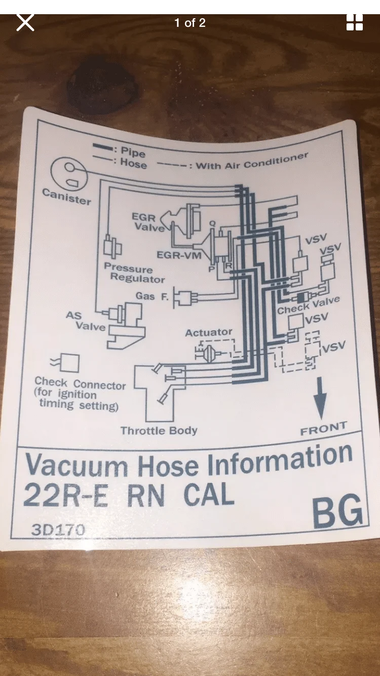

OK, I got the truck back from the shop. They set the TPS and Timing. It took the tech about 2 min. to fix the vacuum lines, I dont think I would have figured it out. The Gas F had three ports on it and it is only should only have 2 . Have app. for emissions ck on the 23 of July will let every one know the out come. Thanks for all the help.
It should have had three ports. Only one or two are used.
The Gas F ...
BTW, that gizmo is a filter. Officially, Toyota calls it "Filter, Gas, No.1." They have a habit of getting carboned up on the inside. It's good to pull it out on occasion and clean it with the spray cleaner of your choice.

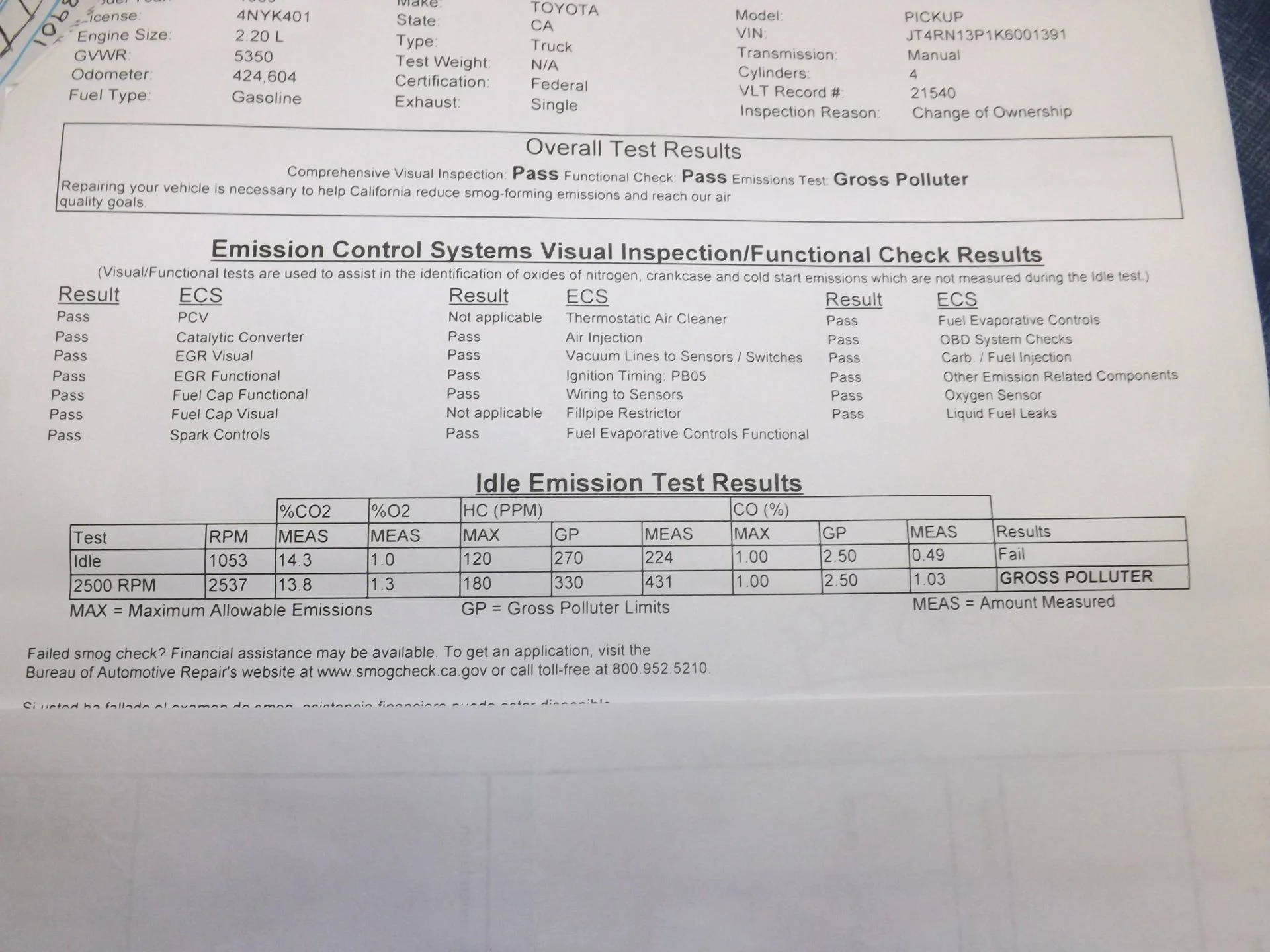

High HC is a dirty, poor running, engine, or a bad CAT, or both. I would not replace the CAT until you address ALL tune-up issues.

I would agree with pappy here. To me it appears to be a bit rich. A real miss makes way higher hc numbers.
What are NOX readings?

Sorry, it posted before I was done. The first time I took it to test they did not test it. they put the snifer in the tail pipe and it was dumping a lot of fuel out the tail pipe so I have no numbers from that test. The second time the did test it and that is what I have now so it is a place to start from.
I don't think they measure Nox the county he is in. I don't think it was a dyno test.
