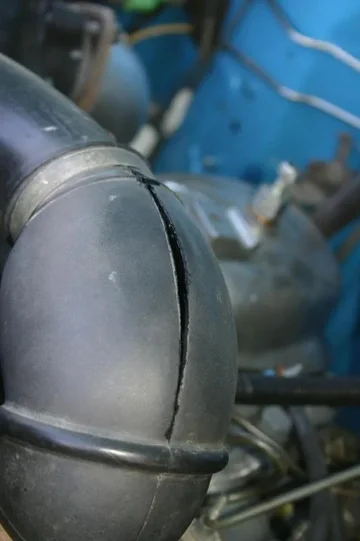

So, that's not great. It blew out at roughly 3lbs of boost on the way to visit Grandma today. It smokes a LOT normally aspirated, and the EGTs are WAY higher. Amazing! I patched it temporarily with some epoxy and gorilla tape, and drove it the rest of the way and then back (roughly 60 miles total). So obviously I need to order some silicon hoses to replace that stuff....
But here's the interesting bit:
Why is there that much oil in the intake post turbo? The turbo is freshly rebuilt, and the oil on the dipstick hasn't moved a spot for the last 1000+ miles. I will likely take the truck to the diesel shop in Denver (luckily, it's the same diesel/turbo shop as Albuquerque) to see what's up. I wish I had the spare T3 up here with me, just to swap them for a while.

Wow... That's a lot of oil in the intake... have you checked the rest of the pipe to see if that is consistent inside the whole thing?
I don't remember, but do you have the 'PCV' pipe (forget what to call it - breather maybe?) rerouted into the air cleaner instead of onto the front driveshaft? that could be it...
K
Not yet. I will when I replace the intake though.
Nope. We installed the uber rare self oiling driveshaft. ;)
I puts out a drop or two every so often, but much less than I was expecting. At least, judging by the drops on the floor...
Dan
Odd... My pipe is dry a a bone (turbo outlet to intake). The other pipe, not so much!

Weak. I'm going to take it to Central Motive Power tomorrow to see what they say.... Trying to figure out how to get the spare T3 up here, just in case...

Ordered the replacement intake parts from BoostController.com LLC - America's Source for High quality turbo boost controllers, silicone hose, and more performance products - 877-836-6155- precision boost control. Turbosmart Warehouse Distributor and the first box got here wicked quick, but with a 45 degree instead of a 90 degree elbow.
The second box also got here wicked quick, so it's all back together and not leaking again. It really is amazing how much the lowered boost raises the EGTs. It's counter-intuitive, but it's true: boost lowers EGT (at least, at these boost levels).

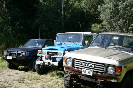

And just because I can.... the stable in CO right now.
I might cry when I give this back to Dad. 31MPG bests the faux-lux, and it is simply so much fun to drive!

No word on the oil issue, I haven't had time to get it into the turbo shop to let them look at it. I don't really want to do much to it, since it *should* be under a warranty so they can look at it better. That said, there's definitely oil in there, but it's not constant, nor a constant amount. Very odd.
Dan
Got to see this truck on the ride this weekend. Pretty sweet. Dan, I have that much oil in my intake pipe as well, and I suspect the turbo seal is a goner. I have yet to drain the intercooler, but I'm suspecting there will be a good bit in there when I do.
I drove the truck and talked to Central Motive Power in Denver. They will fix the turbo if they find a problem with the turbo, so I'll try to get it off and get it to them next week. But it's not a huge concern, by any means. If your truck is doing it too, then I'm not going to panic and keep putting the miles on it until I get the spare turbo up here to get this one off for them to look at. Especially since this truck just doesn't smoke much at all, it must not be a constant seep.
