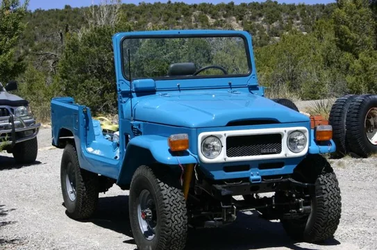

I also had to pull it outside just to see it in the sun again.
For what it's worth, if the turbo were here, it would be going for a spin. The brakes work, the steering works, the electrical all works.... About all that's left is to get the hood hooks on, get the turbo on, and then rig up the top (or not) and lift the roll cage into it. Seriously. 1 week to Cruise Moab, and I have to work 4 days of it. :mad: But (fingers crossed) the turbo will be back monday, I'll call and see if that's a possibility tomorrow...

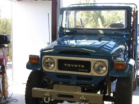

But Dad got a little bit done after he got back.... Looks much more "complete" with the badges and bumper, don't you think?

Looks alright I guess; if you're in to that sort of thing. If you are getting sick of looking at it by now, you should drive it up to Santa Fe and leave it in my garage.:grinpimp:
I'm thinking about painting the front bumper on my LX silver now... just because it looks damned good on yours.
