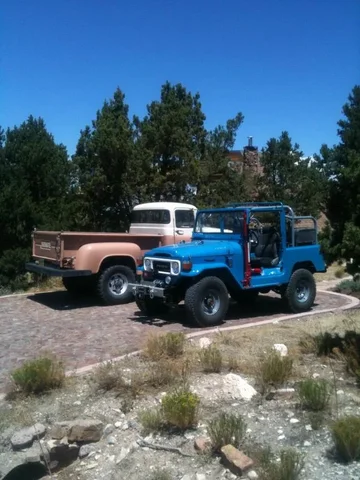

Lame iphone picture, but here it is in the driveway next to Mom's Power Wagon...

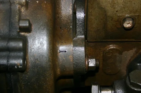

Here's the timing marks before I pulled the IP...
They are perfectly lined up now (not sure how, pretty sure I set them up just like this when I put it back). The bigger question is, how on earth do you rotate the IP with everything hooked up to it in the truck? It doesn't want to budge, and yes I've got all 4 bolts loose (the three at the flange, and the rear hinge-ey bolt)
loosen the injector lines ...
i would rotate the pump (top) towards the motor 1/4" (at the marks) and give that a try.
