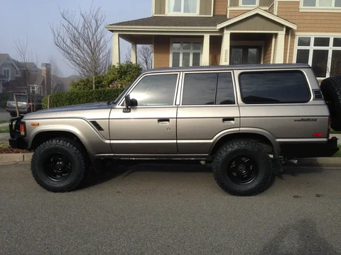

Got the rear carpet done....that's very straight forward...but man, the 40oz marine grade is a huge step up from the 27yr old stock carpet. have to get the front (probably very tough) and rear (not too bad) passenger section done by the end of the week.
chrome blackout done....LOVE IT. The SEM trim paint is amazing, only thing I'd recommend for doing the paint. Laid down so nice, totally amazed with the finish. Dries so fast too. I'll have to get some better pictures in the daylight during the weekend.

also got the new rear hatch stays put in...so nice not having to use my head to hold it open.
All in all good weekend for checking a bunch of items off of the list and making good progress.

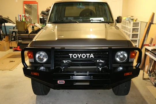

Well, haven't posted anything new in a while...had been waiting to be "finished" but life keeps getting in the way. At this point all I have left to do is install the panels, but the back seat in (after I use some SEM color coat to make them black), and have the stereo installed.
I'm amazed at the difference the sound deadening made. The MLV is really what made the difference in quieting the rig down....drove about 80 mi today and couldn't believe it..and that's with the door panels still not installed. Well here are some pix where the Walrus stands as of now...at least the exterior is complete...the F5 rims are sick and really happy with the blackout of all the chrome.

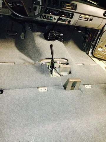

Rest of the carpet installed
carpetinstall#1.webp carpetinstall#2.webp carpetinstall#3.webp CarpetMiddleInstall.webp

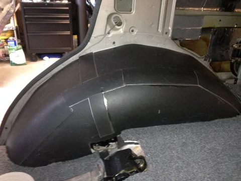

MLV on the wheel wells....pita as MLV will not do compound bends...came out great and makes an unbelievable difference in noise reduction

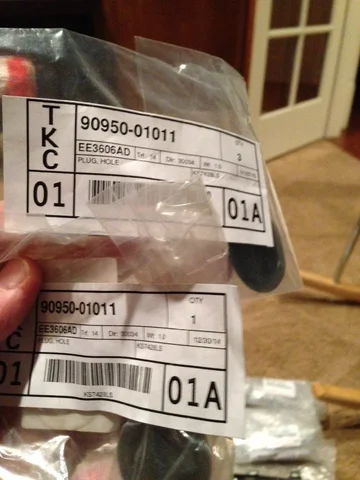

Ok. So I deleted the rear heater when I had Tor do the vortec swap and when I installed the BMW seat brackets he has. I needed to plug up the holes from the heater tubes. Lucky for me @beno has his fantastic "what's a parts guy to do thread", because what does he post? The body plugs that I need to pop in. So I call the ever trusty @cruiserdan to make yet another parts order (sad thing is when I placed my first order for parts with him over a year ago I seriously thought I had purchased everything that was "needed" for my resto.
Call#1. Get the body plugs ordered. CDan rightly points out that the shipping will cost more than the plugs. I decided to add to the order since it wouldn't make sense to just get these plugs..I"m sure there are a few other things that I "need" for my rig. Insert music as this is when I started down the rabbit hole.

So the long and short of it...I called for this
and ended up with this
Your carpet looks fantastic! I am also in Seattle and replacing the carpet is the major project on my list. Did you have it done locally or did you do it yourself? If so, did you get the supplies locally? Thanks for any help!
Did it myself. Bought the carpet online. Not particularly difficult...just very time consuming...as well as being very careful with the measurements.
Got the carpet here. Due to the size I had to have it delivered to a commercial address.
http://www.marinecarpeting.com/boat...-ft-nuwave-backing-snap-in-marine-carpet.html
