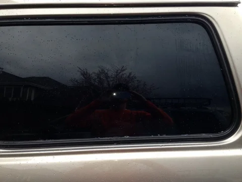

Should have been more specific. I was talking about the chrome strip on the door below the window. But looking at pics, might be something the 62s have. I will be messaging @reevesci for the WLS
Thanks, exactly what I was looking for. My list of parts keeps getting longer.
