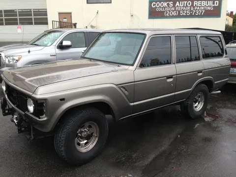

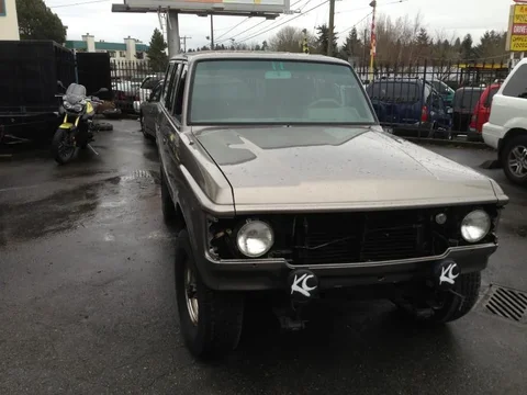

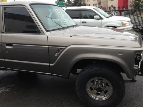

Ok, got her back from paint a week ago...finishing up putting all the bits back on (lights, etc) slow going as its tough to find time lately - works crazy. Hoping to be done on the exterior this week. Interior's going to take me a bit I think (want to try to make some new interior panels, new carpet). Here are some pix when I went to pick her up....too bad it was grey out and had rained a little. All chrome is gone too, the PC door handles look so good. Going to have to hit Kevin R. up for some WLS...glass guy refused to do it (afraid he'd break the glass or scratch the paint)...and the local guy I went to for the WLS said he couldn't get it...grr. :bang:
Came out better than I had hoped to be honest and I'm really happy with the new color...they did a great job. Had them weld shut the holes where that bottom chrome strip went. Will have to take a shot of the engine bay...looks too clean. I'm most happy that now I'm 100% sure there's no rust hiding on me...probably the biggest relief.

I took the Grigio Antares (Lambo color) and had them darken it 20% (basically they just doubled the black portion of the mix). Couldn't be happier with it, exactly what I was looking for....looks amazing in the sun. Now just cant wait to get her covered in dirt. :)

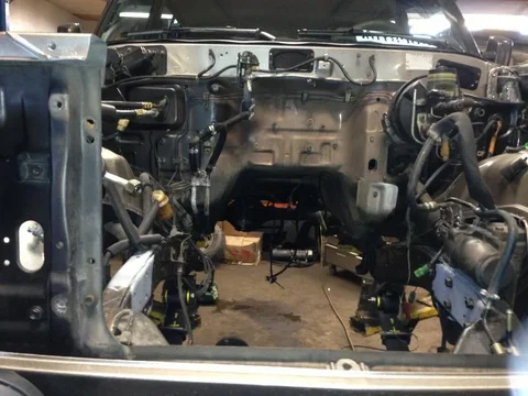

Dropped the Walrus off at Tor's last Friday. Stopped by today to check her out.
New OME going in. Definitely prefer paying to have this done this time vs when I did my FJ40 by myself. :)
Soon to be stuffed full of V8 awesomeness.

Did feel a little sad seeing the old engine sitting on the ground....but I'm sure I'll get over it as soon as I get to step on the skinny pedal.
Next update will probably come when she's done. Tor will also be putting the ARB bull bar and 4x4 Labs rear tire carrier on.

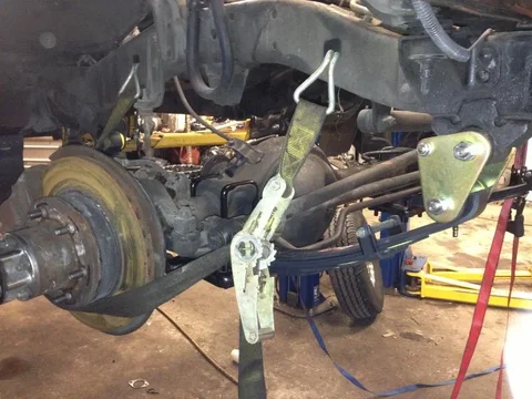

ratchet strap trick is the magic to get the axle / springs to move around and get bolts lined up..
