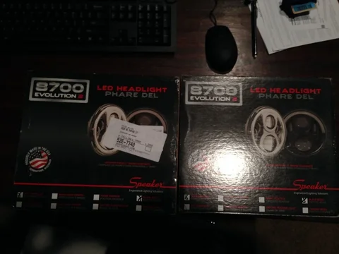

woop! Got another present today....can't wait to be able to actually see when driving at night.
You're going to like those a lot.
