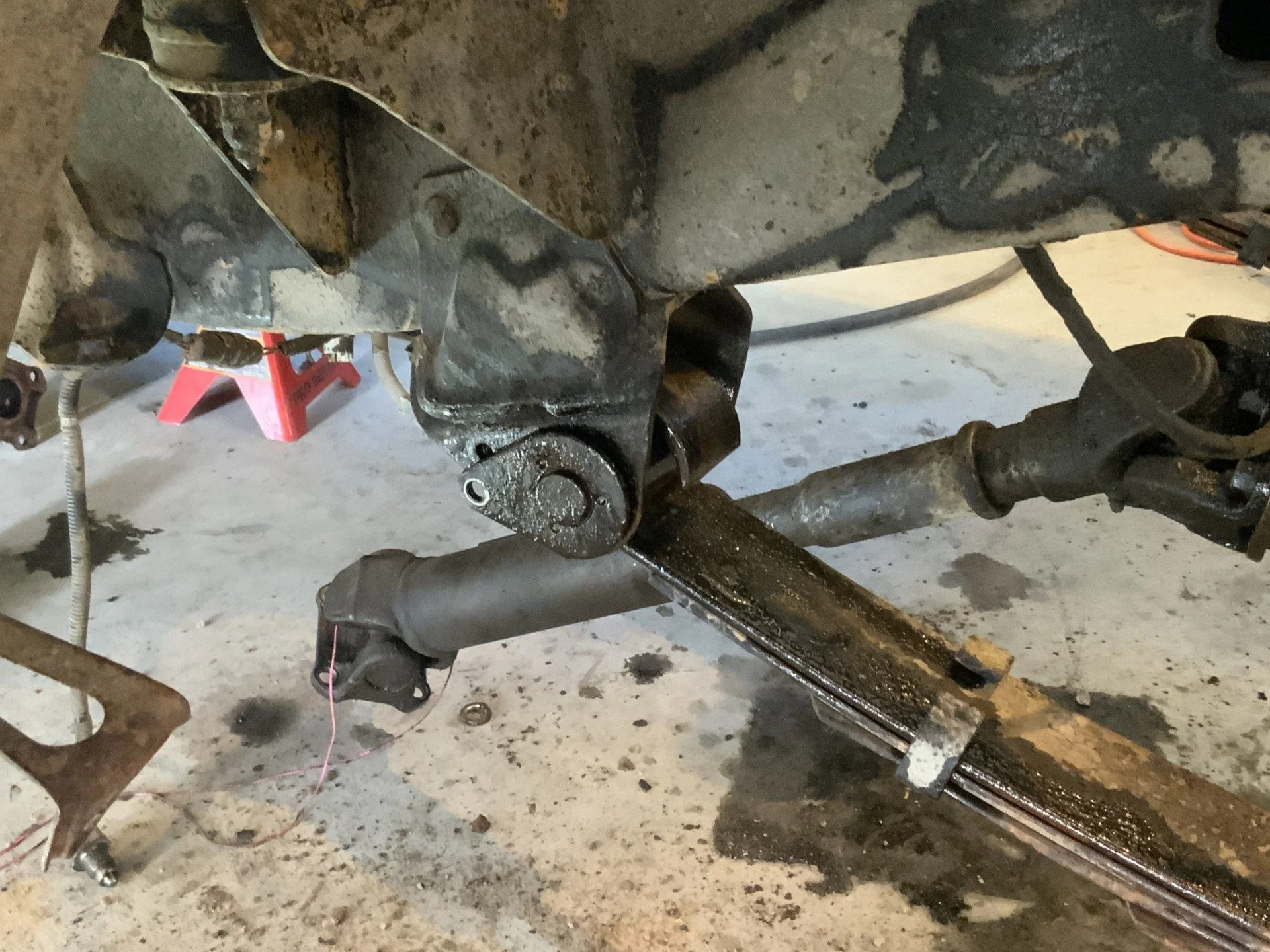

I’m removing my front leaf springs for a lift. Got the front bolts and shackles off easy but the rear bolt of the front spring won’t budge. I’ve removed the little retainer bolt on the wheel side and of course the inside nut. I’ve pounded on it with a mini sledge and it’s not moving out. It will rotate if
i Suggestions or tricks? Am I missing something?

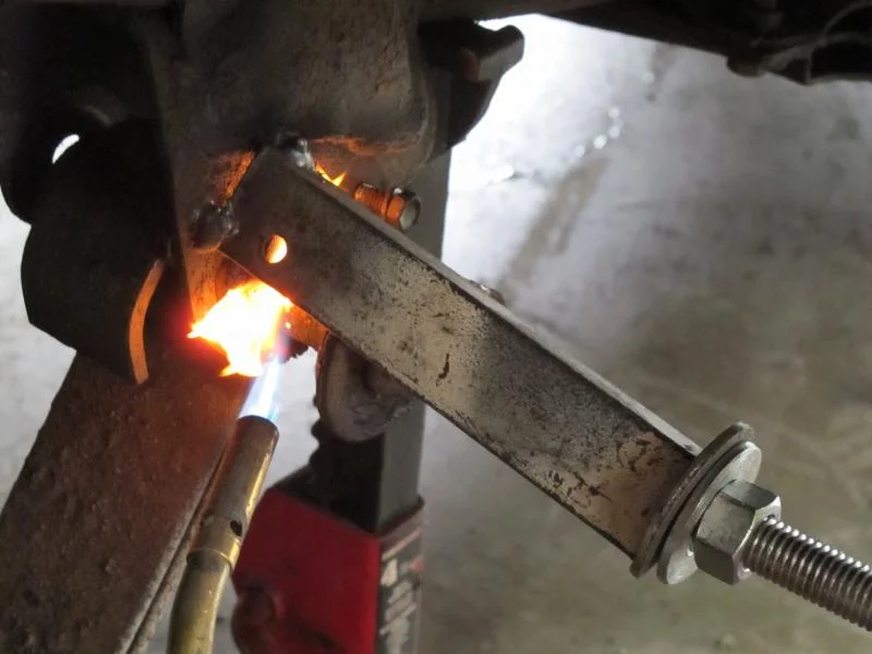

Sometimes you have to flame them out. Some have used a 'Puller' to press it out. The pin and the metal and the rubber kind of fuse into one lump. I had to flame all of mine out. Literally till the rubber was dripping molten blob.

I second burning them out with a torch.
heat is your friend, it will be smokey but once heated it will slide out with an air hammer, can't remember if there is enough room to use a port a power from the other frame rail??

Torch is disgusting. The melting and lighting up on fire doesn't help as far as I found. I cut like others had as well.
One of the more miserable jobs in the leaf spring truck world. The bolts like to seize in the metal collar that is bonded to the rubber bushing. The rubber then absorbs all of your impact force when you try to mechanical remove them. Sometimes you get lucky and can heat it up and then the rubber melts enough to drive them out. If the rubber catches on fire do your best to cool it down with water and don’t inhale. It’s noxious awful smoke that will give you double barrel cancer in two huffs.

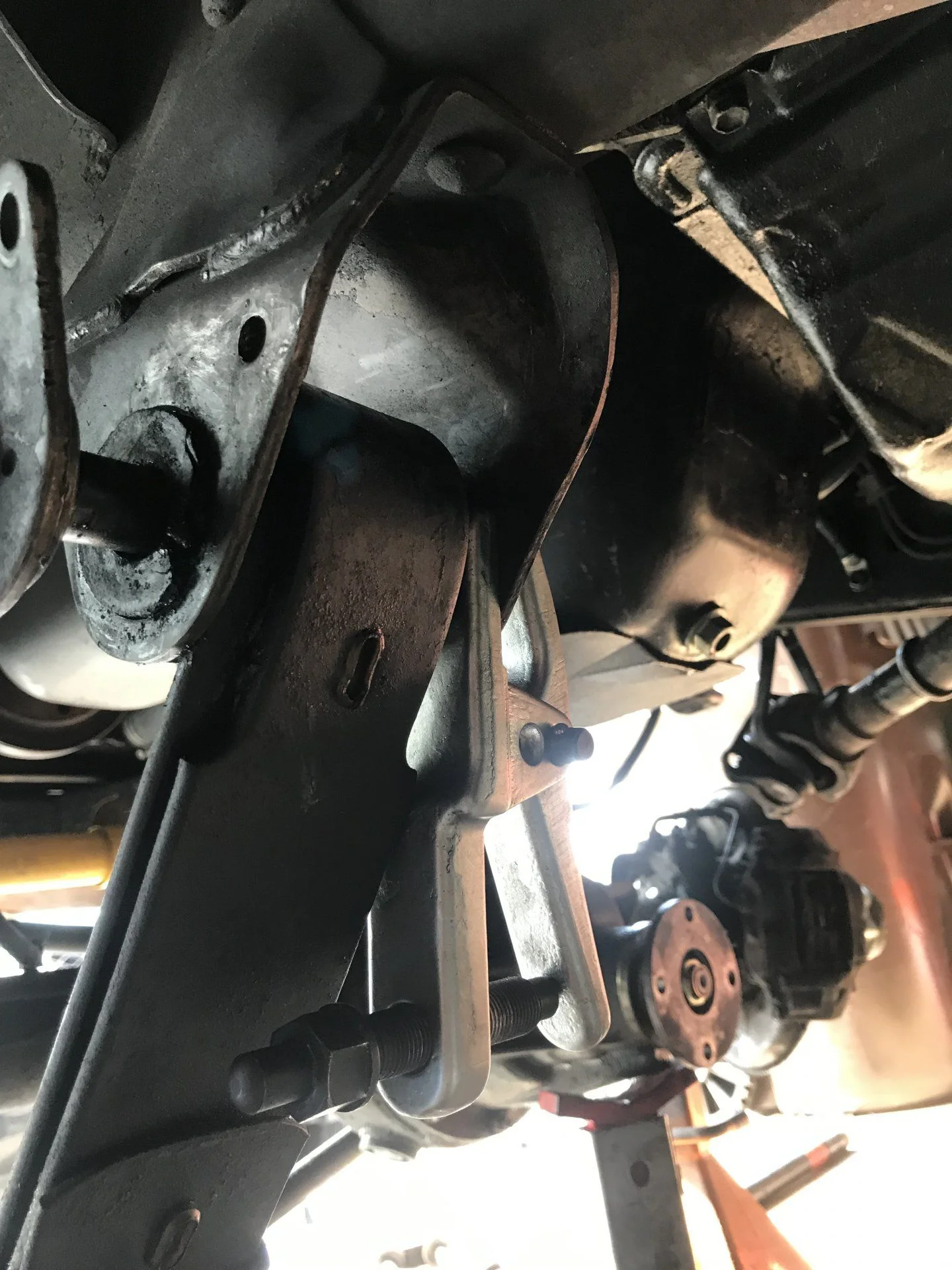

I used a tie rod tool for mine. This after banging on it for an hour with a sledge. Does nothing. Used the tie rod tool as far as it would go, then opened it up, got a smaller ID bolt and started pushing that through against the pin until the pin came out. Out in about 5 minutes, no torch needed and skipping the mess that goes with it:
I just did this and chose the saws all approach, get the proper carbide blade, I had my front two done in 20 min or so.
I have never seen a tie rod tool like that? What brand? Looks cool
