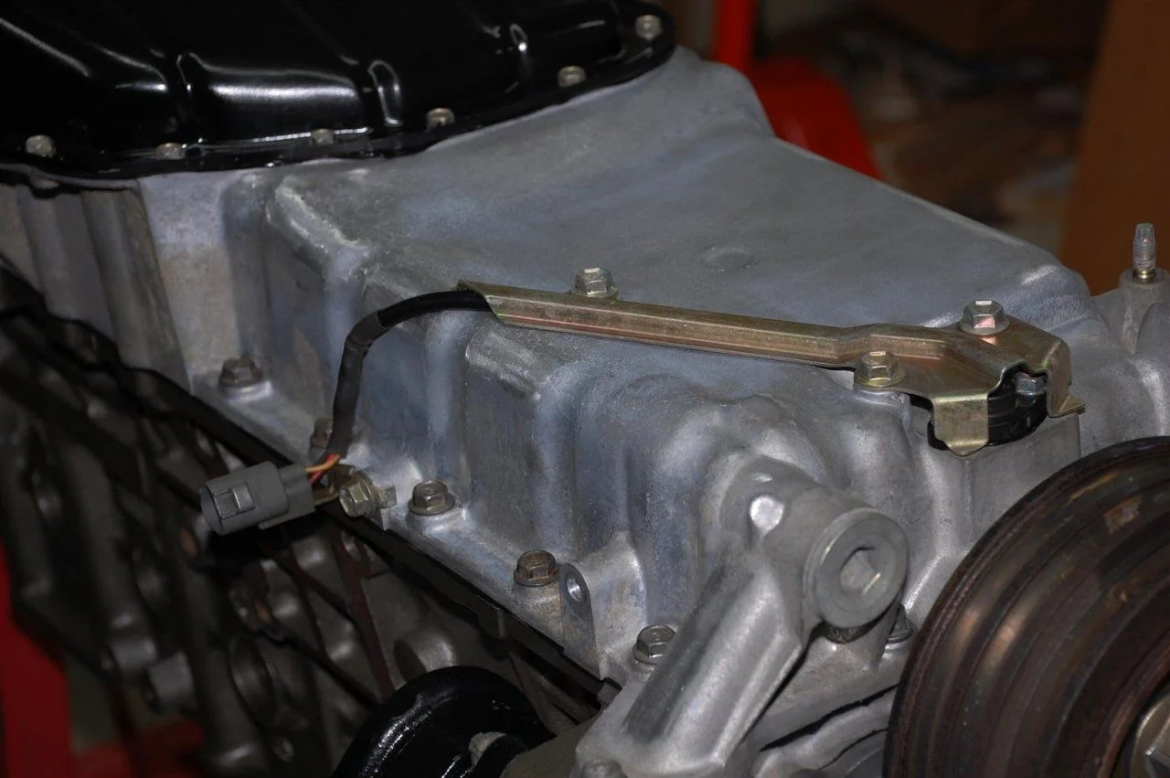

If the engine "bellied out" and came down on the crank position sensor or wiring, it might have damaged it.
There is no cam position sensor.
Look at the front edge of your oil pan. The wires are under a metal cover. Here's a pic of what it would look like with the engine upside-down.
