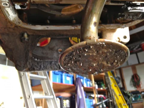

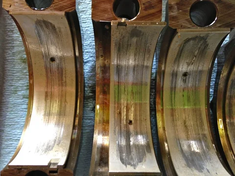

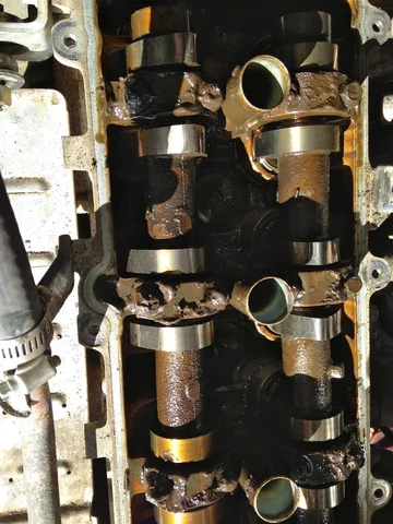

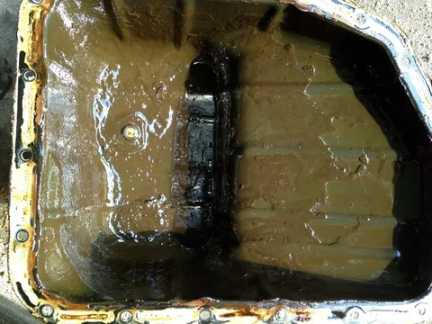

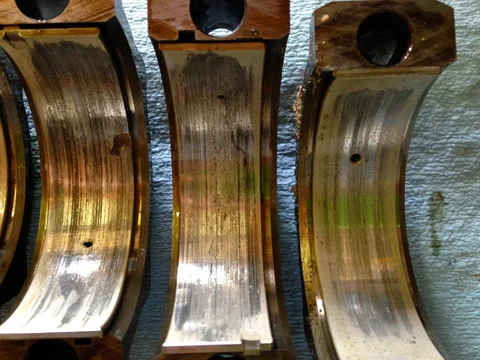

So, I took the valve cover and oil pan off, and have attached some pics. The valves are coated with what appears to be mud. The oil filler is coated, and it has about 30 miles on the oil change. In short, the motor is toast. I've put less than 10,000 miles on the truck since purchase, and it's been about 25,000 miles since over $5k was spent at ACC Toyota.
Went thru this with my 60. Purchased it and in the way home it died on me. $3500 later I drive home only a year later to have the motor explode.
20 years as a line tech and I've never seen anything exactly like it. My guess is PO neglected engine resulting in initial wear and sludge buildup. The sludge maybe combined with some old left over milkshake residue from the hg that blew not too far back. Or maybe the exotic molybdenum 10w-40 Ocho's mechanic back home put in it just before the trip started desolving the sludge. Combined with lots of hard work hauling the fam, lots of expo gear, a MOTORCYCLE!, cross country, over the Rockies...
I'm pretty confident this engine would not have held together for the whole 2000 mile trip back East.
...via IH8MUD app
Perhaps it blew the HG again? Was the oil milky?
The pics are of Ocho's original engine we just pulled. I don't think the contamination is from another blown hg. The sludge is not white, it's dark in color and the consistency isn't light and frothy it's heavy, like a gritty grease.
Unless I hear a better one, the hypothesis I'm going with is the motor was wearing out and packed with sludge before Ocho even buys it, his mechanic then introduces new "moly oil" that maybe has some detergents in it to keep the moly flowing, on the long trip the new oil starts to breakdown the sludge which begins to clog the oil passages and... see pics above
...via IH8MUD app
I think Shawn is correct. It's just hard for me to understand how that was missed when the prior owner redid the HG.
Either way, hopefully the next one is better. Thanks to Shawn and family. They have given my entire family a place to stay, a vehicle to drive, and a garage and help for the swap. It's truly remarkable.
