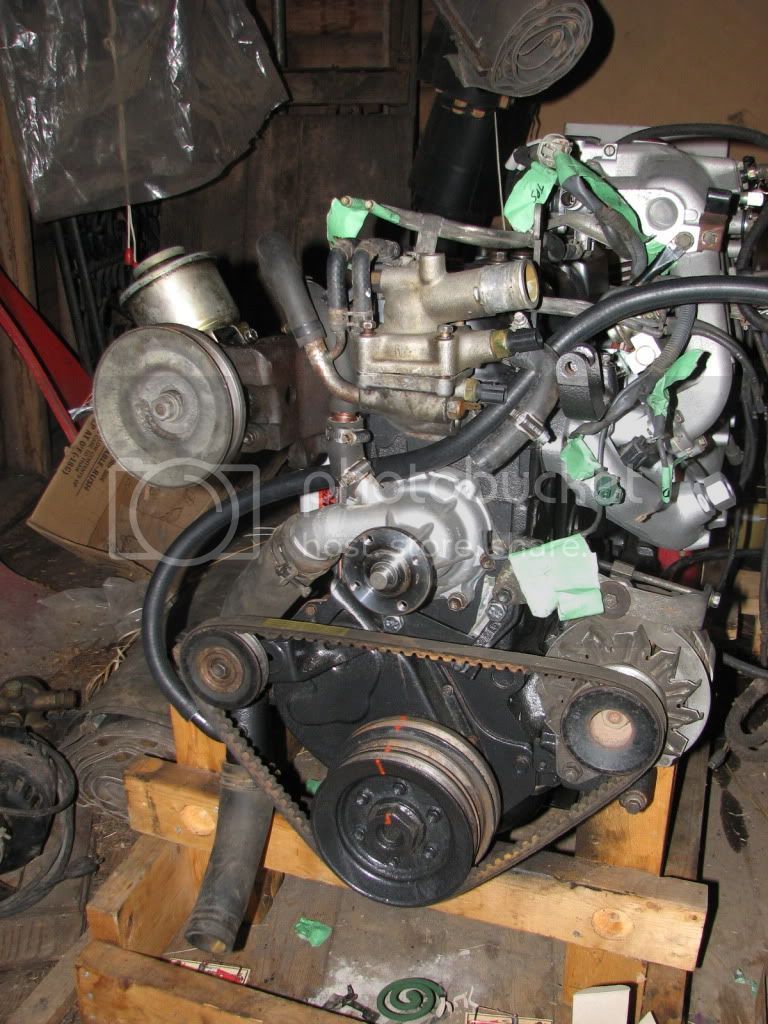

Found a proper 2F TEQ oil cap in the bottom of one of my parts boxes, so that's taken care of. We definitely have mosquitos and mice at the farm, without one of those coils going it would be pretty unbearable to mess around with the engine in the evenings after work.
Should be getting the oil in and the pump primed so I can drop in the dizzy in the next day or two. Need to put on the water pump pulley and fan clutch so I can measure out for the drive belts and pick them up next time I'm in town...... and start thinking more about the exhaust that's going to go behind this.
It's going in :)

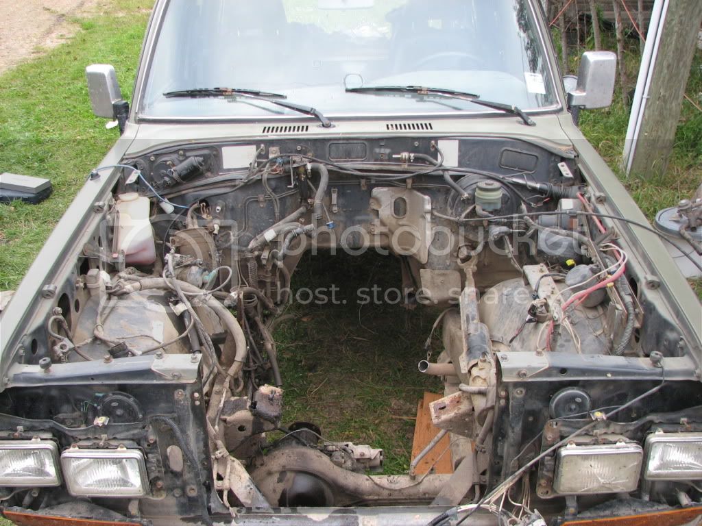

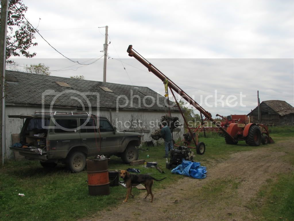

The 3FE is out with help from my dad. Ratpuke's gonna help tomorrow, so the tranny should be swapped over and it all plunked back in. Hopefully I'll have it fired up (with straight-pipes :hillbilly:) on Friday I hope.

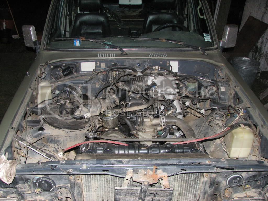

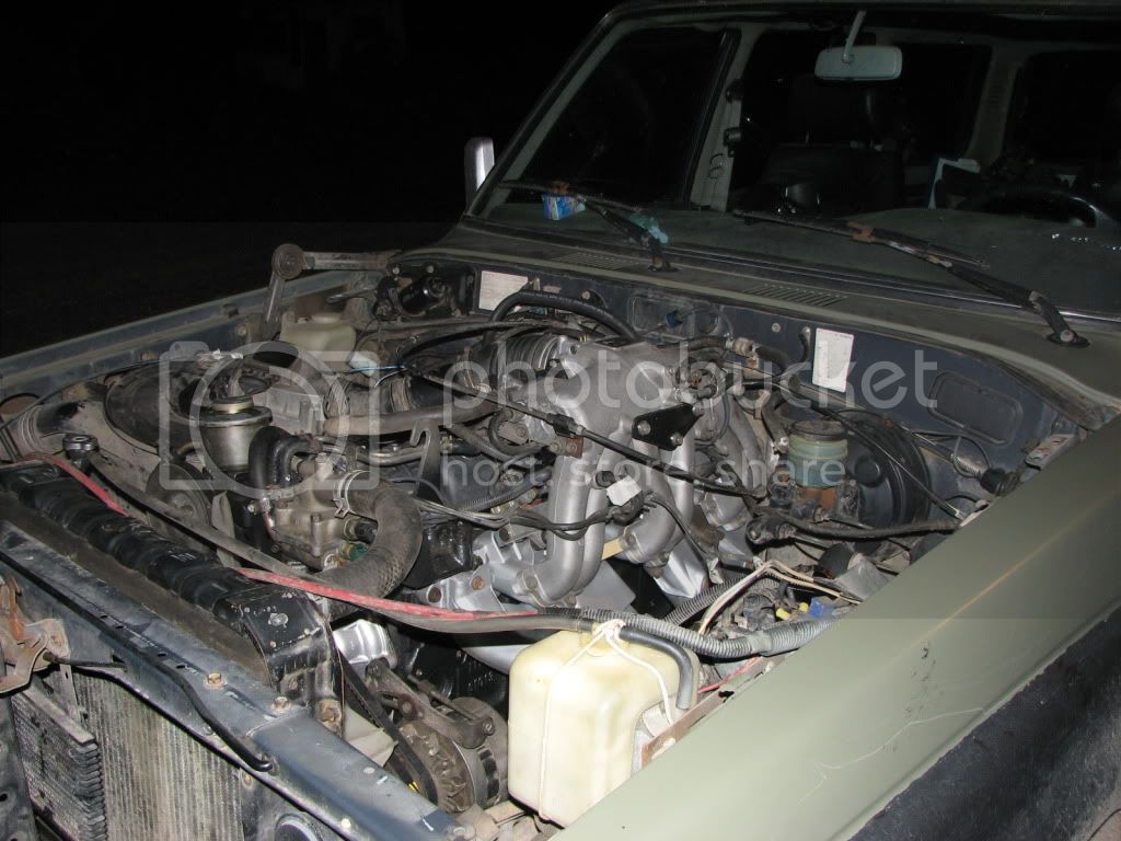

Well it's in, and mostly hooked up. Thursday was a rain day, yesterday was torque convertor install muck-up day, and today went well. Still need to plug in the ECU, jerry rig the O2 sensors (till I get the exhaust done proper) and fill all the fluids, then I can fire it up and see if it'll run :) Should hear it roar tomorrow.
Did you really use a grain elevator as an engine hoist?
If so, that is some great improvising.

Yup, we used the auger. Worked great except for the one time I was repositioning it with the tractor and one of the chains from the hoist caught on an exhaust manifold shield. :doh: When we dropped the assembly in, we rolled the truck forward under the hoist, since reverse in the Case wouldn't be slow enough to finesse it.

Yup, it's on the road, and so far it seems good and strong. Need to get some exhaust work done and put on some more miles before I can really put it through it's paces, but with about 15 miles on it the 0-100 km/h time was ~16 sec (vs. 19.3 with the 3FE). I take that as a 20% boost in power at the rear wheels, and it certainly isn't broken in yet. :cool: It seems to have much the same powerband as the 3FE, coming on strong at ~2500 and building up through 3500 anyway. Can't wait to put the boots to it once all has seated well and the exhaust is sealed. :)
