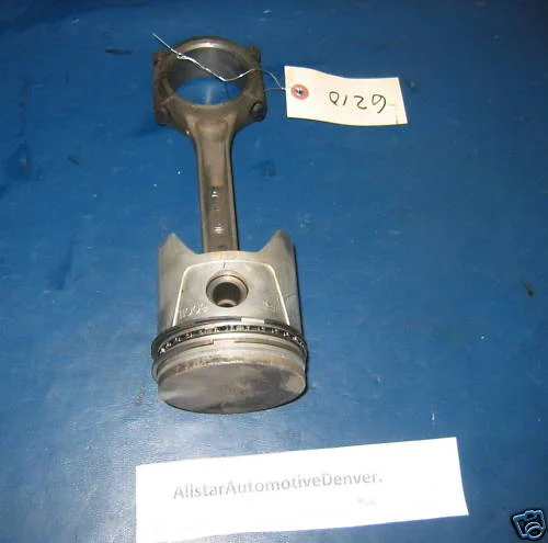

Just in: I found this on ebay, TOYOTA 4.2 LAND CRUISER ENGINE ROD & PISTON ASSY. #6210 - eBay (item 160385714870 end time Dec-03-10 13:35:37 PST) But the listing says it fits only '75 - '80 model years. I dunno, that piston looks pretty flat-topped to me. Looks more like post-'80. Can anyone tell from the pic?

If you look back at post #63, you'll see the pistons that came out of my '83. They are definitely different that the one you have pictured there. That connecting rod doesn't look like it is the later "stamped" version either.
