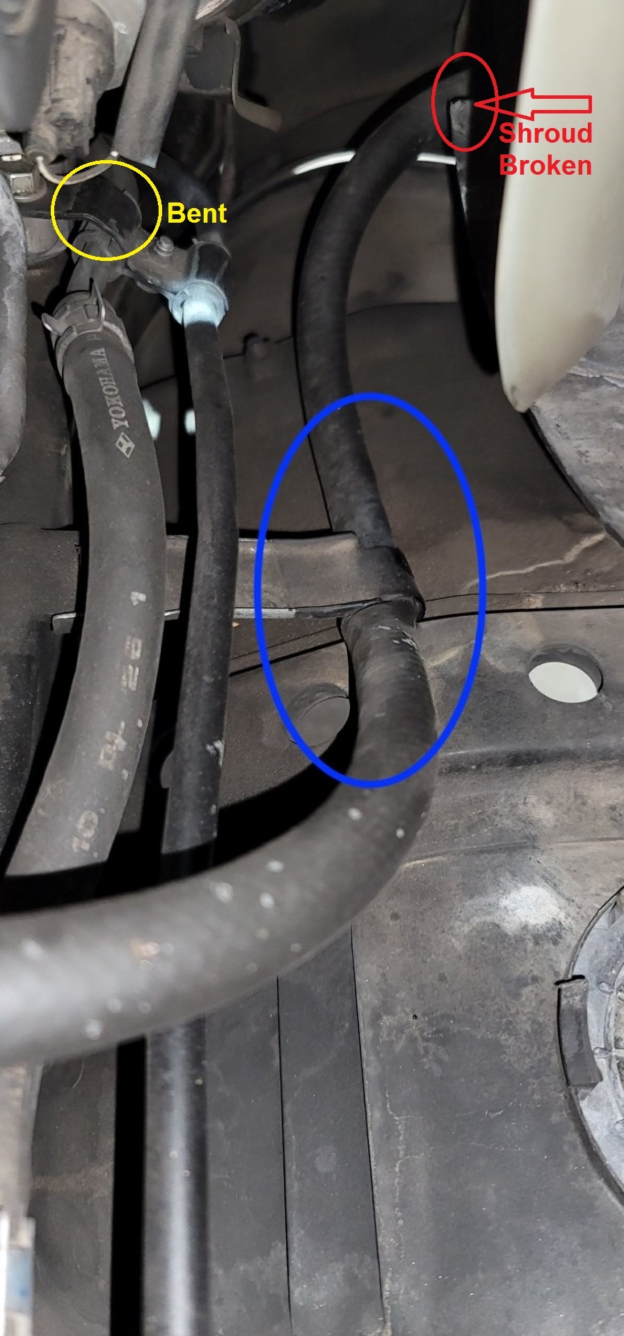

UPDATE: Dropped the LX at Lexus Carlsbad (since I should be able to get this compensated from the original Henderson dealer) and they discovered that this kinked transmission line upon first inspection. More news to come once it it replaced early next week. Fingers crossed 🤞🏼.

Interesting, that transmission cooler line bracket is upside down. Got to wonder why someone had it off. Any history or sign(s) of front end damage.

There are no obvious signs of front end damage but it does make me wonder why it was ever touched in first place. 🤔 I’ll bring both of those items up, thanks again fir sharing. Is that a fan shroud you are referring to? Really appreciate this.
Wow thanks for the great reply @2001LC !
Yes fan shroud appears busted. But hard to see in pictures.

Conclusion: The pinched cooling line was the issue. After fixing this, AT Oil Temp is running perfectly. So far I can't get it above 162, which was doing a hard fast climb up winding mountain hills on a hot day. Daily driving is like 120-135/140 depending on the conditions. I will continue to test and monitor with my scangauge II + laser temp scanner.
Lexus of Carlsbad identified and fixed the issue right away. Big props to them.
