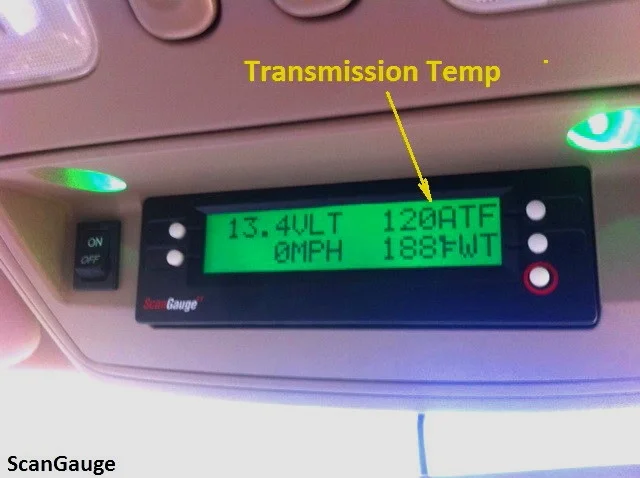

I've compared oil pan temps (using an IR gun) with the readout on my ScanGauge and they have always been within a degree or two of one another. On my 80 series I have a temp probe in the transmission pan and digital readout gauge. Again...using an IR gun, the two temps agree.
So....IF your temp gun is reasonably accurate....its fair to assume the temps you are seeing are indeed that high.
The temps you cite are high enough to be of serious concern. It is unbelievable to me that any shop would send you on your way with 275°F fluid temps. That is absolutely reckless on their part.
Both transmissions in my vehicles (A343F) (97 land cruiser, 99 LX470) run between 142-165°F in the heat of a Texas Summer.

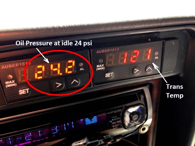

Thanks a lot for the feedback and details. Shoot, this is seeming like the consensus.
100 Series:
80 Series:

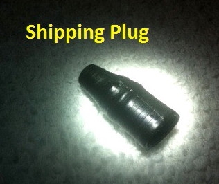

Have someone check for blockage in the lines going to and from the Oil Cooler.
At one time my trans suddenly showed higher than normal temps (got over 160°F) and an investigation of that turned up no flow through the oil cooler.
When I dropped one of the lines going to the radiator portion (not the grill mounted cooler) I found what looked to be a shipping plug of some sort.
It just happened to be the exact size of the rubber line. Somehow it managed to turn just right and get in the line and block it.
Using an IR temp gun on the lines and external cooler will tell you in a hurry if there is blockage. Heck...just feeling the lines by hand would as well.
