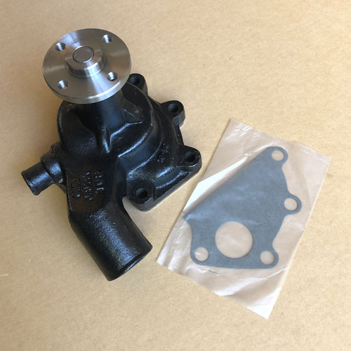

There is a difference, but it's only related to a slight difference in the lower hose connection. The '68-'74 works on earlier models, just fine.
Can the difference be overcome with some tweaking of the hose?
Stumbled across this one and posting for posterity. Currently $56!
To make that water pump work you will need both lower hoses, and the pipe that has the heater return.
